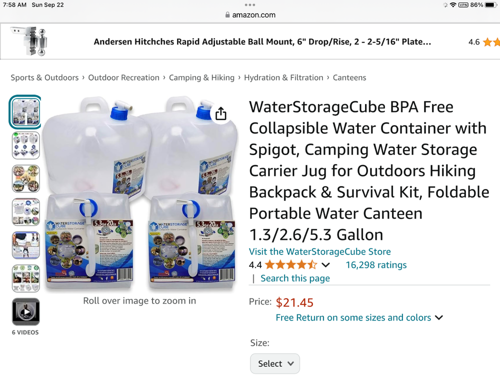

This is a great idea, but with no room to haul a bucket we carry collapsible water containers and a dedicated hose to draw water into the tank; stow under the street side bed behind the stabilizer jack assembly.

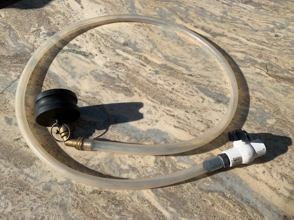

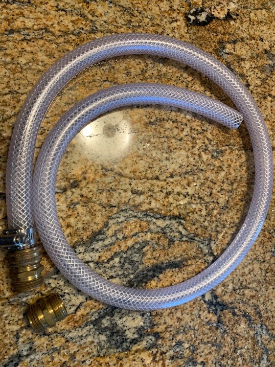

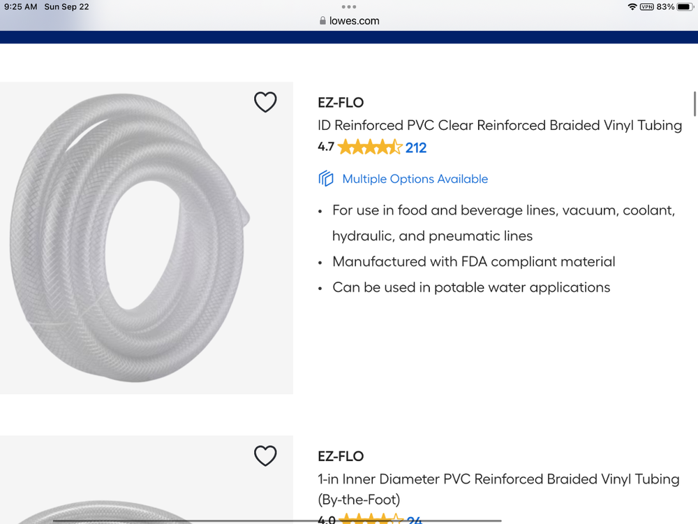

My bad, the silicone hose is used as a gray water discharge on the cam lock end of the rear tank dump outlet. A 4’ length of clear PVC reinforced braided hose with a garden hose barb fitting is used for the water draw, silicone would collapse. Both PVC hose and fitting were from Lowe’s, silicone hose an Amazon purchase.
PVC hose:
Silicone hose:

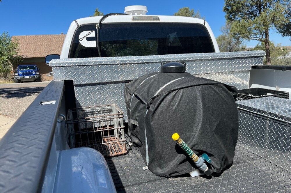

Good in a pinch but not enough volume for us. We have one of the old hulls where OTT messed up the FWT installation. The suction hose only reaches to the half-point level of the tank. We consistently get only 18 gallons from our FWT when the water pump starts gurgling! Oliver offers the repair and too bad visits by prior owners in 2018 and 2020 to Hohenwald and nobody thought to fix this! We may get there one day, but in the meantime...
With our TSC 35-gal potable water tank we can refill the FWT twice, so we get about 54 gallons total after a fill. When TV and TT are hitched, I use the 25 FT hose and 10 FT hose we travel with to make the connection. Took a call to Norwesco to order the hoop mounts: Norwesco 35 gal. Horizontal Leg Tank at Tractor Supply Co.
I custom fit a cover to keep the sun off the tank and water: Amazon.com : Dokon Heavy Duty Patio Ottoman Covers Waterproof Outdoor Ottoman Cover Anti-UV Patio Side Table Cover, Patio Furniture Covers with Air Vent, Rectangle (28"L x 22"W x 17"H) - Black : Patio, Lawn & Garden
Boondocking with 54 gallons of fresh water, we can last over a week or until the black tank is full.
