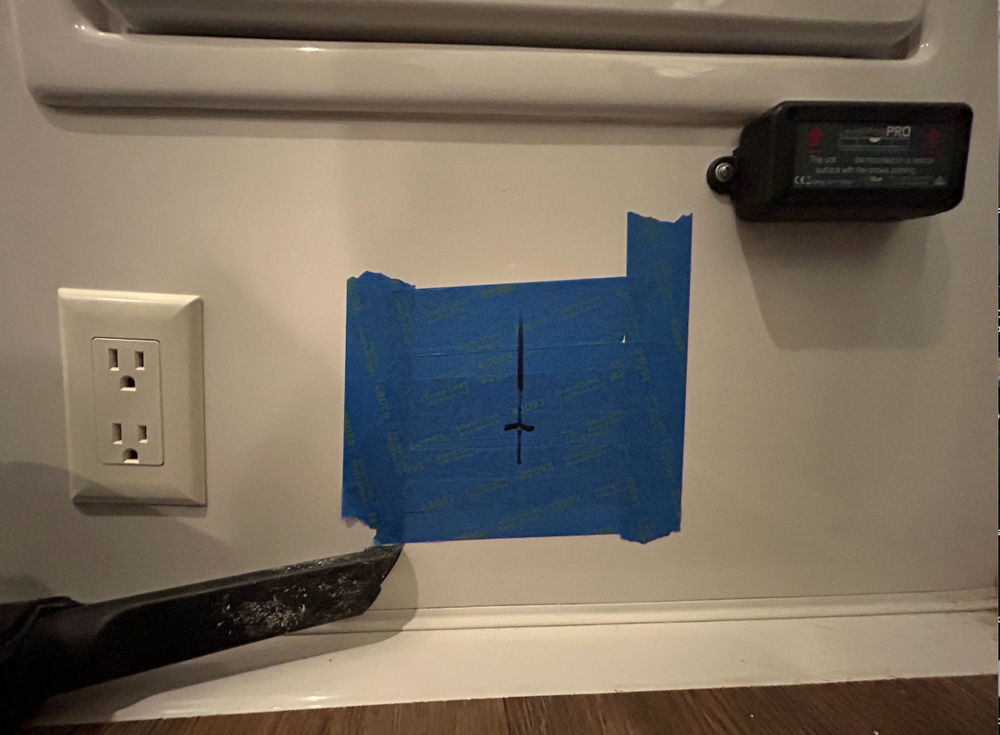

Started this project by installing the first of 3 return vents in the closet door bulkhead just below the jam:
ABOVE: Measured the height above the floor of the furnace outputs (4.25") so this return vent would match.

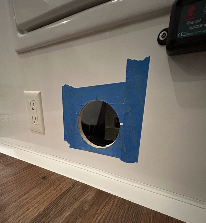

ABOVE:  Cut the bulkhead with the trusty 4" hole-saw.

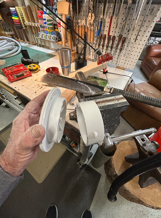

ABOVE: Used the thickness of the cut-off to trim back the excess material on the stock Valterra vent

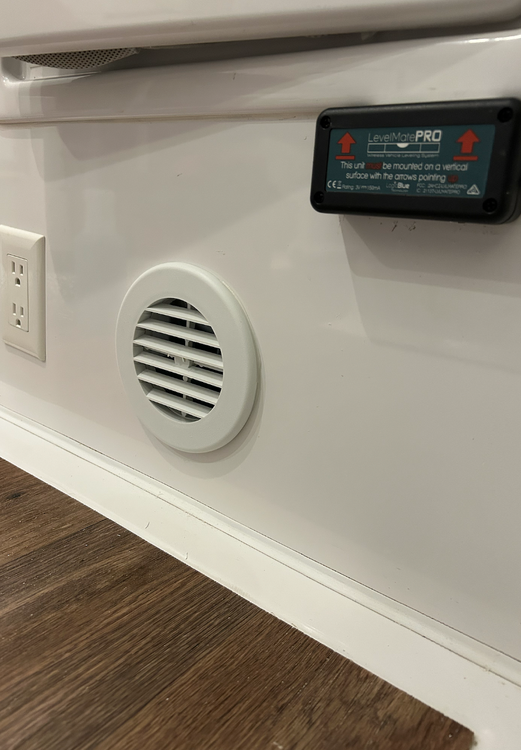

ABOVE:  Used a bead of clear silicon to secure return vent to gelcoat.

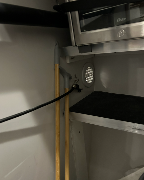

Next, installed a second return vent between the closet and under the sink:
ABOVE: View from under the sink
ABOVE: View from inside the closet.  Placed the return vent between the two lower shelves.
