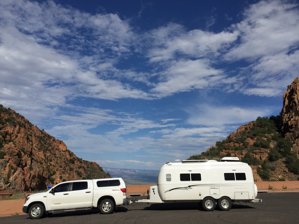

All I can say about this is that we have towed thousands of miles now with our 2013 5.7 4X4 Tundra without the Andersen, and without swearing (at least about the truck, trailer, or hitch). I did install the Hayes Sway Master, not because we had any issue with sway but as an additional safety measure. (It engaged once when I had to swerve to avoid hitting a teenager swerving into my lane while texting, and I was glad it did.)
In addition to feeling stable, as far as sway is concerned, the Tundra always feels up to the task power-wise: I've been able to accelerate quickly when needed, pulled Ollie up some steep, unpaved hills using the 4x4 function, etc. When people ask how our Oliver tows, I say "Like a dream." Compared to other RV rigs out there, I feel like we are the luxury sports-car rig on the road. I haven't towed with anything else, so I can't compare towing experiences, but I certainly don't feel that the Tundra's capabilities are "marginal."
