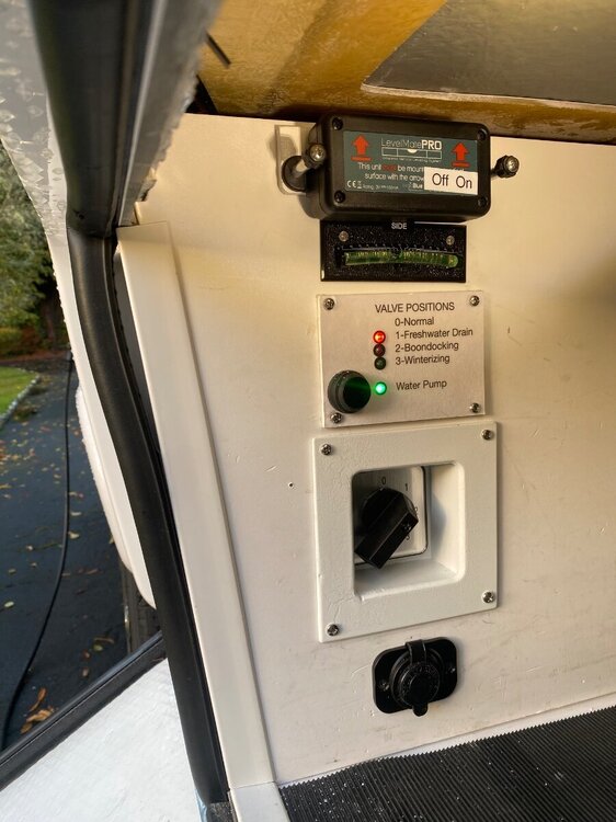

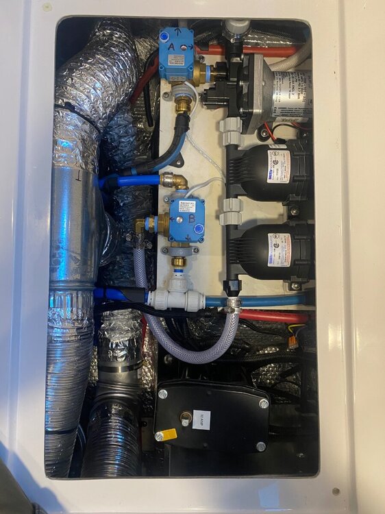

jd1923 Posted March 2 Author Posted March 2 (edited) 22 minutes ago, Galileo said: Last winter I mistakenly configured the valves to “Boondocking” when really wanted “winterize”. I wondered where a gallon of RV antifreeze went before I figured it out…. For me, I don’t change those valves often enough to want to motorize them - even if it is a royal pain in the butt to lift up the access panel, anti-condensation may, seat cushion, and 3” mattress topper (king bed) to get to the valves. Gross, all that pink stuff in your FWT! Not easy to rinse without half filling and dumping it a few times. I only use air as a winterizing agent! 🤣 We travel with an extra 35-Gal FWT in our truck bed, using the Boondocking valves all the time! We can be off-grid for ten+ days when needed, given we can let a little gray water out in the back country. Turning two switches sure beats lifting a 10” mattress! The third switch empties the FWT. The picture also shows the heater duct delete and the added air intake filter housing. Edited March 2 by jd1923 Added pic 1 1 Chris & John in Prescott, AZ | 2016 EII #113 | '01 Ram 2500 Cummins!
Snackchaser Posted March 2 Posted March 2 39 minutes ago, Galileo said: Just half yanking your chain… I just ask because having to look at a diagram and then (properly!) position four valves has tripped me up before. Oh okay. Thought you were messing with me because I have posted several automation projects. Take a look at my post “Electric valve control... with a twist” where I installed motorized valves all connected to a single selector switch. It takes the error out of valve line-ups and it was a fun project. We don’t winterize, but we often use the boondocking position, and we usually drain and re-fill freshwater after every trip. I just hated lifting our oversized mattress too! I don’t think anyone has copied that modification yet because there were no comments about one of the 3-way valves being backwards. I really should update that photo with the corrected valve orientation 🤔 2 1
Galileo Posted March 2 Posted March 2 2 hours ago, Snackchaser said: Oh okay. Thought you were messing with me because I have posted several automation projects. Take a look at my post “Electric valve control... with a twist” where I installed motorized valves all connected to a single selector switch. It takes the error out of valve line-ups and it was a fun project. We don’t winterize, but we often use the boondocking position, and we usually drain and re-fill freshwater after every trip. I just hated lifting our oversized mattress too! I don’t think anyone has copied that modification yet because there were no comments about one of the 3-way valves being backwards. I really should update that photo with the corrected valve orientation 🤔 Damn! You really DID automate it! Very cool - definitely above my “desire” level. I see you have the Levelmate Pro. We added one our second trip out. I don’t find that the circular bubble level on the top of the tongue jack to be very accurate or have enough resolution. I like that IF I remember to plug mine into the USB power (I removed the battery entirely) that I can get leveled side-to-side without having to getting and out of the truck sux times. It tells me how low a given side is, I position the right number of stackable blocks, and drive onto them. I can verify it’s laterally level, shut down, chock and unhook. Easy! (I even have the Levelmate app on my Apple Watch!) 1 2022 Oliver Legacy Elite II Hull #1029 King Bed Floorplan electronics package Truma Aqua-Go LOUD Dometic Penguin A/C LevelMate Pro+ Valterra Electric Black Tank Dump Valve TV - 2025 GMC Sierra 1500 Denali, 3.0l Duramax Diesel, Crew Cab 4WD RealTruck hard tonneau cover Rove R2-4K DashCams Canada: New Brunswick, Nova Scotia, Prince Edward Island

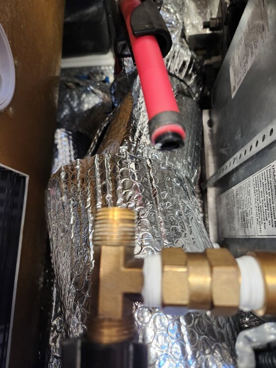

TimD Posted September 1 Posted September 1 We have had a significant water leak on our current stay in central NJ. After connecting to city water and finally sitting down after a long day we noticed a stream coming from the rear street side scupper. After some investigation we discovered that a plastic PEX-to-female NPT fitting had cracked and broken clean off. The fitting is located at the HW heater outlet and is subject to full (regulated) city water pressure. Needless to say this was like spraying a small garden hose into the engineering space, not good. We've succeeded in drying things out but we will add fans and dehumidifiers back at home. A bit of a scramble later I'd replaced the failed part with a brass fitting sourced from a (fortunately) nearby and very posh Airstream dealer. As it was 4:45 PM on Labor Day Saturday they were very quick to help me and see me out. IMO this part is a failure risk and should be proactively replaced. We aren't sure why it failed other than fatigue. In the pic the NPT part of the broken fitting is not shown. Hope this helps Tim 1 2 2021 LE2, hull 701
Galway Girl Posted September 1 Posted September 1 1 hour ago, TimD said: IMO this part is a failure risk and should be proactively replaced. Ours broke after a rough dirt road in the Yukon. We happened to carry new brass shark bite fittings for that location. Trimmed it up and we're all fixed up in 15 minutes. I now carry an assortment of fittings and some short lengths of pex in the trailer. 2 2019 Elite II (Hull 505 - Galway Girl - August 7, 2019 Delivery) Tow Vehicle: 2021 F350 King Ranch, FX4, MaxTow Package, 10 Speed, 3.55 Rear Axle Batteries Upgrade: Dual 315GTX Lithionics Lithiums - 630AH Total Inverter/Charger: Xantrex 2000Pro Travel BLOG: https://4-ever-hitched.com Lower 48 + Alaska Achieved in Maine Aug 2024 on way to Nova Scotia.
Moderators Mike and Carol Posted September 1 Moderators Posted September 1 1 hour ago, TimD said: IMO this part is a failure risk and should be proactively replaced. We aren't sure why it failed other than fatigue. In the pic the NPT part of the broken fitting is not shown. I agree 100%. I had the same part fail, not a clean break but it cracked resulting in a steady drip of water. I also replaced the cracked part with a brass fitting. It would have sheered off soon, just like yours did. Mike 1 Texas Hill Country | 2016 Elite II #135 | 2020 Ram 2500 6.7L Cummins
Moderator+ ScubaRx Posted September 2 Moderator+ Posted September 2 (edited) On 3/2/2025 at 2:49 PM, Snackchaser said: I don’t think anyone has copied that modification yet because there were no comments about one of the 3-way valves being backwards. I really should update that photo with the corrected valve orientation 🤔 I did this modification to The Outlaw Oliver, Hull #050 in March of 2017 after spending a month in the desert near Quartzsite, AZ. I got real tired of having to manually move those valves. Edited September 2 by ScubaRx 4 Steve, Tali and our dog Rocky plus our beloved dogs Storm, Lucy, Maggie and Reacher (all waiting at the Rainbow Bridge) 2008 Legacy Elite I - Outlaw Oliver, Hull #026 | 2014 Legacy Elite II - Outlaw Oliver, Hull #050 | 2022 Silverado High Country 3500HD SRW Diesel 4x4
