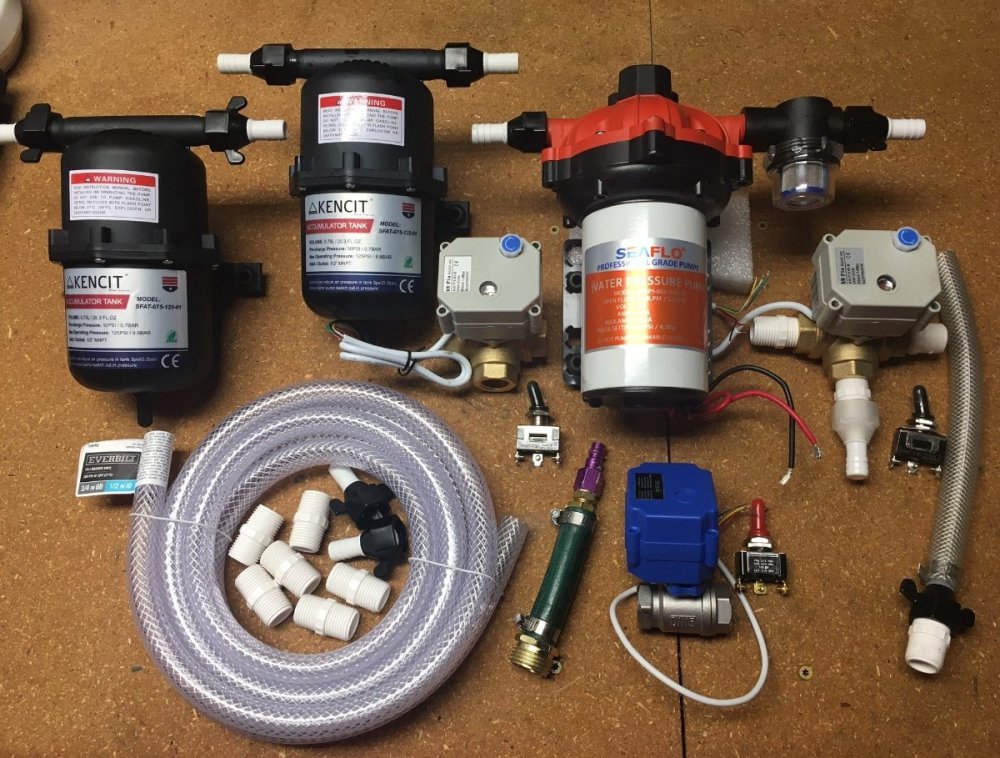

jd1923 Posted November 18, 2023 Posted November 18, 2023 (edited) Been thinking about this for a while, reading posts, and collecting parts. So, this is what I'm thinking (see pic). The OEM water pump is a basic model, at 55 PSI (not bad) and 3 GPM (pretty bad). I had the same model in our sold Bigfoot class-C, which I replaced as well. Now I will have 2 basic back-up water pumps! Those of you with newer models have an accumulator, older hulls did not. When done, we will NEVER lift a mattress to switch a water valve. Some who know me, know that I already have a 35-gallon water tank mounted to my truck. We love our water out here, in the SW, where it is scarce! I will increase the PSI a little to 60 and add volume 5 GPM (huge), also addind dual .75L water accumulators. Some may get worried re manufacturer specs, although design tolerances have considerable room, often up to 50%. I will add 9% more PSI and PEX is rated to 160 PSI (although not all the fittings are). We run our home at 60 PSI water pressure. Take a look! Please let me know what you think. I'm tearing old parts out asap tomorrow! 😋 Edited January 5, 2024 by jd1923 Removed "Accumulator" from title. 2 Chris & John in Prescott, AZ | 2016 EII #113 | '01 Ram 2500 Cummins!
Ronbrink Posted November 18, 2023 Posted November 18, 2023 9 hours ago, jd1923 said: Take a look! Please let me know what you think. Seems like a good plan, really like the power flow control switches. I assume you will be using clamps on the hose barb fittings. 1 Ron and Brooxie | Clear Lake (Houston), Texas 2020 OLEll, Twin, 579: No installed solar, Renogy 40A DC-DC charger, 460Ah LFP battery bank/Victron SmartShunt, auxiliary Cerbo-S GX/Victron 30A Blue Smart IP22 Charger combo, Hughes Autoformer, dual Lagun tables, extended dinette table and pantry landing, tongue-mounted hoist, Beech Lane refrigerator Ventilation/Evaporate Coil fans, Dreiha Atmos 4.4 A/C upgrade. 2019 GMC Savana 2500 Cargo Work Van: Explorer Limited SE, Low-Top 7 Passenger van conversion, 6.0L V8 Vortec, 6-Speed Automatic, RWD; Air-Lift LoadLifter air suspension/WirelessAir compressor; Buyers Products cargo containment boxes/DC Cargo securement system; rear bumper DC-DC power cable outlet; 100Ah 12V portable power station/Dometic CFX 75L Dual Zone Refrigerator and Freezer; pending transfer of Mechman 320A high output alternator from former TV.
Moderators topgun2 Posted November 18, 2023 Moderators Posted November 18, 2023 Good luck. I assume that you are going to need a new/additional mounting board for the second accumulator. I managed to squeeze my one accumulator onto that same board that Oliver used to mount the water pump but there certainly wasn't enough room for two. Bill 1 2023 Ford F150 Lariat 3.5EB FX4 Max Towing, Max Payload, 2016 Oliver Elite II - Hull #117 "Twist" Near Asheville, NC
Moderator+ ScubaRx Posted November 18, 2023 Moderator+ Posted November 18, 2023 16 hours ago, jd1923 said: Been thinking about this for a while, reading posts, and collecting parts. So, this is what I'm thinking (see pic). The OEM water pump is a basic model, at 55 PSI (not bad) and 3 GPM (pretty bad). I had the same model in our sold Bigfoot class-C, which I replaced as well. Now I will have 2 basic back-up water pumps! Those of you with newer models have an accumulator, older hulls did not. When done, we will NEVER lift a mattress to switch a water valve. Some who know me, know that I already have a 35-gallon water tank mounted to my truck. We love our water out here, in the SW, where it is scarce! I will increase the PSI a little to 60 and add volume 5 GPM (huge), also addind dual .75L water accumulators. Some may get worried re manufacturer specs, although design tolerances have considerable room, often up to 50%. I will add 9% more PSI and PEX is rated to 160 PSI (although not all the fittings are). We run our home at 60 PSI water pressure. Take a look! Please let me know what you think. I'm tearing old parts out asap tomorrow! 😋 I changed my valves over to electric about 6 years ago because of the difficulty of changing them from Normal flow to Aux Fill. You can vastly simplify that aspect of your project by using two of the 3-way valves and only one DPDT (wired for reversing) switch. Steve, Tali and our dog Rocky plus our beloved dogs Storm, Lucy, Maggie and Reacher (all waiting at the Rainbow Bridge) 2008 Legacy Elite I - Outlaw Oliver, Hull #026 | 2014 Legacy Elite II - Outlaw Oliver, Hull #050 | 2022 Silverado High Country 3500HD SRW Diesel 4x4
jd1923 Posted November 18, 2023 Author Posted November 18, 2023 22 minutes ago, ScubaRx said: I changed my valves over to electric about 6 years ago because of the difficulty of changing them from Normal flow to Aux Fill. You can vastly simplify that aspect of your project by using two of the 3-way valves and only one DPDT (wired for reversing) switch. First, I thought I would need only one DPDT switch. Though I purchased a set of 3 anyway. I also purchased one SPDT switch to activate the simple open/close ball valve for the fresh tank drain. There are Three (3) water valve configurations, the normal setting to 1) pump from the fresh tank, 2) the winterizing setting to bypass the fresh tank and push to faucets, and 3) the boondocking setting to draw water from an auxiliary tank to the fresh tank. I'm thinking I would need to wire 2 DPDT switches to switch each 3-way ball valve independently, to work all three combinations. Steve, perhaps you do not use the winterizing combination? Am I thinking this correctly? I will not add RV antifreeze ever, instead will blow out the lines with air, even though OTT does not recommend this practice in their video. I will however use the winterization mode to descale lines and faucets with vinegar and sterilize lines with bleach (not at the same time of course). Chris & John in Prescott, AZ | 2016 EII #113 | '01 Ram 2500 Cummins!

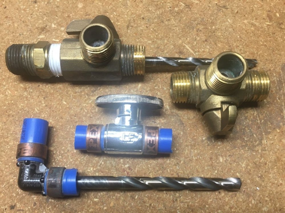

jd1923 Posted November 19, 2023 Author Posted November 19, 2023 Still want a reply from @ScubaRx on the electrical switches... Made some headway today. Anybody, yes ANYBODY who has an older Oliver with these 3-way brass water valves MUST change out these valves, even if you do not want to motorize or upgrade! I cannot believe OTT installed these valves! The opening in only 1/4" WT*! See pic, this is crazy! What were they thinking? The OEM water pump is 3 GPM. I measured water flow at the kitchen sink and the shower, cold side came in at 48 seconds to fill a gallon container. That's 1.25 GPM down from 3 at the pump due to multiple restrictions along the path! OMG! 🤣 1 2 Chris & John in Prescott, AZ | 2016 EII #113 | '01 Ram 2500 Cummins!
Hokieman Posted November 19, 2023 Posted November 19, 2023 2 hours ago, jd1923 said: I cannot believe OTT installed these valves! The opening in only 1/4" WT*! Thanks for pointing this out! In my recent repairs on my water heater I did not remove this valve, so didn’t know. I will be going back in and replacing with higher flow valves. 1 “Ramble” - 2021 Legacy Elite II #797; 2020 Ford F-250
jd1923 Posted November 19, 2023 Author Posted November 19, 2023 12 hours ago, Hokieman said: Thanks for pointing this out! In my recent repairs on my water heater, I did not remove this valve, so didn’t know. I will be going back in and replacing with higher flow valves. Given hulls 113 and 797 have these, from 2016 to 2021, that's a lot of Olivers. Later they went to dual inline valves to achieve 3-way functionality. Having these restrictions on BOTH the pull and push side of this 3 GPM water pump, is likely the biggest reason for getting less than half the stated flow rate. I would suggest you time filling a gallon water bottle at both faucets. 48 seconds was my result, on both after 2 trials each, which calculates to 1.25 GPM. The electric 3-way valves I am using have near 1/2" openings (12mm). However, they are not going to be easy to install for two reasons. First OTT does not mount their valves, as one was dangling airborne and the other was wrapped in foam, leaning against the inner wheel well! The motorized valves are somewhat heavier and should be mounted. Also, this model motorized 3-way valves does not have a straight-through position. One position is 90 left and supply 12V+ and the other position is 90 degrees right. This will take some realignment of the PEX connecting the two valves. Or I believe a 90-degree fitting on each valve should work. More on this later... Chris & John in Prescott, AZ | 2016 EII #113 | '01 Ram 2500 Cummins!

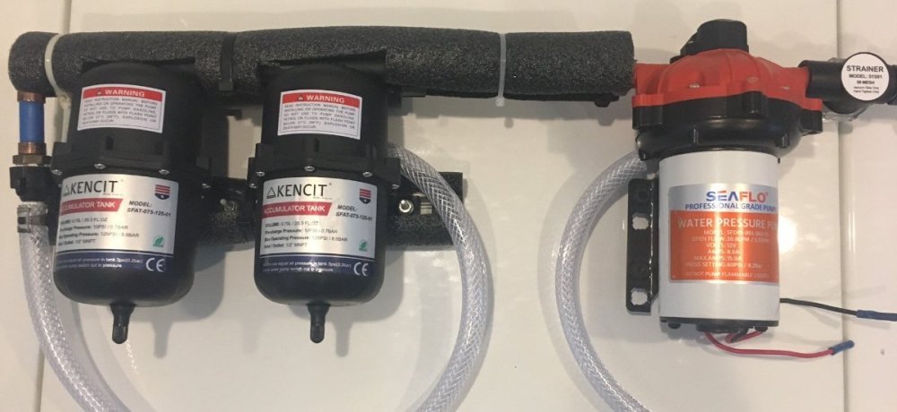

jd1923 Posted November 22, 2023 Author Posted November 22, 2023 On 11/18/2023 at 7:44 AM, topgun2 said: I assume that you are going to need a new/additional mounting board for the second accumulator... Bill Got some plumbing done today. Decided a mounting board was unnecessary and instead connected the accumulators on an old bracket I had, everything wrapped in pipe foam. It should sit nicely on the interior wheel well (see build pic). Yes @Ronbrink just 4 hose clamps, found some automotive compression clamps that fit tight, too bad I didn't have 4. You want a few feet of soft hose by the pump and accumulators so that it runs quieter. I also spent an hour at Depot, figuring out their PEX and SharkBite supplies! I'm thinking some of these will help with the motorized valve installation: SharkBite 1/2 in. Push-to-Connect x MIP Brass 90-Degree Elbow Fitting U280LFA - The Home Depot 2 Chris & John in Prescott, AZ | 2016 EII #113 | '01 Ram 2500 Cummins!

jd1923 Posted January 2, 2024 Author Posted January 2, 2024 Well, this project has not gone as smoothly as I thought at first. The Seaflo water pump had a bad shut-off sensor, would not stop running after being bled. I bypassed my dual accumulator setup (pic above) thinking they might be keeping the pump from achieving cut-off pressure, but same thing. Found out on iRV2 Forum that this is perhaps common to the brand. They make their colors look made in USA, but CHINA is in fine print in the corner of the box. Many on that forum like the Remco, Made-in-USA brand, more on this later. Turns out my fresh tank drain was pushed up so that the plumbing was as high as the top of the tank. OTT does not strap this down. The weight of my new motorized ball-valve should keep it down. I did blow compressed air too. Honestly, our fresh tank only drains well when the nose of the trailer is steeply uphill. There are many reasons for slow water pressure at the faucets. Check out what the incoming water pump filter/screen looked like on the original pump! Should be cleaned annually. Chris & John in Prescott, AZ | 2016 EII #113 | '01 Ram 2500 Cummins!
