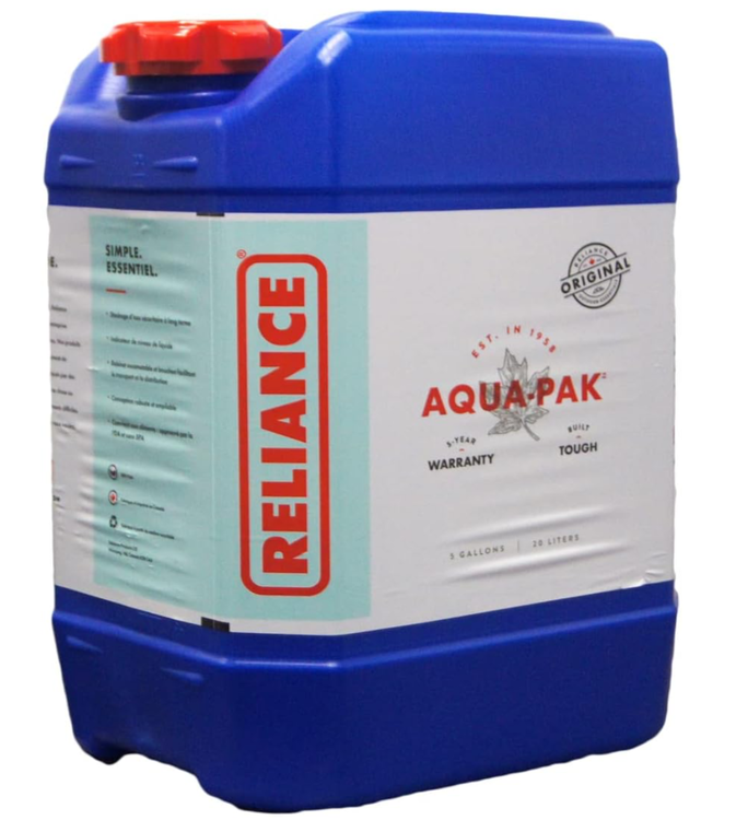

I’m also a water purist. At home I go further than RO - I have a full distillation unit. Before anybody asks about minerals they’re certainly not necessary, you get more than what you need from your food. Plus what is in water isn’t chelated, it’s hard minerals so not usable anyhow. FWIW after some months I clean out the tank and what do I predominantly find? A kind of clay like material. Basically particulates are the biggest foreign component of city water, which is all held to high standards generally with published testing results.
I thought about RO but only works on city and generates a lot of grey water, and anyhow becomes an engineering project (which I’m retiring from! 😅) We don’t have our rig quite yet but I’m planning on carrying fresh much of the time and just using double filtration - I got the Camco unit. That’s good enough for us, it’s ‘camping’ after all. I plan on carrying fresh much of the time as backup. Not planning on drinking out of the FWT though, I don’t trust that plastic and can’t inspect how clean it is. I’ve got 5 gallon jugs we’ll use for that.
https://www.amazon.com/Reliance-Products-Aqua-Pak-Gallon-Container/dp/B0002IW6JS
