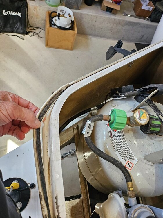

Thanks for all the replies. However I realize that the replies have been about (since I was not clear in my first message) the cover edge when it is the lower compartment edge that the cover sits on that I am referring to. My error.
There is a soft seal that is on the compartment edge....similar to a door seal. Mine is in bad shape and I need to replace.
So...has any replaced the lower seal and with what?

I can't help you here as mine came with a 3M type protective tape and not a rubber seal on that edge. The tape alone seems to be working fine (so far) with the PVC edging sitting right on top of it.
That must be something OTT added on newer hulls that our older hulls do not have.
You got to ask, why in less than 3 years has yours gone bad, when our hull now 10 years old, finally needs some work?
My answer is having the seal up on the doghouse made for the better installation. It looks awful in your picture and being on the lower section it just collects dirt. Ours and yours have the same recess, but ours looks clean never having rubber glued to it.
i just ordered what @CRM suggested, thanks again. I suggest you remove that rubber, use a solvent to remove all the crude and old sealant. The rubber edging suggested will be a far better insulator! Problem solved. 😂
Like jd, my trailer did not come with any kind of seal.  You might want to clean it up and go without.  It hasn’t been a problem over the years.  Mike
