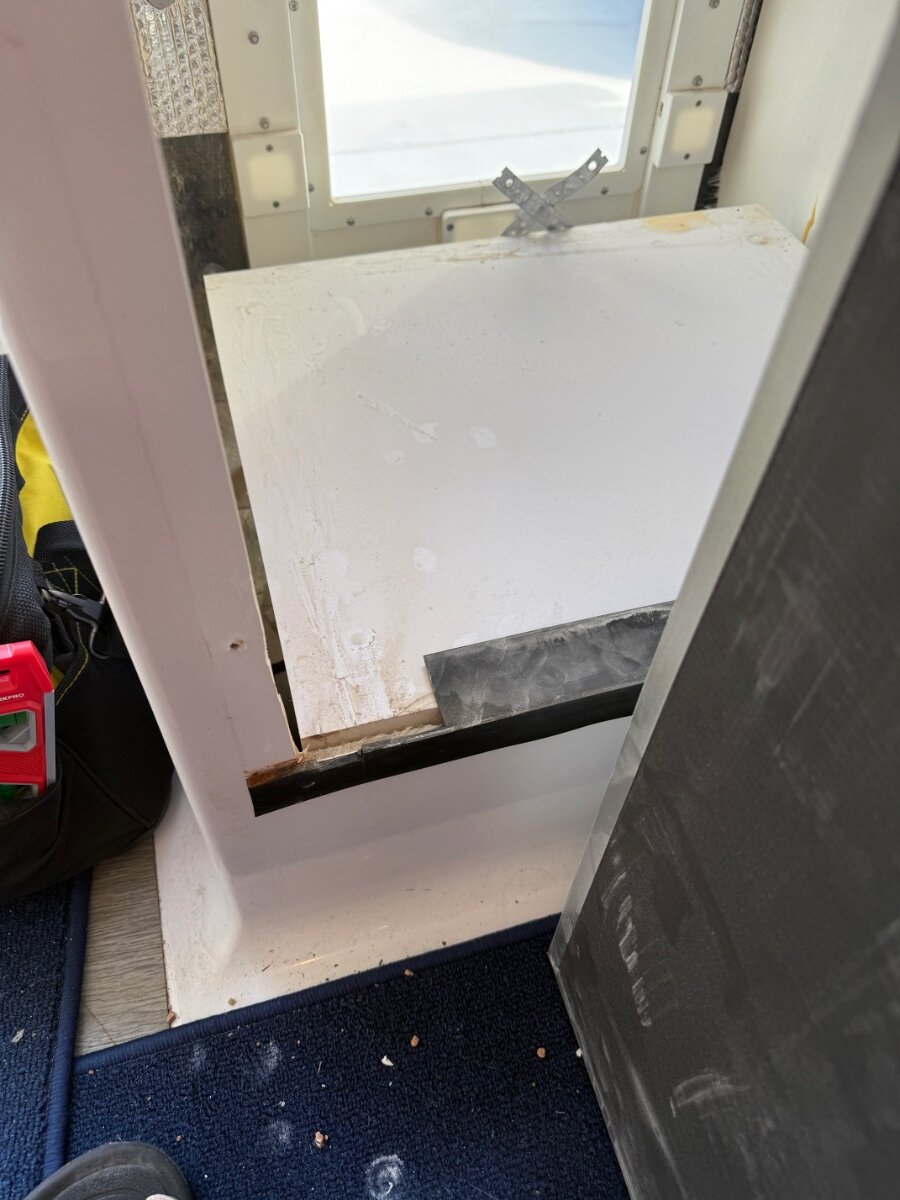

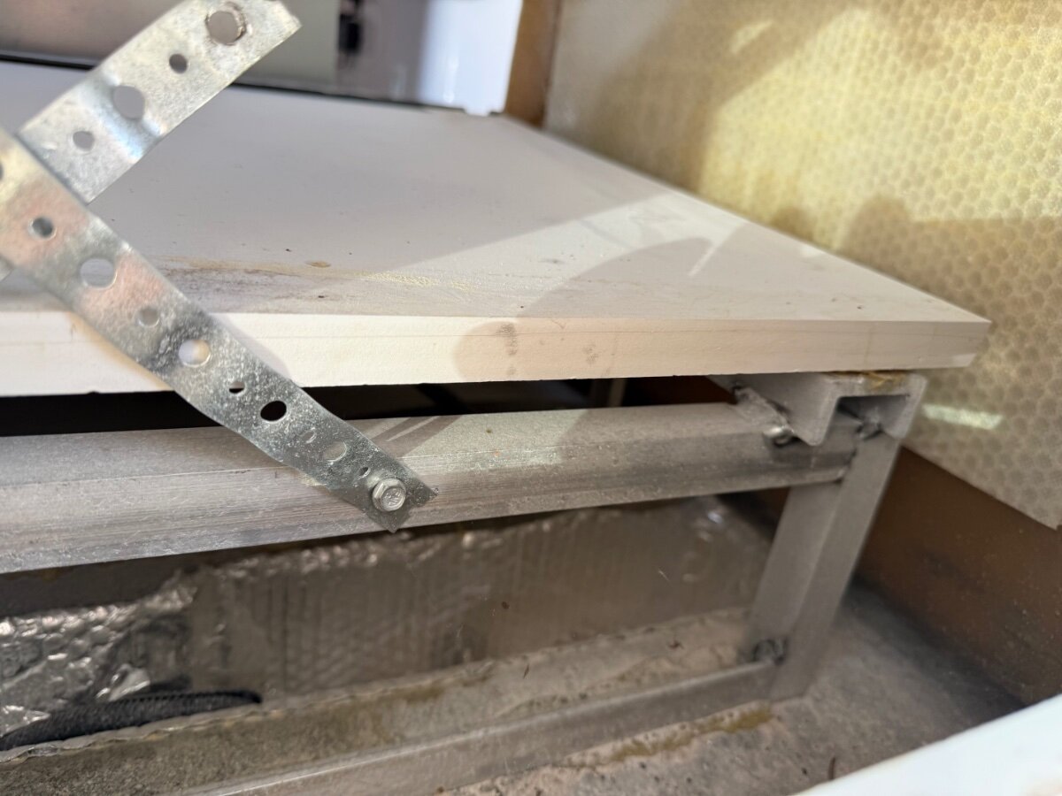

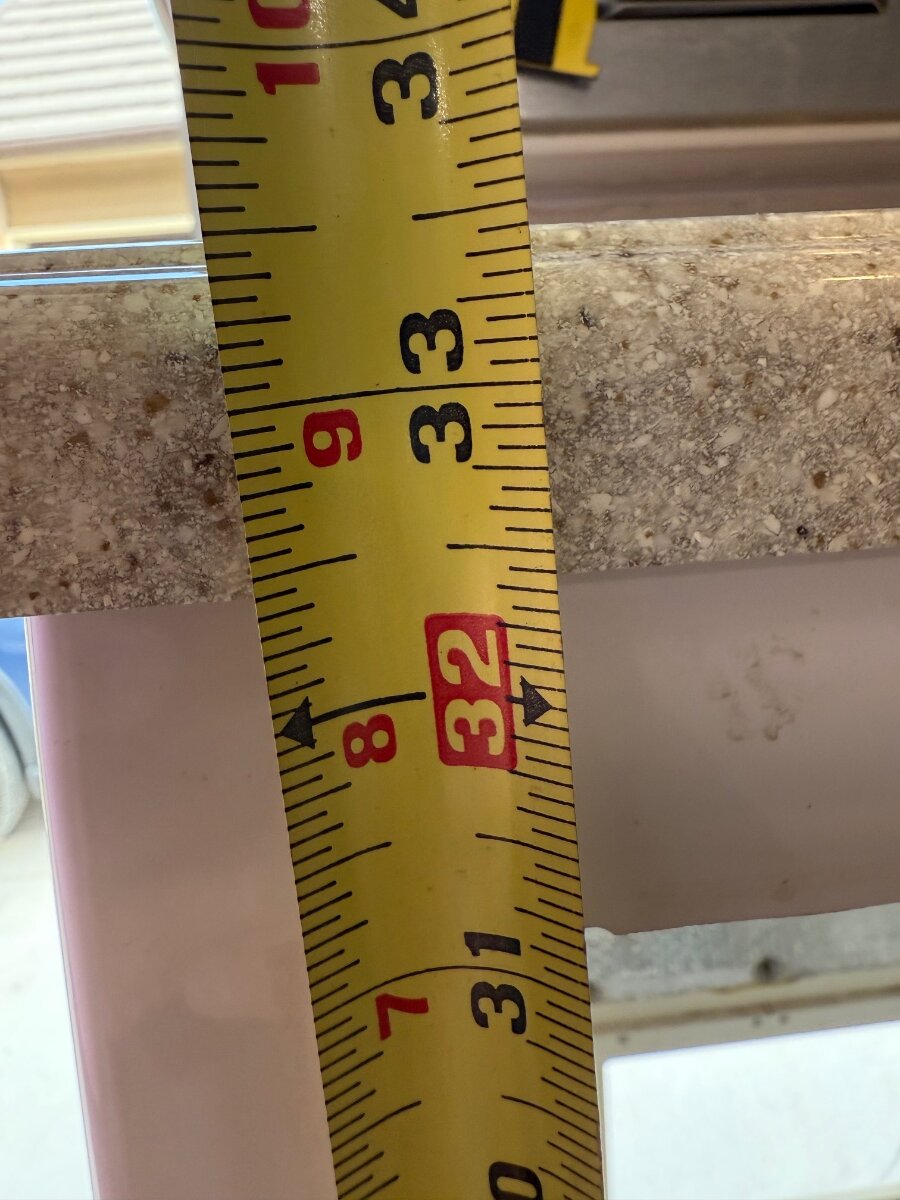

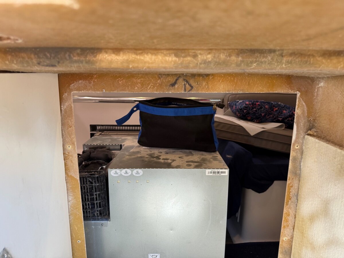

DunnYet Posted July 26 Posted July 26 @mossemi at the risk of bringing this thread back (at least close) to it’s original starting point, can I ask you a couple of questions about your cutout? Is that the original cutout from the factory? Or a larger cutout that was made to fit the new fridge. We are currently looking at a Dometic NRX130C and it needs 32” height. Out factory cutout for the Isotherm is 29 high. Measuring it looks like the 32 will take it right up to the edge of the grey countertop, which looks very similar to your cutout. With some more effort I could go down, but would have to figure out how to remove the support that the factory put in before the hulls were put together. Have you seen any flexing / cracking on the top of the fiberglass with so much removed? Or does the panel that SeaBiscuit made provide additional suppport. (Unfortunately I would not have room for that.) Would appreciate anyone’s advice on going up, going down, or both. I want to make sure I don’t set up a situation where I reduce the structural integrity right in the middle of the trailer. Current: 2023 Oliver Elite II - Hull #1364 "Reset 2.0" (Second Owner) Tow Vehicle: 2023 Ford F-150 XLT 3.5L EcoBoost /w 3.55 axle and Max Tow Package "SIlver" Original: 2022 Oliver Elite I - Hull #1030 "Reset" (Sale Pending) Original Tow Vehicle: 2022 Subaru Ascent "Blue Moose" Home Base: Duncanville, TX
Moderators mossemi Posted July 26 Author Moderators Posted July 26 3 hours ago, DunnYet said: I ask you a couple of questions about your cutout? The refrigerator cutout you see in my pictures is original. My Dometic refrigerator had 2 rails or U shaped pieces of metal ~1/2” high that was screwed into the bottom of the refrigerator and ran front to back the entire depth of the refrigerator. I see Oliver fabricated a platform to raise your refrigerator up. I would think that you could reduce the height of the platform to reduce the amount of fiberglass needing to be removed at the top of the cutout opening. The SeaBiscuit vents are not structural, just decorative. I have not had any signs of stress around the refrigerator cutout. What are the ventilation requirements for the Dometic NRX130C? Have you factored in the the height of the accessory flange or is it not needed? Mossey 2 Mike and Krunch Lutz, FL 2017 LEII #193 “the dog house”

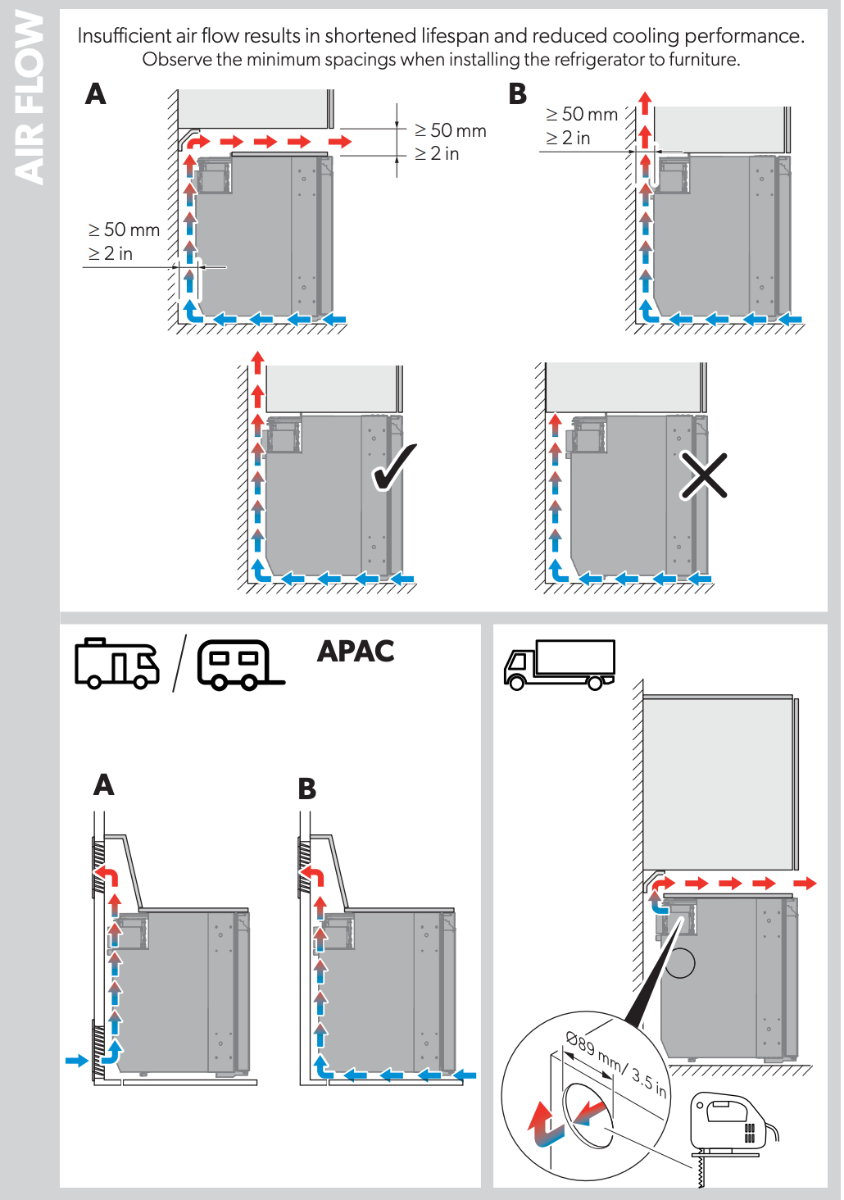

DunnYet Posted July 26 Posted July 26 1 hour ago, mossemi said: What are the ventilation requirements for the Dometic NRX130C? Have you factored in the the height of the accessory flange or is it not needed? We have the LE II '23 so it has the fold up table and the vent at the top of the refrigerator compartment. The diagram for the Dometic in an RV install says airflow under and exhaust out the sidewall at the top or back into the cabin. I think we will go external since we have the existing vent. (B in the image below.) So I need to make sure I have some type of support for the unit that will allow (an unspecified) amount of airflow. Current: 2023 Oliver Elite II - Hull #1364 "Reset 2.0" (Second Owner) Tow Vehicle: 2023 Ford F-150 XLT 3.5L EcoBoost /w 3.55 axle and Max Tow Package "SIlver" Original: 2022 Oliver Elite I - Hull #1030 "Reset" (Sale Pending) Original Tow Vehicle: 2022 Subaru Ascent "Blue Moose" Home Base: Duncanville, TX
jd1923 Posted July 26 Posted July 26 19 minutes ago, DunnYet said: I think we will go external since we have the existing vent. (B in the image below.) So I need to make sure I have some type of support for the unit that will allow (an unspecified) amount of airflow. Looks like you need 2" across the width of the unit at the bottom for intake airflow. Be careful in how much you chop the bottom platform so that you will allow for 2" of airflow. I always wondered why in some compressor fridges, like @mossemi's installation of the Nova Kool that existing vents are capped. I imagine these units must be front cool which means the heat of the unit comes into your living space out the top vent. Am I correct here? I like how this model allows for rear venting! We have the lower intake and upper exhaust vents for the old Dometic absorption fridge. These can be reused with this new model and I would keep the Beech Lane fans I installed for hot days when the entrance side is in the sun. 1 hour ago, mossemi said: Have you factored in the the height of the accessory flange or is it not needed? From the drawings it appear that when using an upper rear vent it would not be needed. This allows @DunnYet more room above if needed for the installation but less room below given the 2" air supply requirement. Chris & John in Prescott, AZ | 2016 EII #113 | '01 Ram 2500 Cummins!
Moderators mossemi Posted July 27 Author Moderators Posted July 27 22 hours ago, jd1923 said: I imagine these units must be front cool which means the heat of the unit comes into your living space out the top vent. Am I correct here? You are correct! The intake air comes from the cabin as well, meaning that all of the air being circulated around the refrigerator is quite a bit cooler than any model using outside air until the outside temperatures reach about 78° and contributing to refrigerator efficiency. Mossey 1 Mike and Krunch Lutz, FL 2017 LEII #193 “the dog house”
