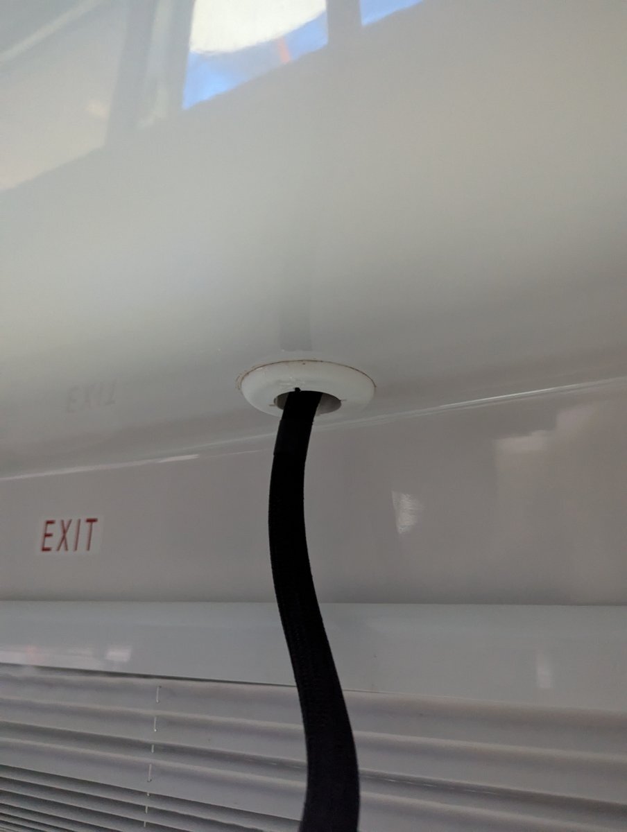

After a heavy rain we have water leaking out of the port the TV wires come through? Has anyone had this problem? The attic is dry?? It seems to be coming from between the fiberglass layers. My initial guess was either the AC or the Oliver Sign. There is no leak around the AC unit directly in. The seal is completely dry and the Ollie sign seems fine. I have not had a chance to go onto the roof to investigate.

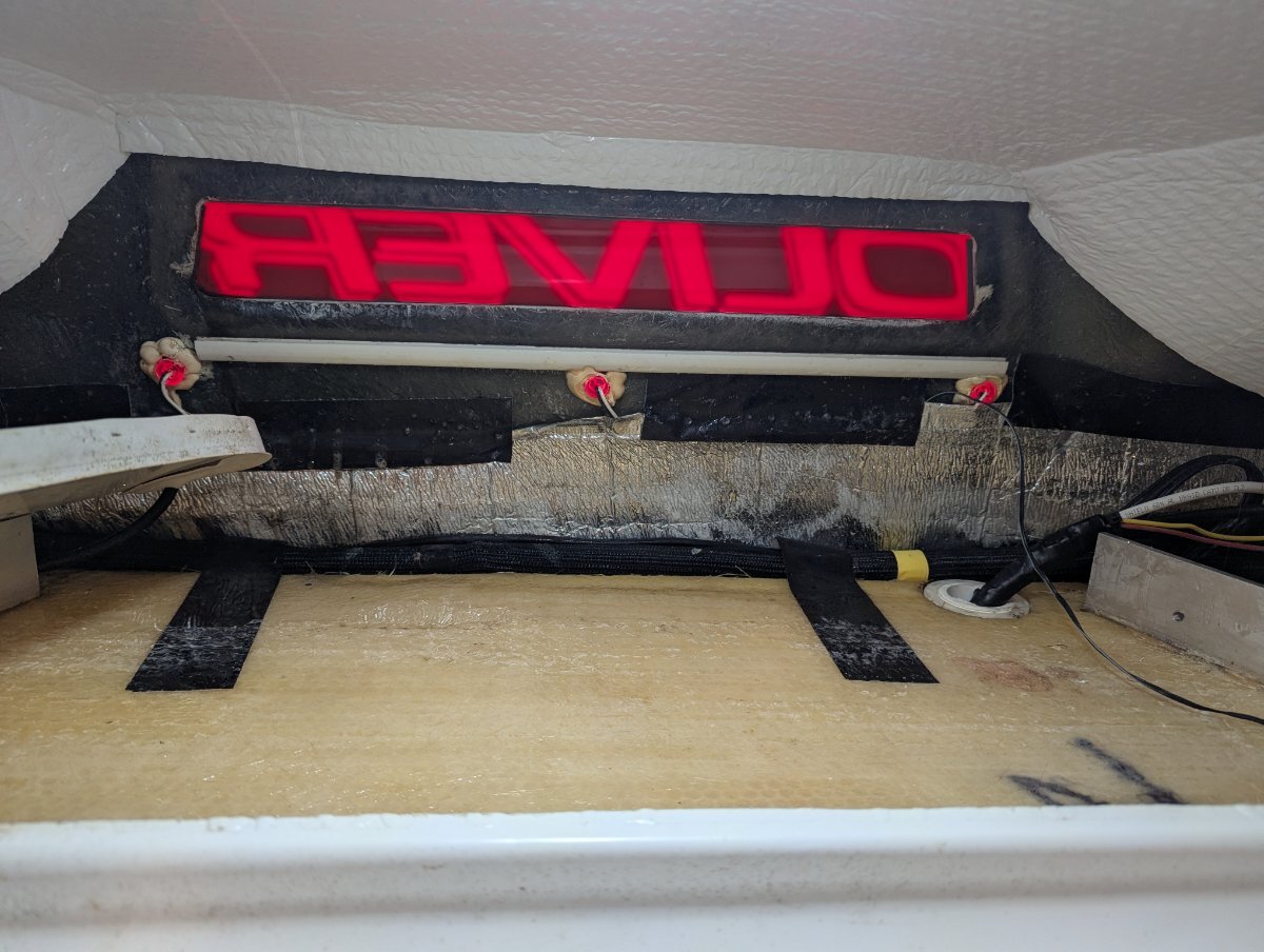

I'd get up in the attic with a bunch of blue paper towels.  Take the panels on both sides of the attic down - you don't have to remove them or disconnect any of the wires.  Lay and/or tape the blue paper towels near/on the areas that you suspect (i.e. around the "Oliver" sign, around the hole into the main cabin, in the area of the rear view camera, as far as you can reach towards the a/c, etc.).  Go outside and give this area a good soak with the garden hose.  Go back inside to look for "dark" spots on the blue paper towels which will give you an indication as to where the leak is coming from.

I took the sides off in the attic. It is completely dry, even dusty. The only place that is even damp is right around the hole. I also took the inside cover off the AC. The inner seal is completely dry. I'm on the road and it's still raining, so I'll have to investigate on the roof more at home.

OK - I'd lay those blue paper towels around the hole.  This will tell you which direction to look for the water flow.  That direction may (or may not) give you a better idea of where the water is coming from.

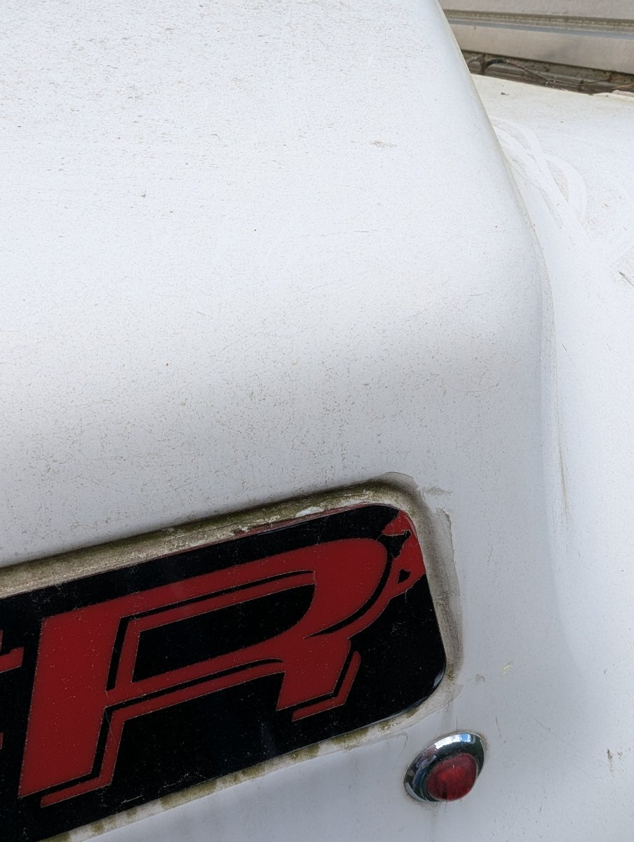

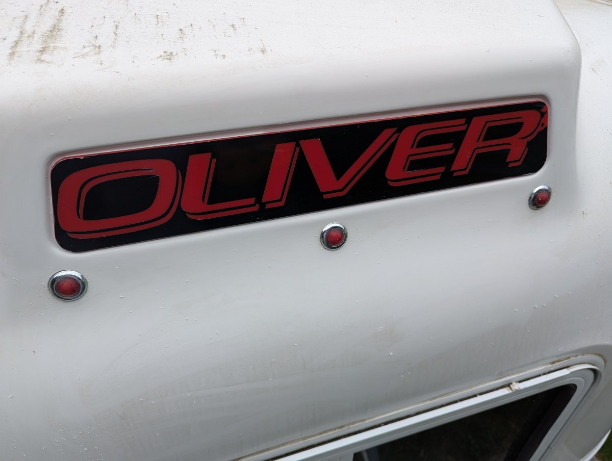

After returning home I was able to better investigate the water issue. Turns out the attic was not dry. It was wet underneath the white insulation layer. I was able to easily peal the the insulation up. The leak was coming from the Oliver Sign. The caulk had dried and cracked. It is actually amazing how much water could get in from that source. All things considered this was the best scenario for the source of the leak.  I was able to remove all the old caulk and re-caulk the sign.

 Cut out the sealant and recaulk it

I would also check those marker lights. The one under the O of the Oliver sign especially. If it leaks, the water would run down its supply wire where it looks like it touches your TV cables. The water would then continue down that cable and into the cabin. All those wires up there with no drip loops designed in are are major pathway for water to travel to far off places. I had drips out my rear speaker from one of those marker lights....

My only leak has been the Oliver sign.  Cleaned and recaulked and problem solved maybe for another 6 or 7 years?  Mike
We went overboard on the Oliver sign, but i think it's permanent  . Replacement lens, Butyl tape, mechanical fasteners, plus caulk. 5 years in, and good.
