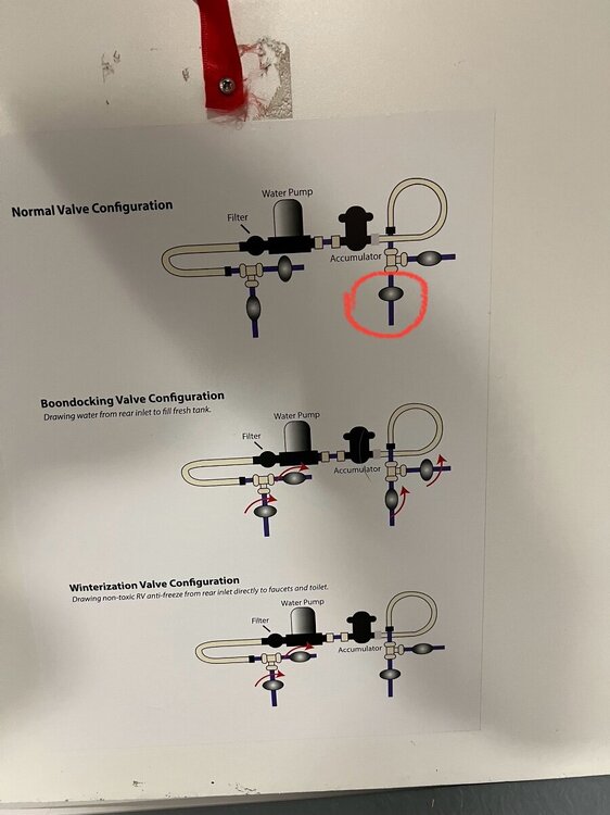

Tom and Doreen Posted July 13, 2025 Posted July 13, 2025 (edited) You can try setting your valves to the normal position, turn your pump on, then turn the valve circled in the picture below 'on' briefly. You will hear water rushing into your fresh tank. What this does is pump water from your fresh tank back into your fresh tank. This will purge the air out of the pump and associated components. This has happened to me many times after traveling and arriving at a site, somehow air gets into the system. Edited July 13, 2025 by Tom and Doreen 3 Tom & Doreen • 2023 Elite ll • Hull #1321 • 2023 Tundra Platinum Crew Max • Cheshire CT
DWR Posted July 13, 2025 Author Posted July 13, 2025 thank you.... will give it a try........ Dan and Elise. 2025 Legacy Elite 2. Hull #1619. 2025 Chevy Silverado 1500, North Central Pennsylvania
