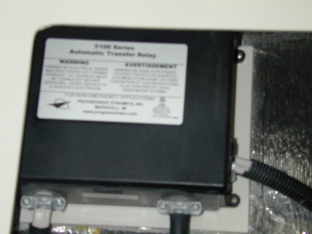

I searched www.progressivedyn.com and entered my 5100 Series name and "No matching records found".  Found a PD5118610 on the side and those 4 digits do not come up with anything as...  It is the black 'box' in one of the photographs. They show a metal junction container with cooling fins.  And a Fan.  Called a converter on their website.  Must be somewhere else... but so far a black plastic box that you cannot miss.
I appreciate any help.  Just to track down anything obvious, but not bothering wiring or connections.  Like entering a Coal Mine and someone wants to light up a cigarette... is also not a good idea.
Any help is greatly appreciated by myself and others who are curious.  Going back into the OLIVER to... sniff around,
In this same second area under the seat where the PD5118610 is located there is also a Smart Surge.  There is a woven cover in black, at the bottom corner, where is is truncated about five inches from the box.  May be in the photograph of the components in one photo.
Smart Surge EMS-HW30C
I am going to contact Progressive Dynamics and inquire to cure my ignorance, if possible.

Called Progressive Engineering and discovered THEIR HARDWARE and wiring coming in and out have:
NOTHING TO DO WITH THE BRAKING SYSTEM.
Drew explained to me what their system is for... nothing to do with brakes.  Internal electrical system for the interior components.  Scratched that off my observations.
If you have an inside power issue: 269-781-4241. Service Department

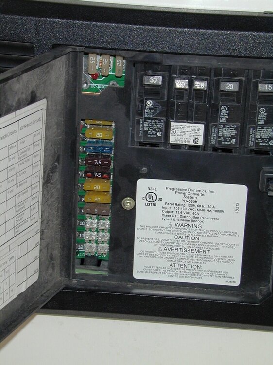

I noted the Blue Fuse in the fuse box under the 'dining table'.  Of course the door opens outward, you crawl under the table and discover that reading glasses are not enough to read the small print.
But the BLUE Fuse number was not as clear as the others.  Took a photograph, under the table and left room for my head and camera for the photo.
My thought was... I had expired into the 'after world'.  But photo flashed, I grunted.. she did not call 911. I finished a new possible discovery.  Much like Columbus... but without a sail.
Here I am.  My very old Mac Computer was out of date, now have a new modern computer and things are... different.  But this is my practice, like a being a horse, learning to carry a gal on a saddle... kind of experience.  No spurs needed... I cooperate very well.
If it is this fuse... I will keep it... frame it on the wall... and curse at it once a year on the repair date.  I replaced a 15 year old computer than worked fine... but the software needed to use it... made it obsolete.
Now a 2019 Oliver Elite II... six years old and turning me back into a Neanderthal that uses a walking stick as a... tool of sorts... if everything else fails? Whack it.
What is the Blue Fuse...?  Human Beans with an Oliver know.  I cannot read the tiny print,  backwards and upside down...  Have a good day.  Mine is coming Wednesday.  I hope.

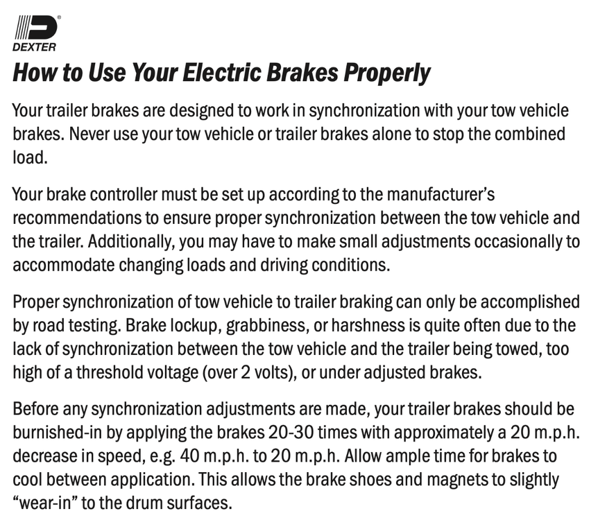

As an aside to your brake issues....it's important whenever brake assemblies are new or changed to "burnish them" in before full trailer use.
I learned when picking up Hull 505 that electric trailer brakes on new trailers must be BURNISHED or heated up to brake them in and seat them to the drums.
When we started to pull away I grabbed the controller and squeezed...no brake action.
I walked back into the service team and they  showed me a page in the Dexter Service manual.
They said I needed to burnish my brakes by driving on some back roads on my way to the first campground.
I found that after about 30 applications my brakes where really starting to work well.  The next morning as we pulled away I dropped the controller back to 5 out of 10 and I had working brakes on our trailer.
This is NOT done by the factory that assembles the trailer.
It must be done either by the DEALERSHIP selling the trailer....or more likely the OWNER.
Hopefully you'll catch a break and things will all be fine after your RV Tech visit.
To seat the brakes, Dexter and other manufacturers have a recommended brake in procedure.  *See video&
According to the label on the fuse box door it's for the furnace.
If you want to check your blue wire and white wire for continuity, just put a 12v test light between the blue and white wire connectors at the 7 pin and then activate your breakaway switch. According to the schematic, that should power the blue wire and the white wire should complete the circuit to ground to light the test light.

15Amp is blue, and it's for the water pump.  Pix of ours so you can read it in a 2019EII Hull 505
Notice that I crossed off the #5 AC breaker for the 12V Charger.
When I upgraded to Lithium batteries I replaced our embedded 12V charger with a new combination 2000W Inverter/Charger .
I disconnected the wiring from the 15A breaker for the embedded 12v charger to deactivate that circuit.
Edited by Galway Girl
Thanks for correcting me. In his pic it looked like it was in the #4 fuse position to me.
