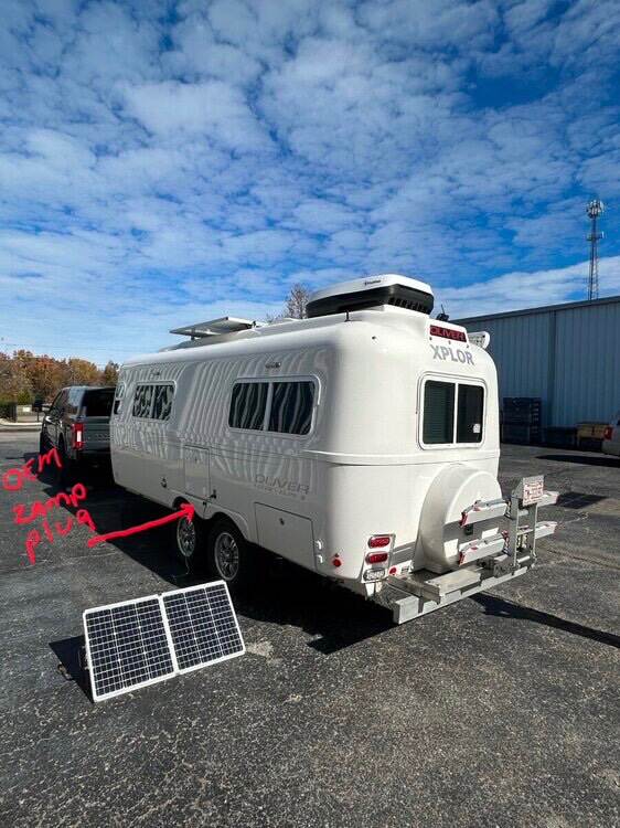

Patriot Posted December 24, 2025 Posted December 24, 2025 10 hours ago, Geronimo John said: I prefer not drilling large holes in the side or the top if they can be avoided. So for our solar suit case, I plug it into one of these mounted on the door of the battery area. It only requires a small hole, easy to mount, and could easily be repaired (or replaced) should for some reason I no longer have my solar suit case setup. And it is quite inexpensive vs. the larger plug holes. Or you could mount it thru one of the vent holes. However it is limited to 30 amps for the 10 AWG one. It typically used for 200 watts of solar panels. GJ GJ, I use the OEM installed Zamp plug for our 90W Zamp Solar suitcase. It bumps up our solar to 420W. With the DC-DC charger it may not get much use. The Zamp suitcase is a very nice product, but heavy as a boat anchor. My guess is to keep it from blowing over in the wind. 1 2020 OLEII - Hull #634 aka- “XPLOR” TV 2021 F350 6.7 liter Diesel Lariat Ultimate Tremor aka - “Beast of Burden” Truma Aventa 13.5 AC, Alcan 5 leaf pack, Alcan HD shackles & HD wet bolts, 5200lb never lube axles.XPEL 10 mil PPF front both front corners, 30 lb LP tanks, Sea Biscuit Front Cargo Storage box. ⚡️⚡️11/2025- Lithium upgrade to XPLOR - (2) Epoch 300ah Lithium batteries, Victron 3000W MultiPlus-II, Victron GX Touch 70, Victron Cerbo GX, Victron Smart Solar MPPT, Victron Smart Shunt, Victron Orion XS 1400 DC-DC charger, RV Soft Start. Zamp 90W suit case solar panel for 420W of solar.⚡️⚡️ North Carolina

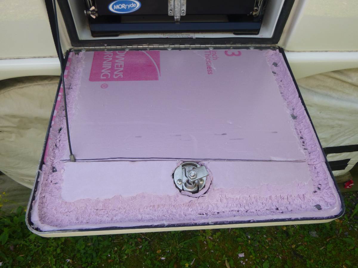

Moderators topgun2 Posted December 24, 2025 Moderators Posted December 24, 2025 (edited) 14 hours ago, jd1923 said: Also in the picture, checkout the rubber disc in the adjacent vent hole. A lot of dirt gets in the bay during travel, not anymore. These vents were only needed for LA batteries. I'll seal the 8 vent holes with rubber discs with clear silicone on top to eliminate dirt or moisture in the bay! Search on Amazon for "rubber discs. These are 1" dia and " 3mm thick. Another way or as an addition - you could always add insulation in the form of "foam board" to that door. Bill Edited December 24, 2025 by topgun2 3 2023 Ford F150 Lariat 3.5EB FX4 Max Towing, Max Payload, 2016 Oliver Elite II - Hull #117 "Twist" Near Asheville, NC

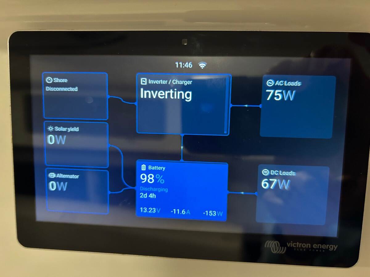

Patriot Posted December 24, 2025 Posted December 24, 2025 (edited) 3 hours ago, topgun2 said: Either another way or as an addition - you could always add insulation in the form of "foam board" to that door. Bill Bill, Do you remove your Lithium Batteries from “Twist” during winter storage? Or do they have built in heating elements or a heating pad? It’s a beautiful day here and I was just out at the Ollie Hangar. I turned off our 30 amp shore power and am now exercising our new Epoch’s by running our dehumidifier for a few days. I am finding the instant read out of the Victron GX 70 is a nice option and a great back up if a Bluetooth connection is unavailable. The GX 70 fit perfectly in the space of the old Zamp solar module, no drill and no cutting. 76d here tomorrow…crazy weather for Christmas Day. 🤔 Edited December 24, 2025 by Patriot 2 2020 OLEII - Hull #634 aka- “XPLOR” TV 2021 F350 6.7 liter Diesel Lariat Ultimate Tremor aka - “Beast of Burden” Truma Aventa 13.5 AC, Alcan 5 leaf pack, Alcan HD shackles & HD wet bolts, 5200lb never lube axles.XPEL 10 mil PPF front both front corners, 30 lb LP tanks, Sea Biscuit Front Cargo Storage box. ⚡️⚡️11/2025- Lithium upgrade to XPLOR - (2) Epoch 300ah Lithium batteries, Victron 3000W MultiPlus-II, Victron GX Touch 70, Victron Cerbo GX, Victron Smart Solar MPPT, Victron Smart Shunt, Victron Orion XS 1400 DC-DC charger, RV Soft Start. Zamp 90W suit case solar panel for 420W of solar.⚡️⚡️ North Carolina
Moderators topgun2 Posted December 24, 2025 Moderators Posted December 24, 2025 (edited) 56 minutes ago, Patriot said: Do you remove your Lithium Batteries from “Twist” during winter storage? Or do they have built in heating elements or a heating pad? Nope & Nope. However, I do turn off the solar panels and have no other electricity going into the camper. I check the state of charge on the batteries around mid February each year and they have always been good. Then, in April, I take my 25 watt solar panel and plug it into the batteries so that they slowly charge back up to 100% over the next month or so. Of course, if I had that sweet setup that you have I'd probably do things a bit differently, but, this seems to work well so far. Bill Note: I used a spoon (not very elegant) to carve out room for the existing rubber gasket seal on the door - I didn't want to remove that gasket (because it seemed to seal the battery compartment fairly well) nor did I want to simply cut the foam board to fit inside the gasket. Edited December 24, 2025 by topgun2 added detail 1 2023 Ford F150 Lariat 3.5EB FX4 Max Towing, Max Payload, 2016 Oliver Elite II - Hull #117 "Twist" Near Asheville, NC
