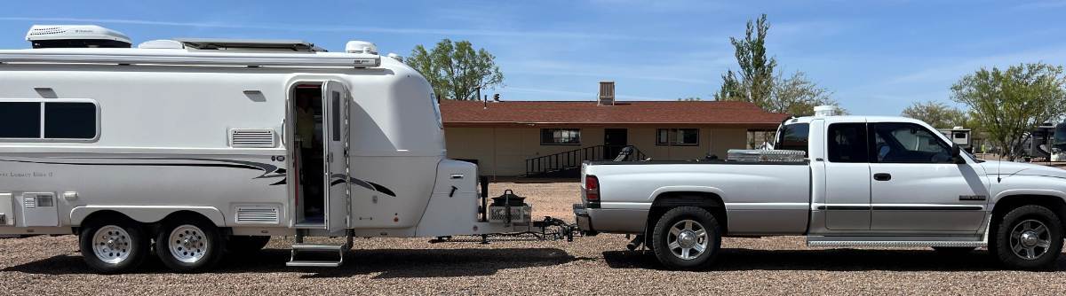

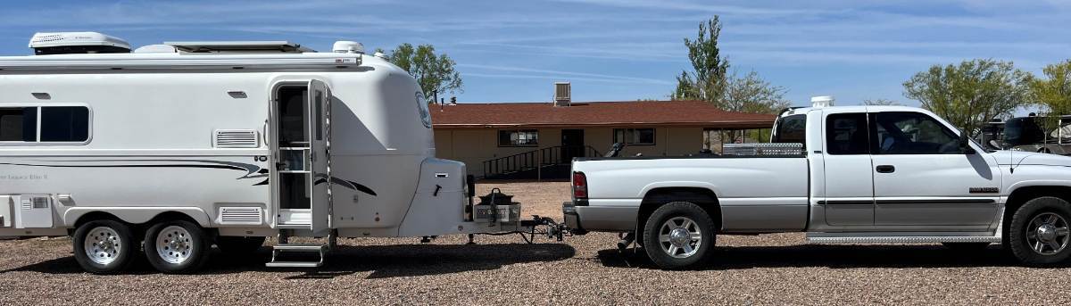

I went through similar thoughts when we started towing our Oliver a couple years ago. Our tow vehicle is borderline on requiring the WDH, but the user manual does state to us one when hitch weight is >500 LBS or trailer >5000 LBS.
I believe set the Bulldog at the height OTT recommends as Ron stated above. When I hitch the Oliver, the rear of our truck drops 2". Checkout my pics. First is hitched and second is adding the Andersen WDH tightened correctly. You can see in the second pic a good level front bumper of TV to rear bumper of TT! But yes, the WDH does add lots of stress at the ball for sure and likely elsewhere.
In two years, 135 overnights and 15K+ miles, I've only felt comfortable with WDH attached. Without it the under-sprung Oliver will waddle through intersections and porpoise over bumps and dip. Until...
Recently, I upgraded adding Alcan Leaf Springs rated at 2750 LBS each vs. the OEM 1700. The difference is night and day. I haven't beefed up the TV rear suspension at all, it's just that now the trailer suspension is handing the trailer and not moving the TV all over the road, like the tail waggin' the dog! 🤣 Our Andersen WDH is now in storage, until somebody wants to buy one. Better springs will likely give you what you want. It's not whether your hitch is up or down an inch or tension +/- on the Andersen.
The other thing is ALL Oliver Owners should purchase is the LevelMatePRO (get the PRO model which can be wired directly, no battery changes needed). Find the most level place you can park, set the 3 stabilizer jacks and get as level as possible (us a sight level in many places like you've down). Then you go through calibration steps on the app. I wired my PRO model out-of-sight, under the rear dinette seat where 12VDC is easily available. We use it every time we're parking the Oliver. I turn the app on from the driver's seat to get the best possible spot. Then Chris get's out and places the Andersen Rapid Jacks under the correct side (when needed). I roll up, set the parking brake, and we're done! 😎

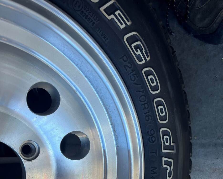

Hmmm? Is my spare something a prior owner changed? Ron has a 2020 and Sam a 2025. Asking @topgun2 and @Mike and Carol who have 2016 hulls: Are your 5 tires all the same size? It would be great if I could replace my spare with LT225/75R16 if it fits inside the fiberglass surround.
Our spare tire is as old as the trailer but I believe it's been replaced, since a P-rated RWL tire that doesn't seem to be OEM. Replacing the spare has been bottom of my list because if/when we get a flat, I would more likely park/detach the trailer, remove the wheel and run it down the road for repair.
On our 2015 LE2 a 225X75X16 tire will not fit in our spare tire housing, so I installed a 225/75/15 Goodyear ST spare, same tire that Oliver now installs as standard. Oliver said the fiberglass tire housing on the 2015 LE2 a 225/75/15 tire would fit. My 2015 Ollie came with a 215/60/16 spare tire.
Nope!
The spare tire housing was originally designed to fit a 15 incher.  But Oliver changed to 16 inch tires at some point and never got around to changing that housing - this includes both the exterior cover and the indent in the two outside molds.  However, Oliver was again "forced" to change back to a 15 inch tire due to supply issues thus making a possible change to the molds unnecessary.  So, My spare is a 15 incher and the other four "running" tires are 16 while the newer Ollies are 15 inch all around (including the spare).  I'm sure that someone has those exact dates of change (ScubaRx maybe) but it is easy to see which spare you have.
p.s.  perhaps it is understandable concerning the spare tire issue when you know that a single exterior main body mold costs something in excess of $2,000,000.00 to fabricate.  I'm guessing that a change to that mold might cost a bit less but then you've got to consider the cost of taking it out of production while the change is being made to it.

Including the spare tire? Ron, please verify size. According to what Bill @topgun2 wrote, that wouldn’t be possible.
And thanks to our other Bill @rideandfly for the link to the spare tire thread. I have 5 identical 16” wheels so I’ll replace my spare tire with the same LT215/70R16 size I have or something very close to the smaller diameter.
