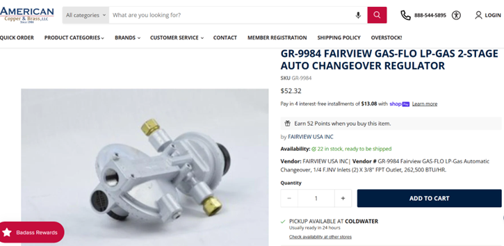

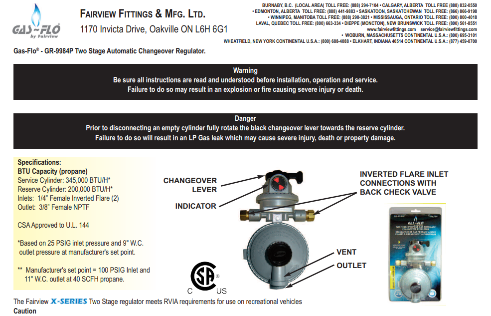

3 hours ago, Galway Girl said:
I checked AC out yesterday, the version they sell is the 262K BTU version (bottom in data sheet)GR-9994.
Drats you are correct.  It appears that the American Copper and Brass have their wires mixed up.  They are selling these two auto change over valves.  Their left one shows 245KBTU and the one on the right is their 345KBTU model of another mfg.  .
Gut the Fairview Fittins and MFG web site says that the GRF9984 is a 345 KBTU model as I posted previously.
image.png.d0a9e68b2e1c715244de066443a1c5b6.pngThe Fairview web site says that the GR9984 is rated at 345,000 BTU.  Go figure????.
Here is the link to the full manual:
https://olivertraveltrailers.com/wp-content/uploads/oliver-university/Component_Manuals/Propane_Regulator/Fairview-GR-9984P-Propane-LP-Regulator-Manual.pdf

5 hours ago, Galway Girl said:
Amazon has the GR-9984 with 345,000 BTU version
This is the model I purchased recently. Thanks Craig, I read an earlier post of yours citing  this model.
The original regulator, now 10 years old was still working. After reading advice here to replace such an old unit with new, I did so. The old saying, “should have left well enough alone” has come to play!
At first it was the sounds, but I can see reasons for sounds as listed above. In attempt to eliminate the sound, I closed both tanks, released line pressure and started again. It’s a sort of a mechanical reboot!
The sound went away temporarily, but then we could not start our indoor appliances (HWH, cooktop or furnace). Meanwhile our fire ring was still burning… What?
And after 20 min, the outdoor fire slowed down. The fire ring on high was like it was set to low! So I did the mechanical reboot again (after turning off the fire ring). Then the furnace started and everything was back to normal.
It’s not the BTU capacity of the regulator, since I doubt I was running 100 BTU, let alone 260 or 345! My brand new GR-8894 regulator has an intermittent issue.
So, I will replace it again! On the advice of another Oliver owner, I purchased the one @Geronimo John just cited as the HO regulator that American Copper lists! My understanding is that Marshall Excelsior makes a quality Made-in-USA product. I’ll let you know how it goes… 😎
https://a.co/d/0drkfrTK

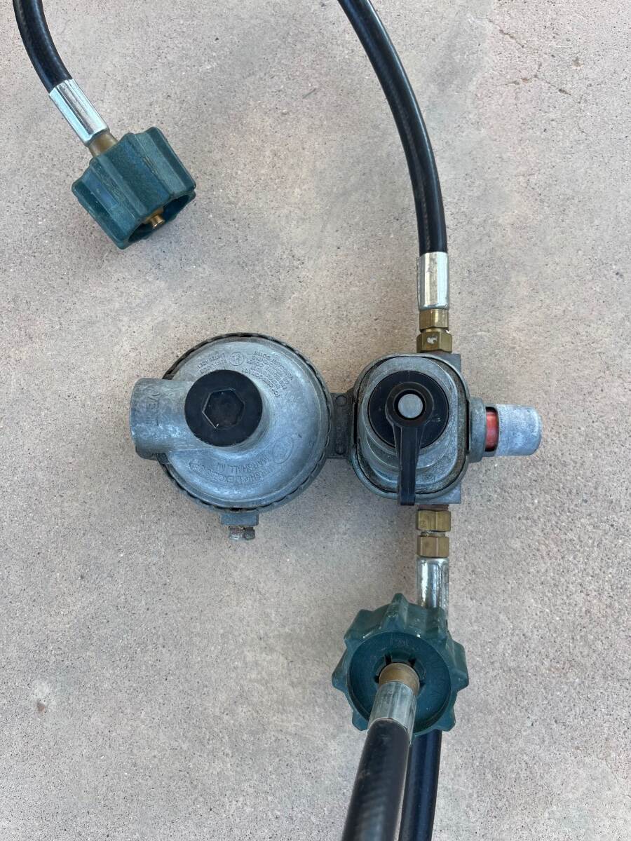

I took a look today at my original regulator to see that OTT installed a Marshall Excelsior MEGR-253 which is rated at 225,000 primary cylinder BTUs. It’s hard to read but front pic shows the brand name and rear pic lists the model number.
Recently I installed the Fairview GR-9984XF which is acting up! I purchased a kit just like this: https://ebay.us/m/Opru0 Maybe these kits at this price are knock-offs resulting in my issues.
The regulator I just purchased is the Marshall Excelsior MEGR-253H. The H stands for High output, rated at 350,000 primary cylinder BTU.
Our hull was running fine, for 10 years, on 225,000 primary cylinder BTUs, showing the high output units are unnecessary but they cost about the same at $80. We run our fire ring almost every evening and often the 2-burner Napoleon Grill and don’t want that feeling again that the furnace will not start!
It appears OTT moved from Marshall Excelsior to Fairview at some point. I’m going to toss the faulty Fairview, install the new MEGR-253H and keep the old MEGR-253 as a back-up! 😎

We replaced our OEM installed Marshall Excelsior MEGR-253 in January with the suggested Fairview model that I believe OTT installed in later hulls. This regulator failed immediately! First trip out it made whistling noises. Second trip out, making noise again, it shut down in some odd way. The fire ring kept burning, but no indoor appliance would start (HWH, furnace or cooktop). Then after 20-30 minutes, we could see the fire ring burning weaker and weaker. I had to disconnect both tanks and do a sort of pressure reboot and fortunately we did get the furnace and other appliances to work for a couple days to get back home.
I wasn't going get stuck again, so I re-installed our original regulator for our next trip. I had trouble finding Marshall Excelsior products online except for Amazon, so I contacted the manufacturer. They suggested an authorized reseller that would back the 5-year warranty named Tweetys from Bulverde TX:
https://tweetys.com/marshall-excelsior-megr-253h-excelaflo-automatic-changeover-regulator---high-capacity.aspx
I went with the Marshall Excelsior MEGR-253H model, H for high output. Their tech support explained there is nothing wrong with running the H model and it would allow for running more LP appliances simultaneously. This is a well-built regulator and the one that's been working 10 years is now my backup. I tossed out the Fairview model since warranty claims on a $50 part is not worth my time, the return shipping costs and I would not want to chance installing a replacement.
On occasion having a rear connection would be helpful. OTT installed one, but why in the bumper?! I'm not going to lower the bumper, push the waste hose out of the way to use it. We only open that at the dump station! I thought of moving it so to be accessible, but so far not worth the effort. OTT should redesign this, mount it like they did the front outlet. We added a 12' LP extension hose with a Y-adapter to run the fire ring and grill.
