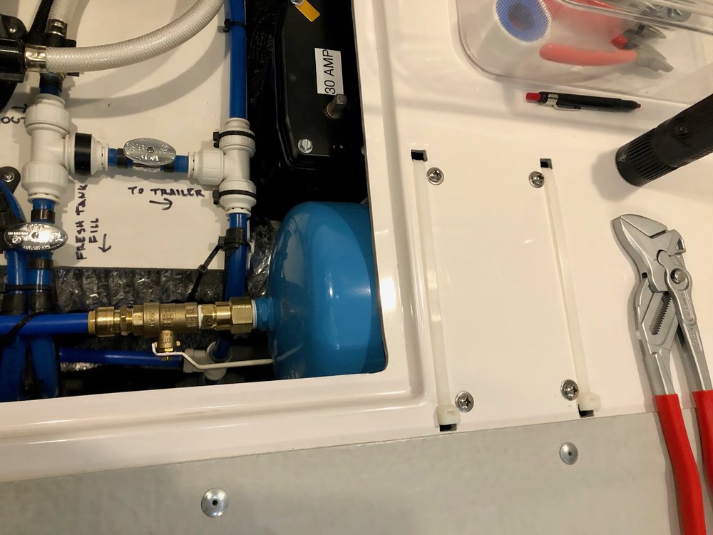

Pressure tank install...
This is the Flotec FP7105 that one or two others have added, sitting under the curbside bed, kind of half in front of the water heater. It's a 2 gallon recharged tank. I placed it here because I wanted to add a valve to isolate the tank when traveling, winterizing, etc. Oliver gave me an access hatch for the water valves, and this sits just inside the hatch. It's nice because I can just reach in and feel for the valve and not have to crawl around on the floor looking for it. I just didn't want to travel with the water system pressurized in case there were a leak. This way I can just shut the valve and open a faucet and all the pressure is released. then when we get to camp, I can turn on the pump and open the valve and it doesn't have to fill the tank back up.
I glued and screwed two blocks to the fiberglass to keep the tank from shifting, and then ran two heavy zip ties through to hold it in place. I put some rubber mat on the blocks and cut a block to keep the zip ties in place. It feels really solid. It was a pain to get it in there and work around it, but now that it's in place, accessing around it really isn't too bad. While I was in there, I did my zip tie tie-ing and fiberglass dust dusting. And learned my PEX skills, which is a necessity. Also, I bought a nice collection of PEX fittings and some tubing for repairs. The only thing I don't have is a crimper, which is darned expensive and bulky, but there are a few connections here and there which seem to require one.
Mo pics...
My guess is, your pressure tank is oversized. Our pressure tank for our whole house is not a lot bigger. The boat tank is far smaller.
I found a table for right sizing the tanks years ago. I'll try to find it again.....
Sherry
When I was looking at them a few months ago I used an online calculator where you put in the pump GPM, start and stop pressures, and how long you want the pump to run. I picked a 15 second run time and it came out as needing I think a 5+ gallon tank. This tank is supposed to be the “equivalent” of a 6 gallon so it seemed right. Choice is pretty limited in the smaller sizes. They don't make a horizontal model in that size, but I think the only difference is the mounting hardware, of which there is none.
Had I gone smaller it would have exacerbated the problem I’m having with my pump not giving me the proper start-stop pressure differential, so I’m glad I got what I did.

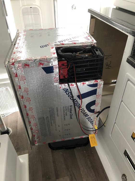

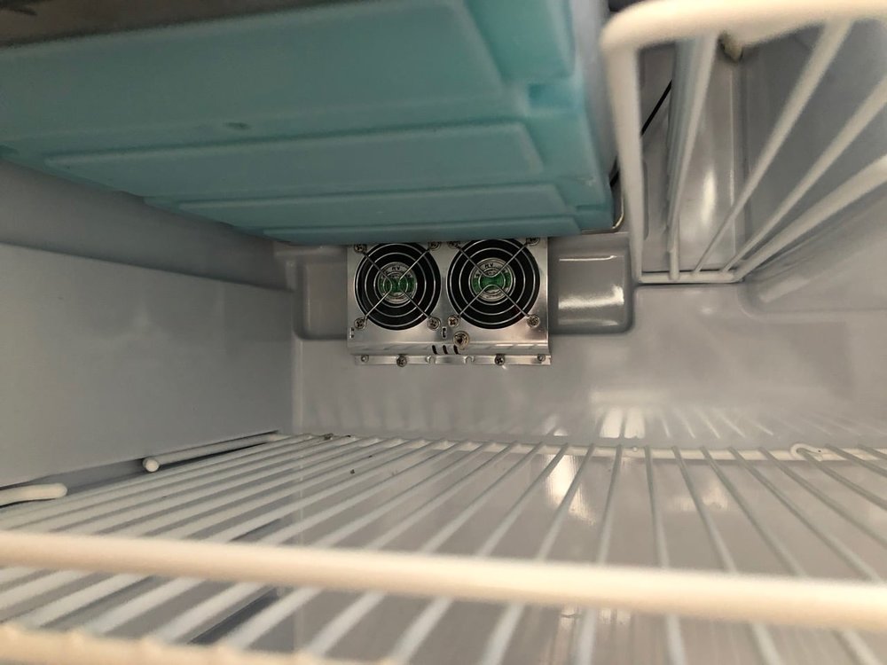

I posted a while back that we were having trouble with cold spots inside our Isotherm fridge. Basically, stuff under the freezer on both shelves would freeze more often than not. So I decided to add a fan just under the freezer to circulate the air. We'll see how it does.
This is the fan I got - seemed much nicer than anything else I could find. It has two fans and connects directly to the 12v supply. You can keep the wiring in the fridge and connect to the light, if you have one, or if you don't, or don't want wires cluttering up your fridge you can do as I did and drill through to connect directly to the DC supplying the fridge.  I drilled straight through the back behind the fan, ran the wire and caulked both sides.  I tapped in to the DC fan supply on the side by the compressor.   I had to flip the fans around in the housing since the fan kit is designed to blow into the fins on a dometic fridge. The fan has an on/of switch and seems to draw about 0.1 amp.  You can hear it pretty well when you have the door open, but is completely inaudible with it closed.  The fan isn't super strong but you can feel the air coming off of it even at the front of the fridge.
I decided while I had the fridge out to add a layer of insulation all around. 1" in the back and ⅜" on the top and sides, which is all that would clear the cutout in the fiberglass. It was a tight squeeze even at that.
I also spotted a couple fins on the coil that were touching the top of the fridge, which were probably what was causing an occasional buzzing, so I bent those back and generally made sure everything was rattle free.

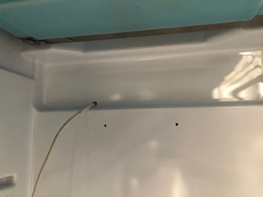

Drilling for the DC power -

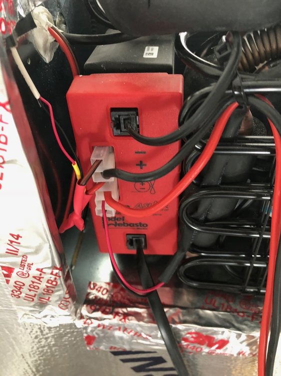

This is the ASU module on the side of the fridge where I tapped in to the DC.  The wire with the white insulation sticking out is to the fan. The yellow bit is an inline fuse that comes with the fan. Not particularly convenient if it ever blows.
All wrapped up in insulation.  Cut the bejeezus out of my finger on that aluminum tape -
And the finished product. I was fortunate that there is that little scallop in the fridge liner right where I wanted to put the fan. Otherwise I'd have had to block it out for airflow. Two screws hold the bottom, and the top is fixed with my favorite 3M 4200 since I didn't have access for screws. A little 4200 on the screws as always to hold them tight -

Just a quick follow up to the refrigerator fan install - it works, and so well that I highly recommend it for anyone who's having trouble with fluctuating fridge temps or cold spots. My fridge now stays between 33 and 40, even when opening the door a lot, the freezer stays frozen, and everything in the fridge is a nice even temp with nothing freezing, regardless whether the fridge is packed full or nearly empty. I was able to turn up the thermostat a bit, too. It's really transformed the fridge.
By the way, I've been able to do some closer monitoring of the fridge power consumption and I'm really happy with that as well. It will draw between 4 and 5 amps when starting up (a few seconds at that draw for each startup, or it will stay at the higher compressor speed when cooling off a warm fridge - I think that's only when it detects a charge from solar or shore power). After that, it's a steady 2 amps or less. The typical lighting we use at might draws more power than the fridge. I haven't gotten a bead on it's run time yet - I'm sure it's over 50% but by how much I don't know.
Also now that I bent back those few little prongs that were vibrating on the case, it's quiet as a mouse. You can hear it when everything else is dead quiet, but even then it's not bothersome - you really only notice it when the compressor is switching speed and that's just because you notice the tone changing. The loudest thing in our trailer now is the fan to the composting toilet.

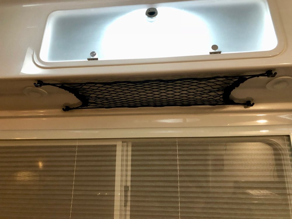

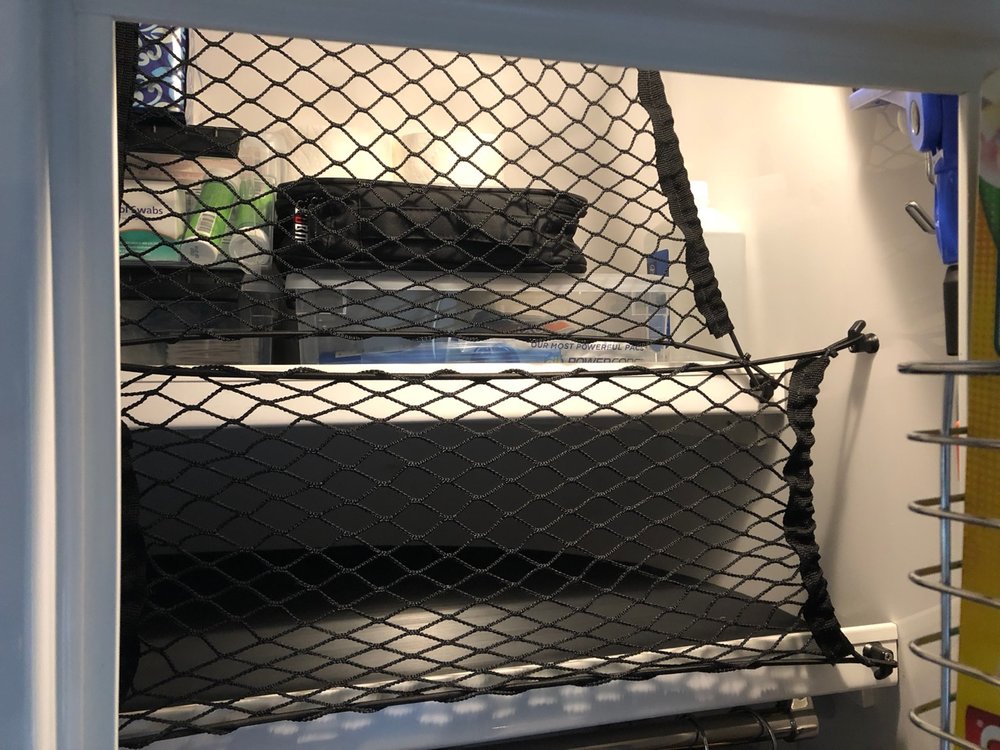

Someone asked about the cargo nets we installed. I bought several of these and two of these.  They're a bit expensive for nets, but they're well made, and most importantly, the only ones I could find in those sizes.  The smaller ones we have over the front door, over each bed, and then we also use two in the closet to hold in stuff on the shelves and one in the attic.  One of the long ones I put under the street side bed to stash shoes, and the other went under the attic - that one we use the least.  The one over the door gets hats and gloves and is the perfect solution for us for that stuff.  The ones over the beds get down jackets or maybe a sweatshirt and also gets overflow clothes storage from the cabinets above.  Under the attic is mainly a spot for day to day stuff that get's brought into the trailer, like maps and brochures.  I just like having a place for all of that stuff so it doesn't go onto the beds or countertops.  With such a small space to live in, I find that if there's a place for stuff within reach, then you'll use it and things stay pretty neat.

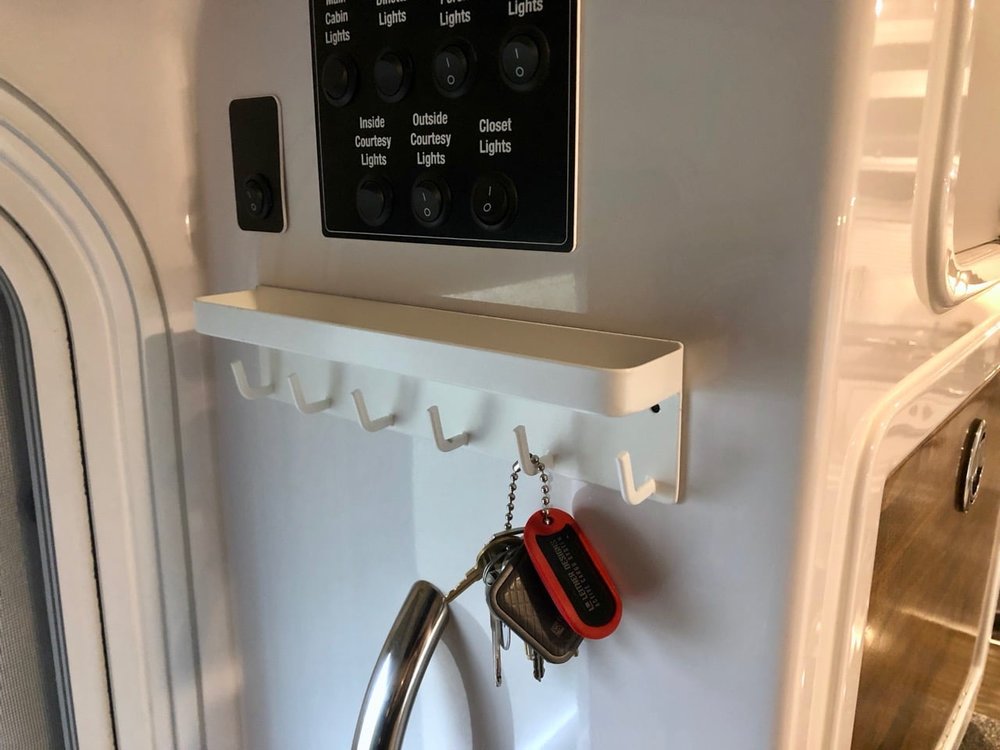

This key holder is great by the door.  We usually keep a flashlight on the shelf.

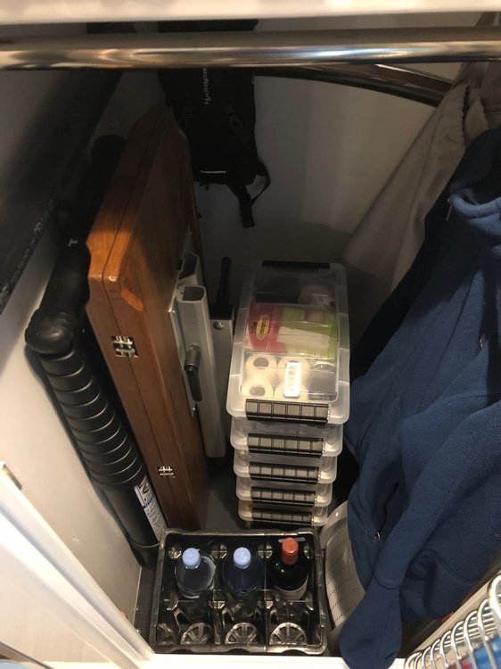

Most everything we store goes into these stackable plastic buckets.  They're small enough to fit places and to be able to see everything in them while still being large enough to hold stuff.  I wish I could find some a little smaller that would fit more efficiently into the upper cabinets.  Also, I noticed on this last trip that one of the handles had snapped so time will tell if these are rugged enough to last.

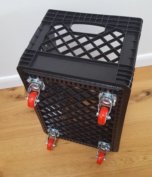

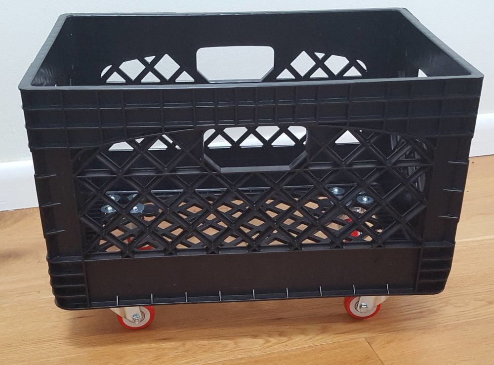

For basement storage, I found that the rectangular milk crates fit perfectly and really keep the basement organized.  In the very back, we have spare parts in several of the plastic boxes above, but in front of those you can slide one of these crates sideways, which will fill the back section of the basement and be flush to the corner of bed wall, and then two more will slide in lengthways to fill the front section of the basement efficiently.  One crate gets water hookups, one gets electrical, and the one in the back gets water filters and things we don't pull out often.  The plastic boxes are accessible from the interior hatch that we had installed under the nightstand.   Being able to just pull out the two crates in the front when we have hookups and working from them really beats sorting through stuff in the basement.  Our grey water hose and propane hoses go in the bumper. Chocks and blocks go in the bed of the truck, along with the grill, stove, fire bowl, and chairs.
  • 7 months later...
Following the milk crate suggestion for the basement above, is the attachment of some casters at all helpful? We're pickup up our TT in January: the casters raise the crate height by 2.75" and I'm not sure that it won't increase the difficulty of accessing crate contents via the optional inside hatch. We have an old boat hook to pull the crates out from the exterior.
