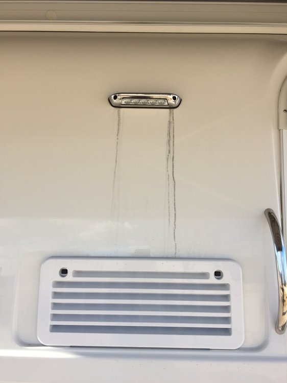

Moderators Mike and Carol Posted January 18, 2017 Moderators Share Posted January 18, 2017 The black gaskets around all of my porch lights bleed black whenever they get wet. Does anyone else have this problem? Considering they are fairly new and under cover when not out on the road it doesn't seem possible they could be breaking down already. Thoughts? 2 Texas Hill Country | Elite II #135 | Ram 2500 6.7L Link to comment Share on other sites More sharing options...

Tralien Posted January 18, 2017 Share Posted January 18, 2017 Hi Mike, we have the identical issue. With the recent rain storms here in CA I have those same streaks from all four porch lights. 1 Bob and Camille 2016 Ram 2500 6.7 Cummins 2016 Oliver Elite II - Hull#141 http://visitedstatesmap.com/image/AZCATNTXmed.jpg Link to comment Share on other sites More sharing options...

rideandfly Posted January 19, 2017 Share Posted January 19, 2017 Mike, We have the same issue with the Furrion gasket on the 110V external power receptacle. Looks like the gasket material sandwiched between the fixture & trailer hull is bleeding black. Different gasket material can be used that will not bleed and still seal. I will eventually cut a custom gasket to replace the Furrion gasket, but not until next month. Oliver could have fixtures supplied with different gasket material or have a gasket/seal vendor to cut custom gaskets in quantity with different material to stop the issue. We used to have custom hydraulic seals/gaskets cut in quantity for various applications, the cost was cheap, just required an extra step during the assembly process. Just a thought! 1 Tundra LE2 Link to comment Share on other sites More sharing options...
Moderators Mike and Carol Posted January 19, 2017 Author Moderators Share Posted January 19, 2017 I will eventually cut a custom gasket to replace the Furrion gasket, but not until next month. Bill, I have thought about making my own gaskets as well. Can't be too difficult, the old ones can be the template. Just need to have the right material. Let us know what you find, I'll be researching too. Mike Texas Hill Country | Elite II #135 | Ram 2500 6.7L Link to comment Share on other sites More sharing options...

KarenLukens Posted January 19, 2017 Share Posted January 19, 2017 If it's streaking then it's probably getting in between the walls. I would definitely seal it completely - https://www.amazon.com/2-8-Ounce-Silicone-Rubber-Marine-Sealant/dp/B000PSB1VY/ref=sr_1_5?ie=UTF8&qid=1484840675&sr=8-5&keywords=clear+rv+sealant Happy Camping, Reed & Karen Lukens with Riffles our Miniature Poodle 2017 Oliver Legacy Elite II Standard, Hull #200 / 2017 Silverado High Country 1500 Short Bed 4x4 Past TV - 2012 Mercedes-Benz ML350 4Matic BlueTEC Diesel Click on our avatar pic above to find the videos on our Oliver Legacy Elite II Link to comment Share on other sites More sharing options...
Moderators topgun2 Posted January 19, 2017 Moderators Share Posted January 19, 2017 OK, I think I've got it! The cause is "obviously" due to the "fact" that the odd numbered Olivers are the only ones that seem to have the problem - #'s 117, 135, 141, 147. Seriously, it is not the fasteners, nor do I believe that it is the car wash/rv wash that was/is used. Other than 4 days in New Orleans, my Twist has not been near the ocean (and I don't think that New Orleans should be considered as being near the ocean). Therefore, I do not believe that salt water caused (or is causing) this problem. The water here in western North Carolina has very few minerals in it at all, so, I do not believe that it is being caused by that. And, we all have some degree of "acid rain". Even if it is being caused by acid rain these gaskets should not "bleed" in this manner - the rubber on my car and truck doesn't. I'm convinced at this point that there is something wrong with these gaskets and they should be replaced. I'm a bit nervous about attempting the replacement myself in that the lights would have to be disconnected in order to get the gaskets off and the new ones on. In addition, while I assume that these lights are held on by screws, it certainly would be troublesome if they were bolted on. Finally, I can see no reason to suspect that these are leaking behind the lights. Bill 2 2023 Ford F150 Lariat 3.5EB FX4 Max Towing, Max Payload, 2016 Oliver Elite II - Hull #117 "Twist" Link to comment Share on other sites More sharing options...
Maverick Posted January 19, 2017 Share Posted January 19, 2017 Mike, We have the same issue with the Furrion gasket on the 110V external power receptacle. Looks like the gasket material sandwiched between the fixture & trailer hull is bleeding black. Different gasket material can be used that will not bleed and still seal. I will eventually cut a custom gasket to replace the Furrion gasket, but not until next month. Oliver could have fixtures supplied with different gasket material or have a gasket/seal vendor to cut custom gaskets in quantity with different material to stop the issue. We used to have custom hydraulic seals/gaskets cut in quantity for various applications, the cost was cheap, just required an extra step during the assembly process. Just a thought! We don't have the light fixture bleeding black issue but we do with the Furrion gasket on the 110 VAC external power receptacle. We have well water with conditioning and no other vehicles have this bleeding black issue. Horace & Dianne Chesapeake, Virginia 2016 Toyota Tundra Crewmax 4x4 Limited 2015 Oliver Legacy Elite II - Hull # 93 Link to comment Share on other sites More sharing options...
Moderators Mike and Carol Posted January 19, 2017 Author Moderators Share Posted January 19, 2017 Also, just spoke with Jason about the gasket causality and his comments on this issue. He stated that they have never seen this as a problem in Hohenwald with their water. His take is, as someone mentioned, maybe your particular location and the acidity of the city water/rain/sleet/hail. Also, salt in the air in locations close to shorelines. He also commented that in the past they have had Ollie owners come back to the factory with pitting of the exterior chrome light fixtures being in salt water vicinities. My hypothesis is probably due to salty air and lack of diligence to properly cleaning these areas after exposure on a nice relaxing trip to the beach. Rinse, rinse and more rinsing! Anyway, sorry for the rambling. Thanks, Malcolm M. Malcolm, thanks for mentioning this to Jason. My first streaking occurred at Land Between the Lakes just 2 days after pickup during a rain storm. No salt in the air between Hohenwald and LBL. We've never been to the beach or close to salt water or the coast. I wash it after every trip. Our storage is under cover. The streaking happens during rain or whenever I wash it. Maybe those of us with this issue need to let Jason know about it. The rubber gasket acts like it is old and deteriorating. Mike Texas Hill Country | Elite II #135 | Ram 2500 6.7L Link to comment Share on other sites More sharing options...

Moderators topgun2 Posted January 21, 2017 Moderators Share Posted January 21, 2017 In talking with Jason yesterday, he told me that the company that makes the "porch" lights is re-designing the gaskets. As soon as the re-design is done they will ship some to Oliver. Hopefully all of this will take place prior to the Oliver Rally in May. Bill 3 2023 Ford F150 Lariat 3.5EB FX4 Max Towing, Max Payload, 2016 Oliver Elite II - Hull #117 "Twist" Link to comment Share on other sites More sharing options...

KarenLukens Posted January 29, 2017 Share Posted January 29, 2017 We talked to Anita and she told us that those lights come with that gasket and yes it bleeds in the beginning, but it stops bleeding after it has been in use a while and it doesn't stain the fiberglass. She also said that if a problem like this gets posted on the forum, that they get blasted with calls about it for a short time and then it fades. Personally, after talking to Anita, it sounds like the same problem we had on our Casita. The simple answer is washing our trailer periodically as we all need to do anyway. You're going to get streaks down the sides of the trailer whenever it rains because it will be washing the dust and branches from the roof, from the roof to the lights, etc. The gaskets are new and need to go through a break in period and this is common with many rubber gaskets that I've used in the past. It forms a great seal but the rubber needs to cure in place and then seals and dries out over time in the sun and weather. We used Windex on the Casita to wash the heavy streaks from Cedar pollen, pine pitch, etc... and it really wasn't an out of the norm issue. Reed Happy Camping, Reed & Karen Lukens with Riffles our Miniature Poodle 2017 Oliver Legacy Elite II Standard, Hull #200 / 2017 Silverado High Country 1500 Short Bed 4x4 Past TV - 2012 Mercedes-Benz ML350 4Matic BlueTEC Diesel Click on our avatar pic above to find the videos on our Oliver Legacy Elite II Link to comment Share on other sites More sharing options...
Moderators Mike and Carol Posted January 30, 2017 Author Moderators Share Posted January 30, 2017 I emailed Jason and the he said the manufacturer is working on new gaskets. Mine bleed whenever wet, rain or washing. I washed it a few days ago after our trip west (when I took the picture) and had to go around after drying and wipe off the black. I do not believe it is a matter of breaking in the rubber and I do not believe it will go away with time. The rubber is acting like it is already old and deteriorating. When I rub my finger across the gasket it is not smooth like you would expect new rubber to be. Mike 1 Texas Hill Country | Elite II #135 | Ram 2500 6.7L Link to comment Share on other sites More sharing options...
rideandfly Posted January 30, 2017 Share Posted January 30, 2017 I emailed Jason and the he said the manufacturer is working on new gaskets. Mine bleed whenever wet, rain or washing. I washed it a few days ago after our trip west (when I took the picture) and had to go around after drying and wipe off the black. I do not believe it is a matter of breaking in the rubber and I do not believe it will go away with time. The rubber is acting like it is already old and deteriorating. When I rub my finger across the gasket it is not smooth like you would expect new rubber to be. Mike Mike, It rained on our Ollie during the last two weeks. It had a black streak below the Furrion black gasket on the 110V external power receptacle. Going to replace the black gasket with white gasket made with gasket material from McMaster-Carr during February. Will let you know how it works out. https://www.mcmaster.com/#standard-rubber-sheets/=15zaput 2 Tundra LE2 Link to comment Share on other sites More sharing options...
Moderators topgun2 Posted January 30, 2017 Moderators Share Posted January 30, 2017 I'm with Mike and Carol - I'm not in any way convinced that this is part of the "normal aging process". In fact, just the contrary - at first my gaskets didn't "bleed" and it was only after six months or so that I started to notice the problem that continues to get worse. I also do not believe that putting a bandaid over the problem is the appropriate solution. As I have stated before, the seals and gaskets on my car and truck don't do this. Bill 3 2023 Ford F150 Lariat 3.5EB FX4 Max Towing, Max Payload, 2016 Oliver Elite II - Hull #117 "Twist" Link to comment Share on other sites More sharing options...
