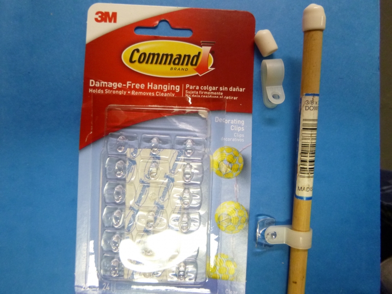

The frosted glass in the bathroom window doesn't do a lot of good when the window is open.  In thinking about that over the winter and seeing what I had laying around the workshop, I came up with an inexpensive easy curtain rod.  Using a 3/8 inch wooden dowel rod (cut it to whatever width you wish since the newer Elite II models have a slightly larger window) slide on two 3/8 inch plastic/nylon wire hangers.  On each end place a "Closet-Maid" large plastic end cap - these fit very tightly so it helps a bit to first round off the edges of the ends of the wooden dowel.  Finally, using "Command strip" decorating clips attach to the wire hangers - this takes a bit of fiddling in that these fit fairly tightly - and stick it to the wall.  Of course it helps to put curtain material of your choice on the rod first.
Bathroom curtain supplies
Cool, but I discourage the use of wood here. It will absorb water and discolor, maybe even mildew.
How about a section of aluminum or stainless tubing instead, or a fiberglass driveway reflector rod?

As John pointed out - a fiberglass or aluminum or stainless rod would have been nice, but, wood is what I had.  I did give it a coat of Spar varnish prior to installation and given that it really doesn't get wet I do not believe that the issues John sites will be a problem at all.

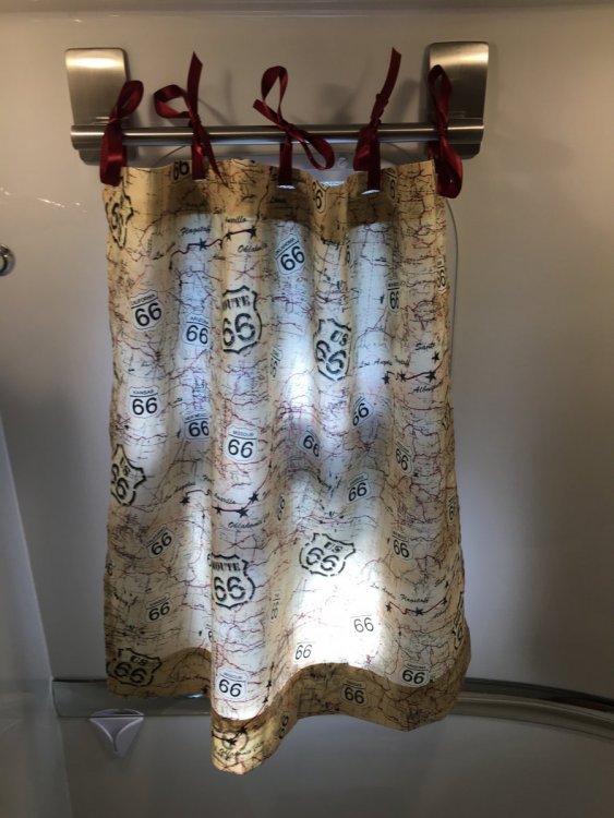

I appreciate Bill's suggestion I take a look at this thread on bathroom curtain rods and I wanted to follow up with our implementation.  We really wanted to have the option of opening the bathroom window while still maintaining privacy.  I did not want to drill into the hull and was able to find a 'command strip' option which seems to be working well.  After installing the curtain rod (which is plastic but looks like metal) Rebecca made a curtain and we now have privacy!  It is important to note that this is a command strip solution so it will only hold 3 lbs and the rod ends do not come off thus you can not side on a curtain but rather have to clip or tie it on.  It seems to be holding well and given the rod length did not encounter to much of the hull curve.  I have attached a few pictures.

Love the solution, and the fabric. Nice work!
