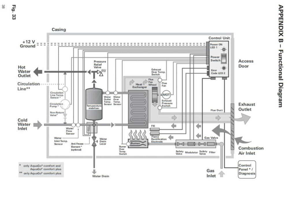

I used to run its big big brother, so working on it is pretty basic to me... It's a simple yet small water tube boiler, so as long as you keep the tube nest clean or free of scale in the pipes, not much can shut it down. Most people will only need to clean it every year or so, but it has a light to tell you when it's time. There's not much difference in the master controls between the 2, they have the same sensors and basically run the same. One just heats a big tank of water with a small flame, while the Truma heats a small amount with a lot more flame going between the tubes. It's a basic design that has been used for over 100 years, just not in this nice small package. It's a Smart boiler that is set up to tell you what is wrong with it when it has a problem.
