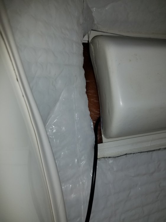

First of all we want to thank everyone for the very helpful advice. Second when you say tuck it to the hull under the insulation in the top rear cabinet do you mean under the mat like material at the bottom of the cabinet?
The silver faced insulation at the top - you should be able to pull it down easily.  From that point, if you choose to hardwire it, you can either use the 12v outlet in the cabinet using a cigarette lighter adapter, or you can tie directly into the 12v using one of the electrical sub panel circuits on the street side of the cabinet.  Undo the two bolts at the bottom of the side panel there and it will fall down to reveal the biggest mess of unlabelled wiring you've ever seen in your life.  Also access to the breakers and a negative bus bar which you can use for power.

Randy can we access the Oliver rear lighted sign from the attic? You then run the power line to the outlet in the attic?
Sorry about the delay.
I don't know if the newer trailers are still the same, the white plastic cover is plyable enough when warm, but can be pretty tough when cold.

Be sure to place the SPOT flat on its back, the antenna is under the logo and should face straight up for best performance, with no metal obstructions. In any location, test operation before closing things up.
I have a bunch of pics of the area at the sign, from my backup camera install. They can be found on that thread or I can repost them here ...
