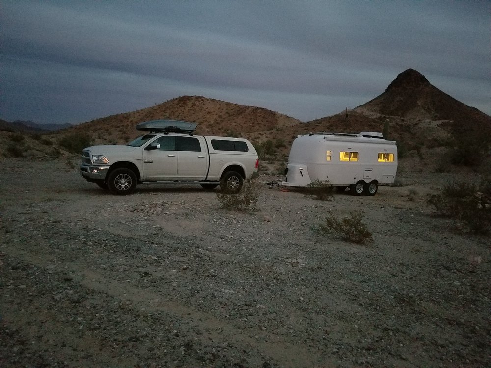

ccarole 1 Posted January 2, 2018 Author Share Posted January 2, 2018 Sorry I had two different posting for this content -- I was doing it by my phone and it got a bit tedious. Got everything worked out now so I can use my computer....... SO much easier! Hey so all is good now!! Thank you to everyone who has been so helpful. 1 - My Prowatt GFI needed to be reset at the main box under the seat.....finally figured out there was one there also. 2- Progressive surge protector will only illuminate if trailer is plugged in. I was beginning to suspect this but am not anywhere near plug-in. Jason from Oliver contacted me and confirmed. 3 - Blue Sky - My IPN remote was defective. Ryan at Blue Sky traded it out for me and it's working like a champ now!!! Love solar!! I hope posting all my naïve errors and the solutions will help someone else down the line. :-) Happy travels everyone! 2 Carole ....and a couple of Malinois 2016 Legacy Elite II #175 2016 Ram 2500 Link to post Share on other sites
ccarole 1 Posted January 2, 2018 Author Share Posted January 2, 2018 Carole ....and a couple of Malinois 2016 Legacy Elite II #175 2016 Ram 2500 Link to post Share on other sites
Moderators Mike and Carol 1,020 Posted January 2, 2018 Moderators Share Posted January 2, 2018 Nice photo! 1 Mike and Carol | Fair Oaks Ranch, TX | 2016 Elite II #135 | 2020 Ram 2500 Laramie 6.7L Cummins Turbo Diesel Link to post Share on other sites
ccarole 1 Posted January 2, 2018 Author Share Posted January 2, 2018 Why thank you. It's hard to get a bad picture of the Ollie.....it's just so darn good looking. ;-) Carole ....and a couple of Malinois 2016 Legacy Elite II #175 2016 Ram 2500 Link to post Share on other sites
