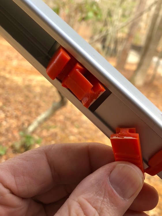

I was putting out the Carefree awning for the first time and as I was extending the arms to secure them to the trailer the orange clip that has tightens the are broke off.  Contacted Jason who immediately ordered me a new one at no expense even though the Carefree warranty doesn’t cover that part. Good outcome to a stupid issue AFF85570-580E-4A49-9CF4-C5D5D2CC285F.thumb.jpeg.084154ccef79f157ddbece48897bd4d4.jpeg

Yeah, the first thing I said to Ritchie when he was showing me how that clip worked was ,'That won't last.'.  They'd be much more rugged and sturdy with a screw to lock them in place like Fiamma uses.  But the flip lock is how they get the pole to recess into the front rail, since it's flush when closed.  I have to imagine that there's a relatively simple hack to fix this if we put our minds to it.
Interesting that Carefree doesn't warranty the one part that's obviously going to fail.
So did Oliver replace the clip, or did they have to get you an entire leg assembly?  I took a look at their parts list and didn't see that you could just get the clip.  If you can, and it's easy to replace, then I might get a few clips to keep as spares.
edit - I found the part, it's #R001657, available here.  Looks like you need to carry a rivet gun to replace it.
At Big Bend last month, I tried bypassing the legs with poles of my own.  It's not too much trouble to set up that way, and far sturdier than using the Carefree legs.  You just have to drill some holes into the bottom of the front rail to accept the poles...

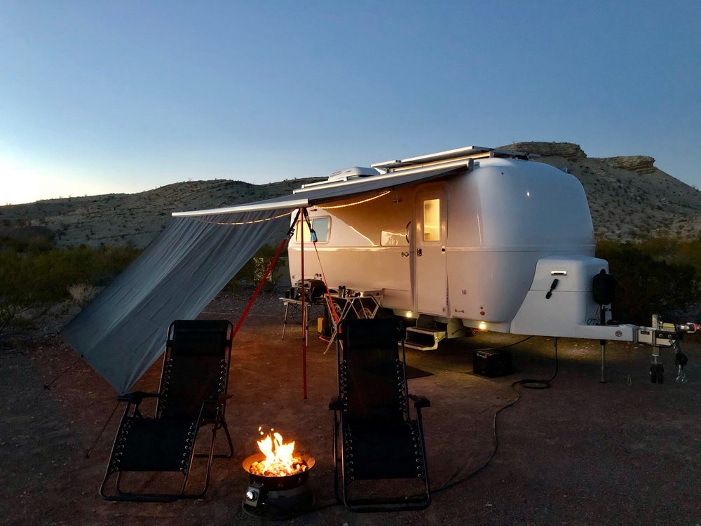

Overland, That shade screen attached to your awning looks very nice. How does it attach, and where did you get it? Nice picture!
It's this one on Amazon.  It was just a bit cheaper than the Carefree version.  It slides into the accessory slot along the front of the awning.  Seems well made and was a cinch to attach with two people - one person feeding it into the slot and another pulling it through.  I'm sure one person could attach without too much effort.  My only complaint is that it seems a bit too dark, but of course that's subjective.  But I do wish I could have found one in a light grey rather than black.  But it does it's job and should help keep wind from getting under the awning as well.

I haven't gotten the clip yet. Its supposed to arrive tomorrow and i think they are only sending the clip. Will keep you all posted> I obviously don't have a rivet gun so we shall see how i do the repair

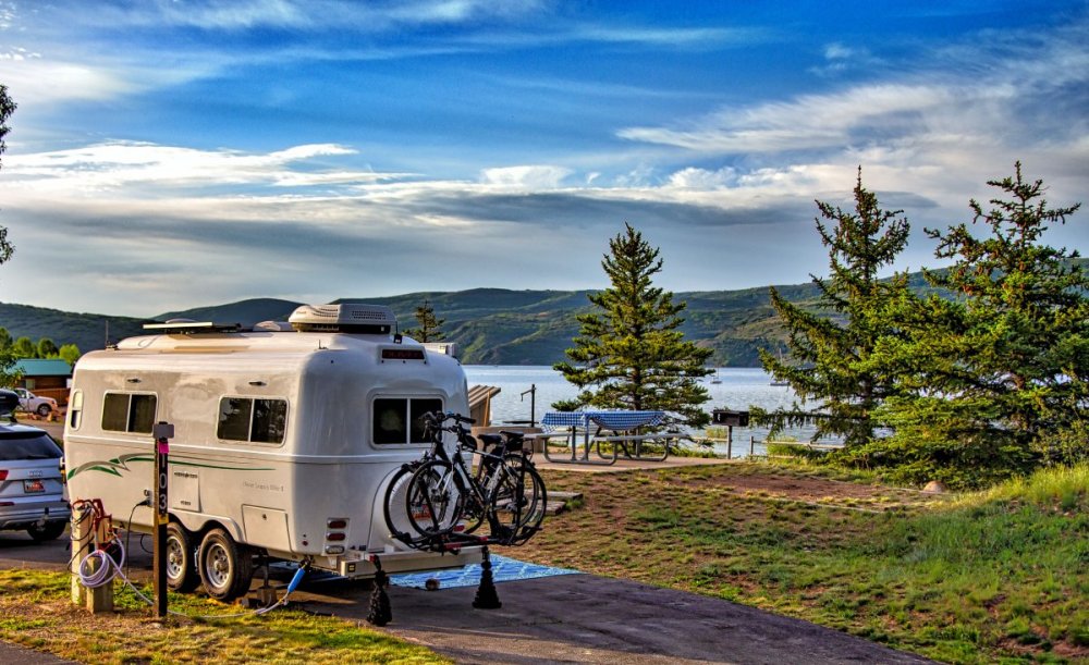

We were planning to visit Jordanelle State Park, near Park City for three nights.  The angle of the strong afternoon sun means limited shade protection under our awning, so we got the Tentproinc sun shade screen (the 6' X 14'3" size) that Overland recommended, and it worked well to increase our area of shade. We were worried that we would not like looking at the world through the mesh, but it was actually pleasant, even cooling, to look through it.

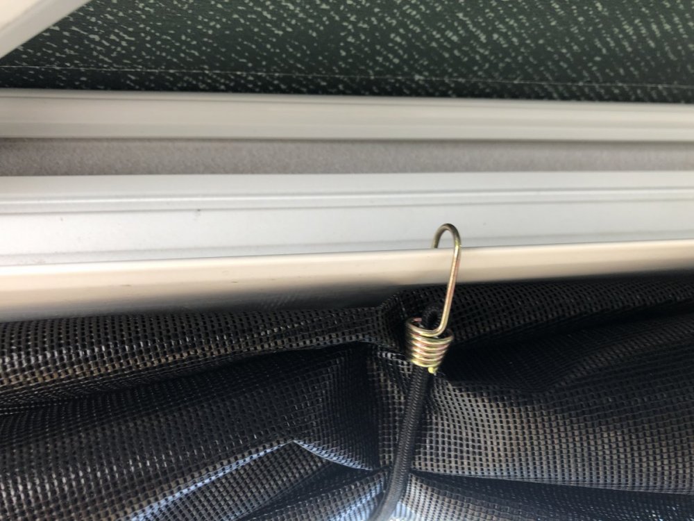

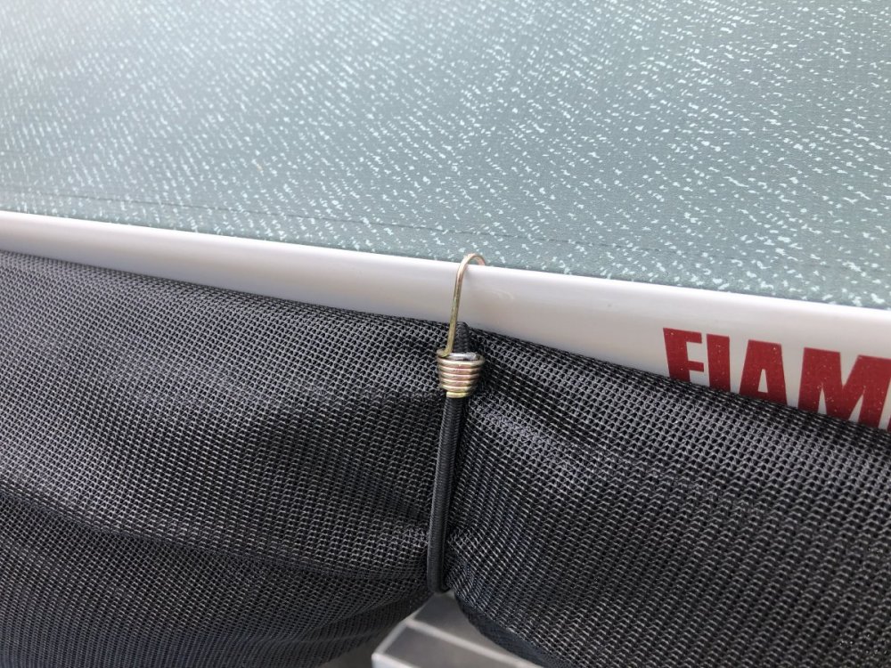

There can be gusty winds, and we always stow our awning when leaving camp or before bed. While it was not hard to attach or remove the shade screen from the track in the awning front bar, I did not want to have to do this once or twice each day. So I left the shade screen attached when I rolled in the awning. Unfortunately, the hanging shade screen creates one serious obstacle, at least if I want to open the trailer door. So I used these 10 inch mini bungee cords to attach the shade screen to the awning front bar. And, I can open the trailer door.
Jordanelle State Park was really nice, and we will visit again!

My clip broke- after only a few uses - Oliver replaced it - now I treat it with extreme care - it is fragile - should be a machined aluminum....
