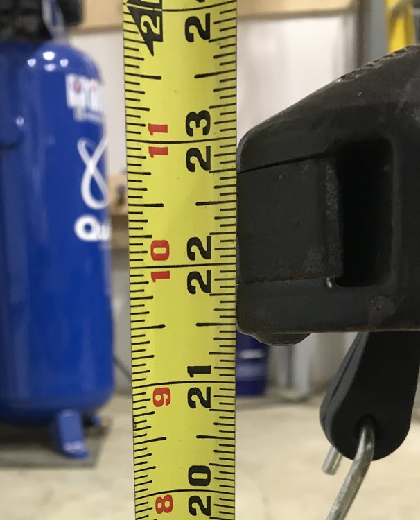

My 2018 OEII is sitting level on a level shop floor. Here is a picture of the hitch. I would say 23.5 inches from ground to top of a 2 inch ball would be correct.

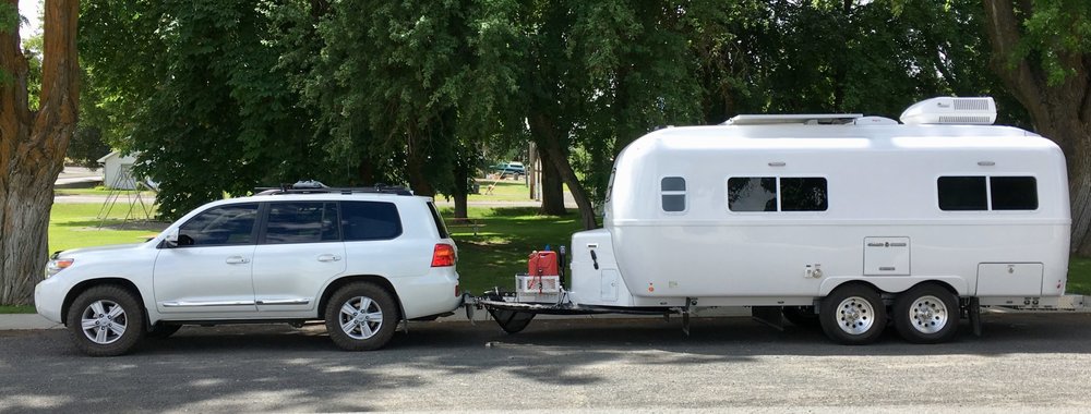

Our 2016 Toyota 5.7L 4X4 Tundra's top of ball to ground measurement is 22.5" before connecting to Ollie. Ollie's tongue weight is around 450lbs and trailer weight (empty water tanks) about 4950lbs without WDH in this photo. We keep Ollie's weight low by transporting extra gear in the pickup bed and pickup's back seat area. Most E2s ready to camp weights are heavier than our Ollie.
