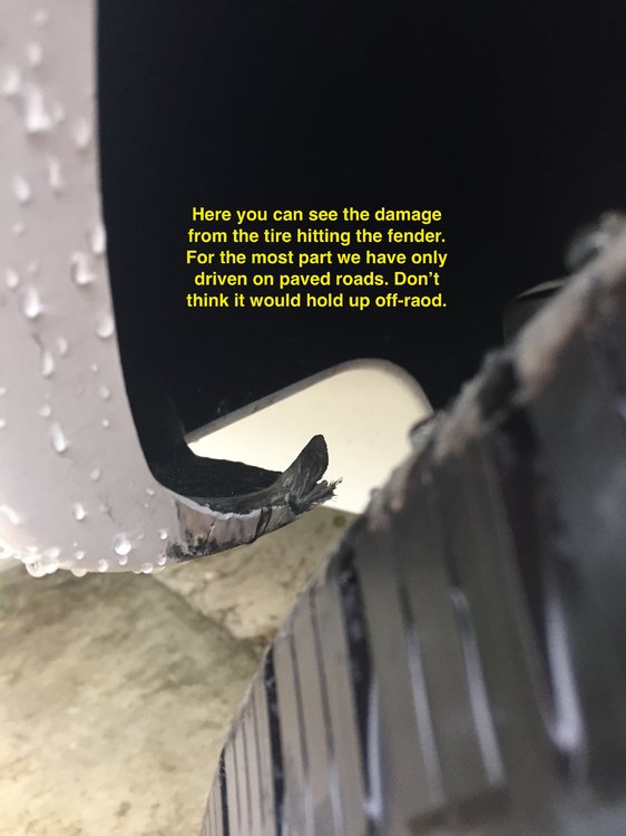

I wish Oliver would make a kit for these or made them integrated into the over all fender well.  I cant do what you did until I solve a bigger problem but sure like your work.  Our 2017 Elite II, Hull #227 was one of the first to get the larger rims and tires standard which are great but, when I added on the E-Z Flex Suspension System as an option, the geometry of the wheel fender changed and is off-center now.
[attachment file=Oliver Fender.jpg]
[attachment file=Tire and Fender.jpg]
The bigger rims & tries with the E-Z Flex push the entire wheel assembly forward and out of center in the fender wells.  What this does is put the tire less then 2" from the fiberglass.  I have already had to replace one fender do to the tire hitting it and tearing the whole fender off.  I showed this to Scott Oliver at the Rally and he had not seen it before.

Foy, that looks just so very wrong to me! And totally unacceptable. Are both sides like that, or just the left one?
My suspicion is there is a manufactureing defect in the subframe, one or more hangers are mislocated, or more likely, the entire subframe was positioned too far forward on the frame rails. Either way, Oliver owes you some serious shop time to fix it.
On “Mouse” the left jack is positioned almost an inch further back than the right, but the suspension is centered under the fenders. There is zero contact between tire and fender.
Please start a new thread about this and report back when it is sorted out.
