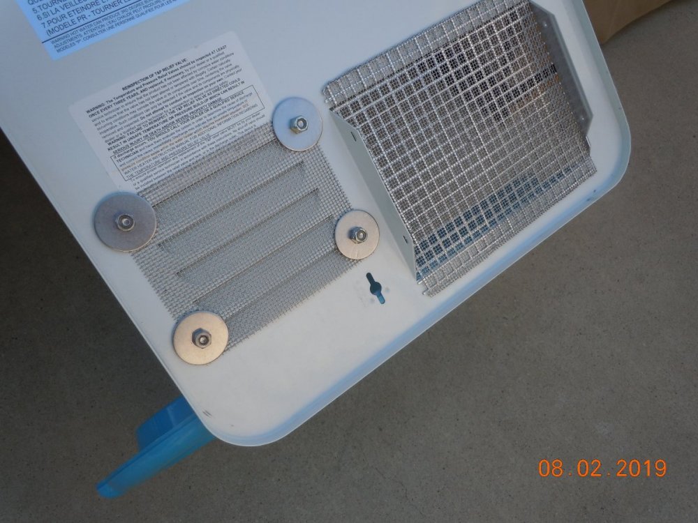

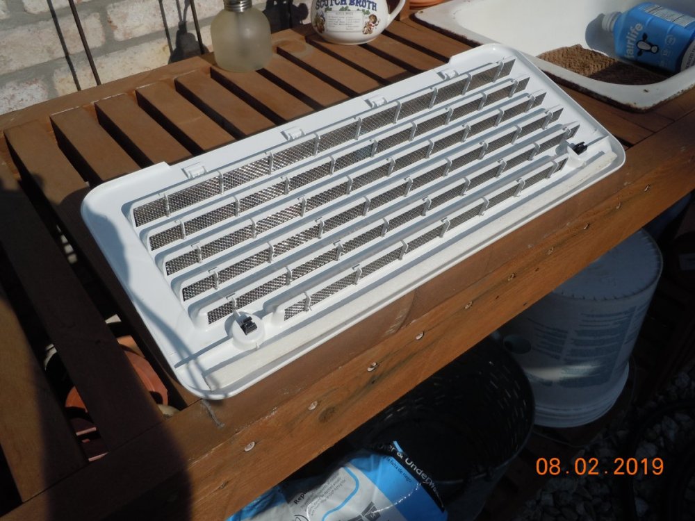

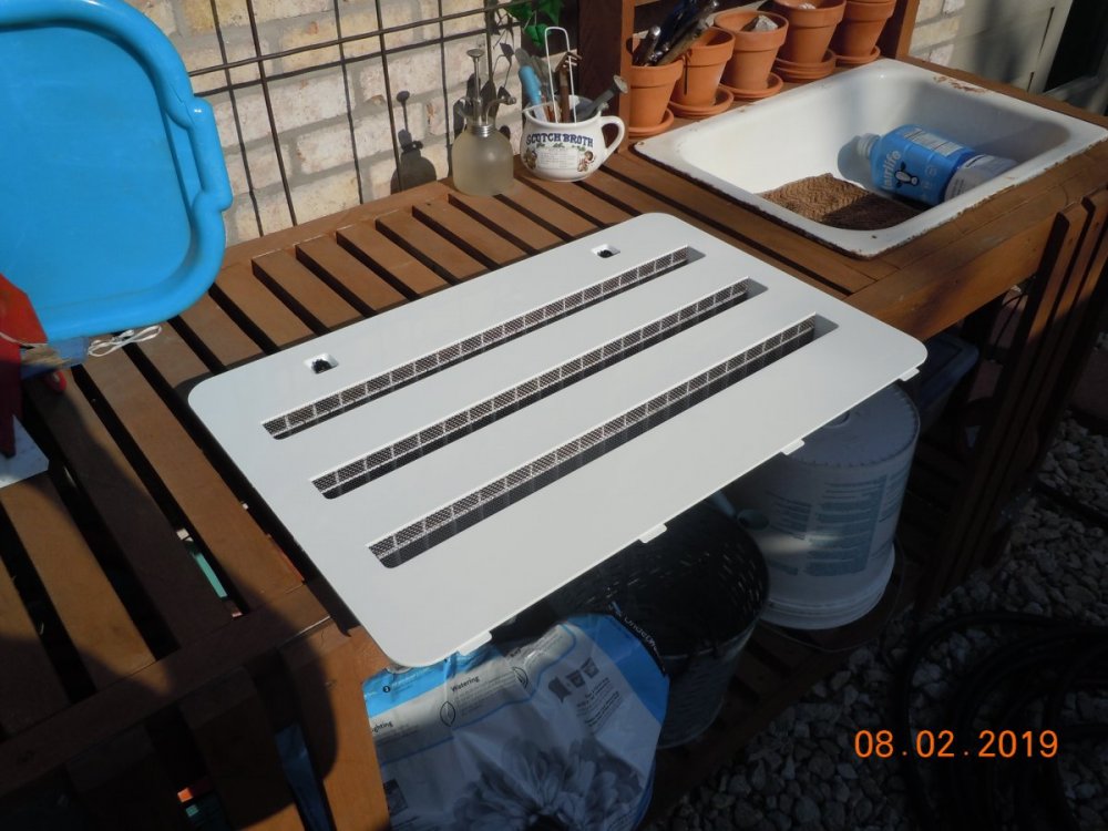

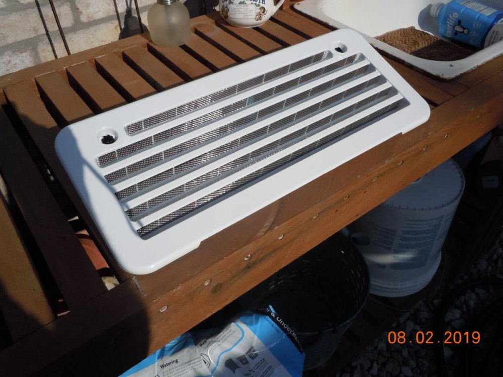

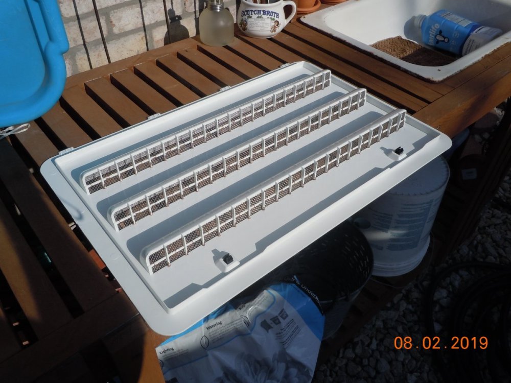

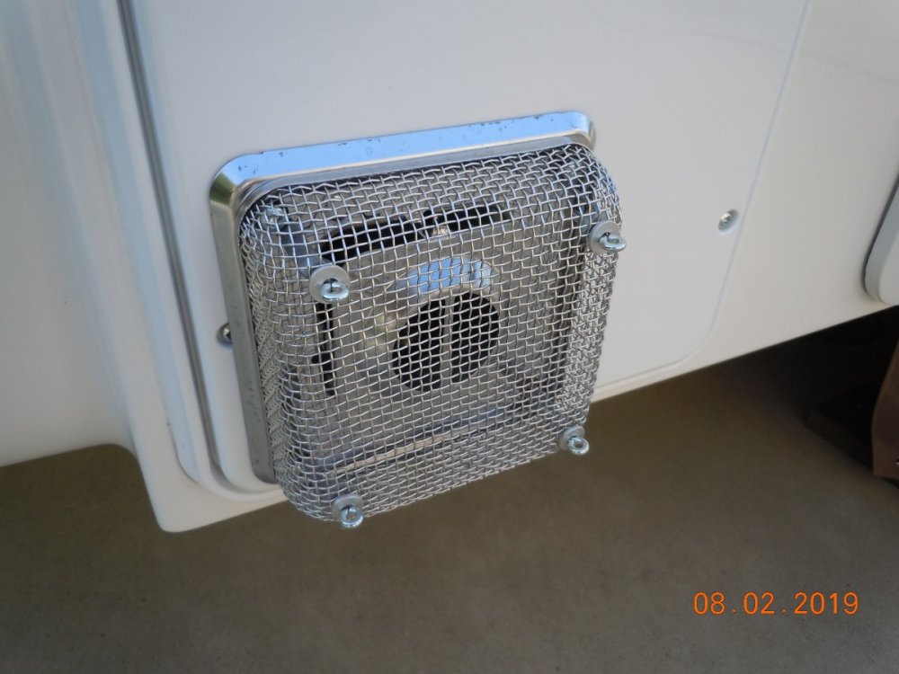

Pics of my bug screens that is made,  I purchases a mesh screen from Amazon and cut it to fit where it was needed, then I took stainless steel wire and wired the screens in place on the refrigerator vents, the water heater vents screens were installed with stainless steel nuts and bolts. The furnace screen was purchased from Camco. Due note here that window screen material may work, but I found it to be too flexible and I used a stiffer wire mesh for a much better material to work with. It took me a day to do this and I had already done this before on our Casita, so I had some experience in doing this, cutting and fitting will take time to do the job correctly and with a professional look.

Trainman, that is beautiful work. Do you have an Amazon link to share for the screen? What is the mesh size and is it stainless?
In regards to your water heater screens, I wouldn't hesitate to use a strong adhesive sealant to bond the screen to the inlet side. The outlet side runs much too hot for that.

Yes indeed very nice work Trainman it looks better than factory. Thank you for the photos a real plus. I have read others have used hot glue or silicone to secure the screens. I like your idea of a SS wire install since you can remove the screen much easier if need be and it’s just a very seamless clean finish. Well done.

John, I couldn't find the exact item I purchased on Amazon, it was two years ago, it was a two pack, 22"x22" and 12 holes per inch, stainless, nice stiffness to work with and I cut it with tin snips. This is as close as I could find, https://www.amazon.com/Woven-X60cm-Coarse-gauze-Stainless/dp/B01N4RCHFU/ref=sxbs_sxwds-stvp?crid=2TB5WP8VAGXPQ&cv_ct_cx=stainless+wire+mesh&dchild=1&keywords=stainless+wire+mesh&pd_rd_i=B01N4RCHFU&pd_rd_r=0747b075-0572-49a2-b5ac-03427d1b9482&pd_rd_w=3kc4Q&pd_rd_wg=HcgJq&pf_rd_p=183579a1-f0e6-4556-8e39-8fe08e8f8141&pf_rd_r=Z1JE72FRXHZTFB9QNK7T&psc=1&qid=1587303256&sprefix=stanless+wire+mesh%2Caps%2C179&sr=1-131-dd5817a1-1ba7-46c2-8996-f96e7b0f409c  due note here this material is 10 holes per inch, but I did measure mine and the hole openings are right at 2mm. Make sure you get material that is long enough to cover the longest opening on your refrigerator vents, I didn't want to piece mine together. I did think about using an adhesive on the heater screens, but just went with the stainless NBW's as I have a good selection of them. I did also make a totally different system to attach the Camco screen to the furnace, I just didn't like dealing with those springs, and went with my own design which will screw on and off.
I've been struggling (thinking too much) about how to attach the Camco furnace screen.  The springs simply don't work as you mentioned.  Looks like you fabricated a brace to connect to the screws holding the furnace cover on and then connected the screen to the braces?  Tough to see what you did in the picture, but I'm sure interested!  Thanks!

NCeagle - I used four pieces of fine SS wire. Looped it through the screen back out to a fastening point on the screen twisted it together snug and snipped the excess wire. Done. You would have to look hard to see the wire.

I took four brackets that I purchased at a hobby shop that sells model airplane stuff, although any strip brass or metal should work. I bent the ends at a 90 degree angle, one to the right and one to the left and drilled holes there the put the screws through.  On the inner part of the bracket I just removed the factor screws and mounted the brackets, on the other end I used JB Weld and glued nuts to the brackets, then I had some 4-40 screws that were looped on the ends and I just hand tighten them through the screen to tighten up the screen grill. I know this sounds like a lot of work, but I found it rather easy to do as I'm a hobby modeler and it was just another project. So far it has not come loose in the two years it has been on there. Here is a pic, it should show what I have done, any questions just ask. Other grills done with mesh wire I got from Amazon and cut to fit.
