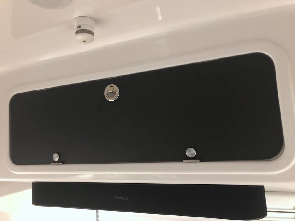

Overland Posted January 4, 2019 Share Posted January 4, 2019 Thought I'd try taking another photo to see if it would show the matte black better - this is just generic black spray paint applied to the back of the frosted door. I still get some light around the edges at night, but it's much better than before. I have some additional equipment in there with LEDs that make it a bit brighter than stock. I could probably experiment with some weatherstripping to see if I can get it all blocked. I think you could use any color, so long as you covered it with vinyl to make sure no light gets through. I told my wife that I might paint each door a different color and she threatened to hide the keys. 1 1 Link to comment Share on other sites More sharing options...
Moderators topgun2 Posted January 5, 2019 Moderators Share Posted January 5, 2019 Overland - Exactly what did you use for the vinyl on the back of the doors? How did you get the vinyl to stick - spray glue, contact cement? Or, did you just use "Contact" paper to start with? I'm thinking about covering the back of my mirrored doors with clear "Contact" paper. Guess I could use a patterned "paper" but I happen to have some clear on hand that I've been using for laminating. Bill 2023 Ford F150 Lariat 3.5EB FX4 Max Towing, Max Payload, 2016 Oliver Elite II - Hull #117 "Twist" Near Asheville, NC Link to comment Share on other sites More sharing options...
Overland Posted January 5, 2019 Share Posted January 5, 2019 Search for Oracal 651 vinyl on Amazon. It’s utility grade vinyl used by sign shops, often as a mask for sandblasting. It’s thicker and much more protective than the stuff they use for actual vinyl graphics. Very similar to contact paper but it has a stronger adhesive. 1 Link to comment Share on other sites More sharing options...
