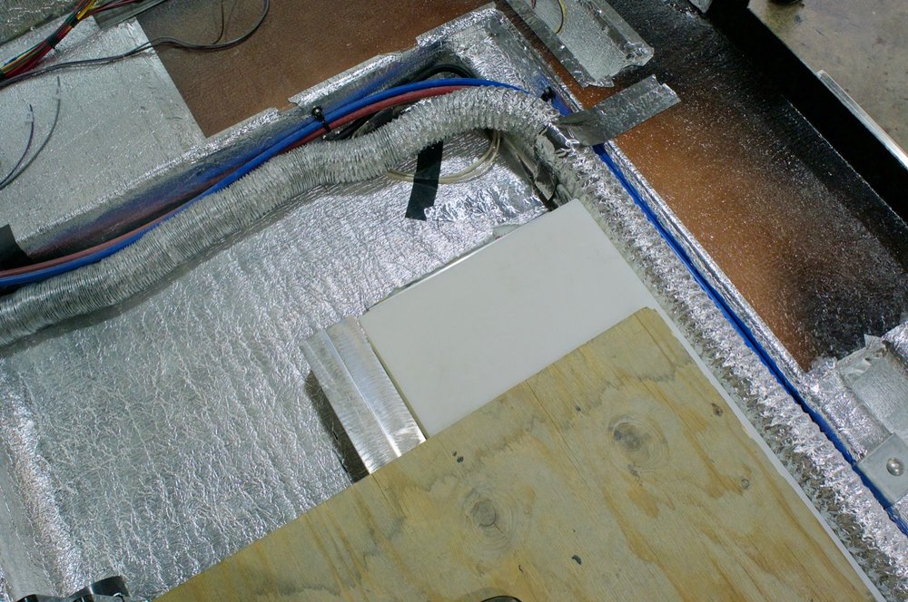

Overland Posted February 9, 2019 Posted February 9, 2019 That's the best I've got. You can open up the access hatches to try to get some airflow between the hulls and then crank up the heat. If you have a fan you could try to fit it in the forward dinette hatch and direct some airflow that direction. Here's a photo of where the water lines run. You can see that they're right up against the heat duct, so I still think that with time it will thaw. Door would be in the upper right, closet middle top and shower to the left. [attachment file=_JDA3205.jpg] Curious that Oliver runs the water lines on the outside instead of sandwiching them between the air duct and water tank. Always the possibility that it's something other than a frozen line, but it seems unlikely. 1

Overland Posted February 12, 2019 Posted February 12, 2019 I missed that thread. Did you ever try John's idea about testing it with the dinette hatch open? If not, I may try that myself when I get a chance. I suspect, however, that the airflow would go counterclockwise, around the back of the tanks, since the space under the front entrance is mostly blocked (see the photo above). That might help keep the plumbing in the rear street corner warm but wouldn't do anything for the closet corner. I think the ideal spot for the return air would be beneath the closet door, with a duct in the closet channeling it down between the hulls. Then the air would come right down over the water lines and then travel the long way around the trailer, keeping the entire space warm. Alternatively, cutting the duct in that location would accomplish a similar airflow, and with warmer air. It would also give the benefit of positive pressure between the hulls, which would discourage the furnace from drawing outside air in through the weeps, as it surely does now. You lose the bath vent, of course, and it would be more difficult to regulate the air to the cabin. Details. It also seems like a ton of heat is lost into the back curbside corner from the furnace and plenum, both of which are completely uninsulated. That keeps the water pump area toasty of course, but it seems like some of that heat would be more useful elsewhere. It might be worth adding some insulation around the furnace as an experiment. In short, I think that there are some definite avenues for finding more efficiency in the system - it's just up to one of us owners to find the time and energy to put towards it. 2
