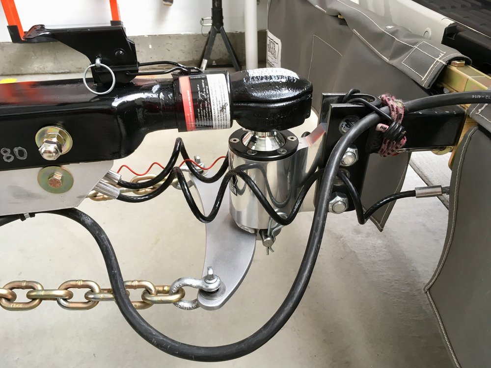

Hey Steve, I know this is not where I should ask this question, but I do not know how to start a new discussion on the forum. The ladies brought me the Oliver with the cable attached for towing. They did not use the chains. Is it your choice to use either cables or chains or are you supposed to used both? I have never hooked up a camper in my life, so was just wondering. Thank you.
Nan, We are in Bangkok at the moment. You should use which ever is attached to the trailer currently; cables or chains. You do not need both. I removed the cables from our trailer and replaced them with heavy duty chains. To me, they are easier to hook up than the stiff cables.

I’m a bit confused by your question. Do you have an Andersen hitch? If yes, the chains are part of the hitch and must be used. If you are talking about safety chains they also must be used. Not sure about the “cable” you’re referring to unless it is the breakaway cable for the trailer brakes. If you could post a picture of what you’re talking about it would be helpful.

Hi Nan,
Hope all is well. My wife Cheryl and I met you at the rally back in May. If you have the Andersen hitch option, the Andersen hitch has the 2 long, heavy weight distribution chains that run from each side of the frame of the Oliver to the “whale tail” bracket that is on the bottom of the hitch ball. The Oliver also has 2 thick heavy duty safety cables mounted to the Oliver frame that have to be hooked to the tow vehicle. Your tow vehicle should have large hooks, loops or brackets on either side of the hitch receiver to hook the safety cables to. And these thick safety cables should be crossed under the hitch when they are connected. Meaning the safety cable on the right side of the trailer should connect to the hook on the left side of the tow vehicle, and the safety cable on the left side of the trailer should hook on the right side of the tow vehicle. That way they cross under the hitch, so if the trailer comes un-hitched while towing, the tongue of the trailer will be caught by the safety cables instead of dropping all the way to the ground. Many states actually require that the safety cables (or chains) be crossed. Older Olivers had safety chains but the newer ones have the thick safety cables instead. The Andersen chains AND the safety cables should all be used. There is also a small cable that is the breakaway switch cable that will activate the trailer brakes if it becomes completely disconnected from the tow vehicle. This breakaway switch cable must also be connected to the tow vehicle by hooking to one of the brackets on either side of the hitch on the tow vehicle. Hopefully someone who currently has their trailer connected to their tow vehicle can post a couple pictures.
Nan, you should have documentation for the Andersen hitch, if not go here and look at the FAQ and other info. I believe your tow vehicle is a late model Tundra, is that correct? If so you probably need to set the chains with a small amount of compression on the big red bushings (item 13). Proper setup including ball height is important so that it works as intended. The Andersen comes with a big 1 1/4” special deep socket that you should have received. You must use a common 1/2” drive ratchet handle to turn it.

Nan, just my 2 cents on this, the cable safety cables that come with the Oliver's today are hard to use and for myself I found them bulky and hard to hookup (stretch out) and then release. I also switched them out for chains after our first camp outing. I have no idea what I will use the old cables for, maybe to stretch barb-wire on the pasture fences.
trainman
That’s a bigger size coupling and Andersen ball than you have, and the newest style whaletail, but the older 2” ones hook up just the same. You must lower the open coupler onto the ball, latch it, and then lift the ball and entire back end of the truck up several inches using the electric jack to slacken the chains and make it easier to slide the whaletail in place on the extension below the ball. Once you do it a few times it will get easier, but it is always going to be a bit of a pain, there is no way around that. If you hitch up in this manner, hopefully you will not have to fuss with the big socket and adjuster nuts too often....
The black coiled cables are to catch the trailer if it should become disconnected. I have no trouble hooking them up.
The small red coiled cable is the electric brake safety switch lanyard, that will apply the brakes full hard if this happens. It should ideally clip onto the truck hitch receiver, not the hitch itself.
The intent is to prevent your disconnected trailer from becoming an uncontrolled projectile that could hit other vehicles. It would mess up your trailer and truck but hopefully not kill a bus load of people.
Thanks everyone for all of the helpful information. Hopefully I will have time Sunday to try to hook the trailer to the truck. The ladies brought Hull 267 to me on a Friday and I had knee surgery on Monday, so have not been able to spend much time with it. I may be wrong, but I don't think any chains were hooked up, just the black cables that are in John's picture.
