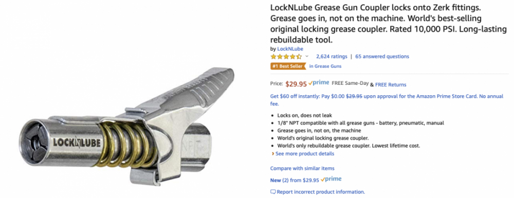

DavidS Posted October 31, 2019 Posted October 31, 2019 In an earlier thread, Raspy suggested the Lock N Lube fitting. I bought one for $30 from Amazon, and it has made the job easier. 2 2 David Stillman, Salt Lake City, Utah 2016 Oliver Elite II Hull 164 | 2017 Audi Q7 tow vehicle. Travel and Photography Blog: http://davidstravels.net

nrvale0 Posted November 2, 2019 Author Posted November 2, 2019 Hey, folks. Thanks for the ideas. Particularly on raising the front axle. Don't know why I didn't think about that at the time time except that I was probably distracted thinking about ways to NOT lay on the ground due to those goat's head thorns. 😉 I have a LocknLube coupler but it doesn't have a 90deg on it. The LnL actually works against me in trying to get to that top zerk because it extends the length of what is non-flexible at the end of the flexible hose. Not sure if the 90 is worth the $60 but if I can't find another option... I'll be rolling again tomorrow so I'm going to try to stop on some asphalt and use the levelling blocks to see if that makes up the difference. Will let you know. As to greasing intervals, yes, the Oliver folks said 3k miles. I'm a bit over on that equalizer zerk due to not noticing it on my previous go-around.
