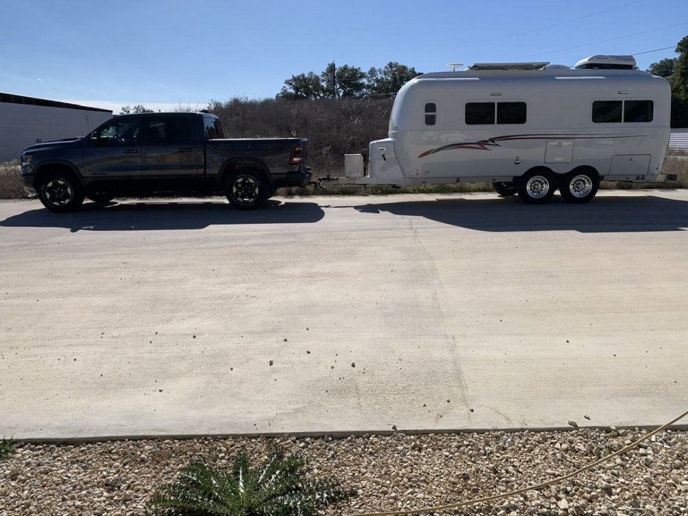

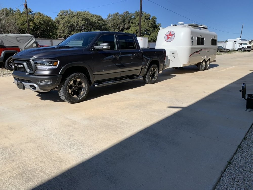

As you know we pull our Oliver with a 2019 Ram 1500 4x4 and I very happy with the way the truck handles both with and without the Oliver attached. The only advantage that I liked with the 2500 was that I wouldn't have to use the Anderson WDH. As of today if I had to replace the Ram I would probably still go with the 1500, as I have yet to see any drawbacks on the 1500 and towing the Oliver. One thing in today's world is the Big Four are building 1/2 ton pickups that can handle so much more today then they could just a few years back, five years ago I would have got a 2500 for sure. As far as tires go I will replace mine with a truck type tire when the time comes.

Yep.  I’ve got well over 50K miles towing my Oliver with my current Ram. No problems!
