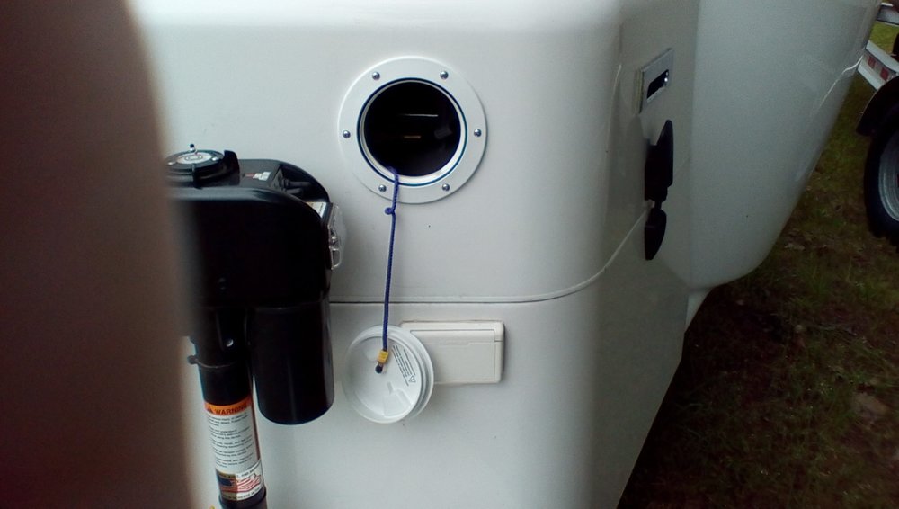

We used a piece of "parachute" cord. It happened to be bright purple. After that we put on a crimp-on 12 v electrical fitting. The one with the hole in it. Our hatch was self installed (just before Oliver made them standard). Ours has a place to put a small screw through the electrical piece and into the hole in the cover. The screw isn't fetched up tight so it can swivel. Also the cord can twist and not bind. One of the nuts holding the hatch on was loosened and another crimp on was added. After crimping the fitting we heat treated (melted) the nylon cord and as it melted it swelled so the fitting couldn't slide off.  Without this tether I am sure the cover would be sitting on the edge of a back road somewhere.
There might even be a picture on here someplace awhile back. My pictures are on another device and the Oliver is in a line to get the Dexters checked.
Here's a pic of Mainiac's mod which I copied after he posted it back in 2017.
