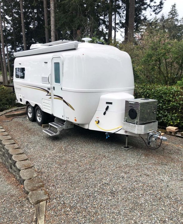

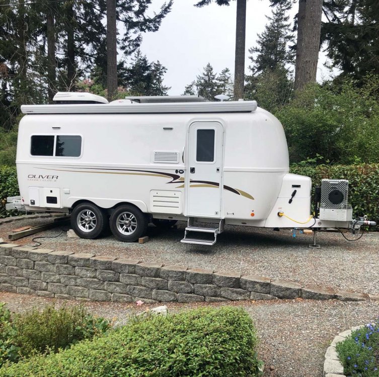

There are so many great projects on these forums that I felt obligated to document mine (partly so that others can avoid my mis-steps!).
We dry camp the majority of the time. During the winter (until the snow flies) that is not a problem, but summer time on the Eastern side of Washington State can be uncomfortably hot. When we bought the Ollie we knew that the solar system would take care of most of our needs, but that we really wanted a generator capable of running the A/C. We specified the optional soft start add-on for the A/C so that the trailer would be ready. A bit of research showed that the new Honda 2200 would run the A/C, even if it was running on propane.
We chose “Hutch Mountain” as the best propane conversion for the Honda 2200. After 10 years of putting generators into and out of the truck I knew that some kind of generator carrier attached to the trailer was a must-have. We chose “Generator Box” as they have one sized perfectly for the Honda 2200. I asked Hutch Mountain if they would do their magic by installing all needed gear inside a Generator Box. They said they would be glad to do so. I had “Generator Box” directly ship the box to Hutch mountain. They did an install and then shipped to us. Perfect !! I did the install of the Hutch Mountain conversion kit into our new generator. BTW Honda service centers get very twitchy about propane conversions. There was/is a recall of a circuit board in the 2200. My local shop will do the recall, but will not even start the generator afterwards. I may have to school them about modifications NOT invalidating an entire warrantee. In my case the engine is now out of warrantee, but the generator section is still fully covered (federal law on this subject is well established).
We bought the storage box on our Ollie. I wanted to save as much space in the box as I could for lightweight things, so I designed a frame to support the Generator Box. I initially intended to have the box dropped down into the storage unit by about and inch and a half. That was a bad idea as the latching assembly which secures the box to the mounting plate will not operate with more than about 3/8” of drop below the edge of the storage box. I used aluminum flat stock and 70 durometer Sorbothane to raise the box and give a little vibration dampening.

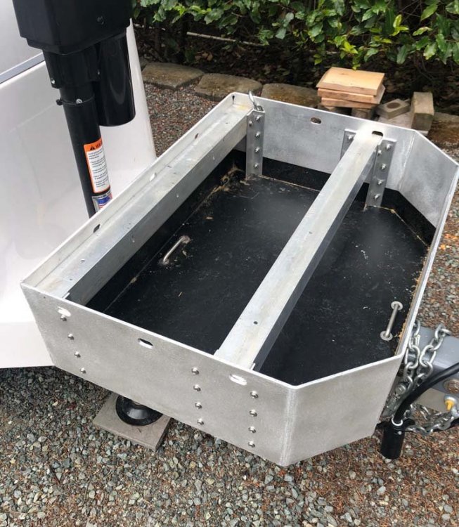

Parts list, purchased or modified by me:
Honda 2200 Companion generator to get the 30 amp locking connector
5 feet of aluminum 2” C-channel, ¼” wall thickness
5 feet of aluminum 1½” angle
10 1” SS ¼” x 20 screws with NyLock and two flat washers each
6 1½” SS ¼” x 20 screws with NyLock and two flat washers each
30 1” SS 10x32 screws with Nylock and 2 flat washers each
I made a 69” section of Marinco 10 ga power cord
Hutch Mountain made a 69” connection hose to hook-up the front end trailer propane supply to the Generator Box quick disconnect.
Pictures follow…
Any questions, please ask!
Bill and Dorothy
  • Thanks 5

What do you plan for that area below the steel tray? Access appears to be limited - it appears to be about a 6 inch gap. It would be great for wood blocks, if you can reach back far enough.
What was your reason for keeping the Oliver tray rather than just mounting the new tray directly onto the tongue, (to save a little weight and lower the generator)?
Are there drain/ debris holes in the bottom of the Ollie tray so gunk doesn’t get trapped there?
Do you plan to make a dust cover for the generator box? It is a pretty messy location normally.
Please post a followup report after using your generator for a while. Thanks.
Edited by John E Davies
When we had a 30ft SOB (Some other brand) camper I had a custom tray welded to the tongue and used two LowPro Lockdown plates to mount our Honda Companion Generators to the front of the camper.  The setup functioned quite well for the occasional dry camping that we did.
Noise was not really a problem for us, but the camper had a front bedroom and the vibration was enough to keep us awake.
How much vibration does this setup transmit to the camper?  Is it noticeable?
Bryan
- I have only tested for 2x8 in one foot pieces, and 4x4 in eight inch pieces. Pretty much takes anything I would want to tote there!
- I wanted the tote space. The generator box height was a concern, so I made a cardboard mock-up and tested the idea on my boss. (She said it looked great...)
- There is a 3/8" drain hole in all four outside corners of the storage unit.
- The box is water tight, and I have made it Yellow Jacket tight by pop riveting bronze screen over all the vents. I am going to wait and see if I have to come up with a dust solution...
- It is going to be a couple months before I tow the unit. I am determined to wait-out the idiots in Seattle/Olympia who objected to $35 Tabs (for the 4th time now). I will register/license the unit once the courts get off the dime and make a decision. Or.... if the lock-down goes away, once I get bored out of my skull.
