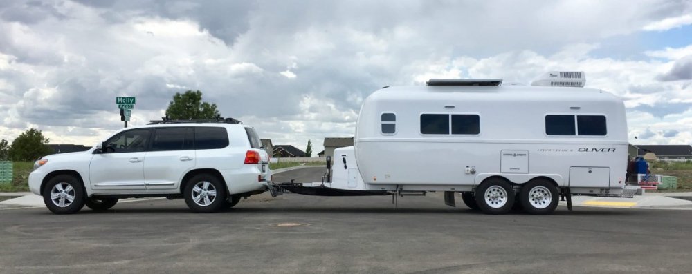

We just purchased hull 64 from Michael and elizabeth and are very excited to get started with our ollie adventures. We are Kimbellee and Kevin from Birmingham, Al.  We have been silently following oliver for a couple years now and Michael's trailer is just perfect. I Look fw to sharing more on these forums and they were great theoughout the process. My initial question if someone reads this is if there is an optimal hitch height for the ollie when loaded to the hitch. I am pulling with a 2013 land cruiser and andersen hitch on 64. I feel like I may be a little high on the hitch at the moment but am not experienced on what exactlh to look for.

Your trailer looks perfect, but your 200 looks slightly butt low. There is not anything you can do with your hitch to fix that, but a set of Firestone inside-the-springs rear airbags inflated enough to bring it level, (10-12 psi) help significantly in terms of stability. Here is “Mouse”, it is dead level but the pic shows a little camera lens distortion. This is with 33” tires on the 200.
Checking an Ollie to see if it is level can be tricky, the frame structure in back kind of droops and it is deceptive. Use the front part of the frame and the belt line as a visual guide.
Plus, if you haven’t already done so, switch out the squooshy OEM style tires to firmer LT tires. The ride will suffer a little, but towing is MUCH more secure, and you will be much less at risk of a flat on rough roads.

Your safety chains are too long and should be shortened significantly, so that you have minimal loops hanging down, and they should crisscross under the ball, to act as a safety catch if the attachment should fail. You can droop a bungee cord over the tongue and hook onto the chains to help hold them up.
Also, your trailer harness is vulnerable. The 200 has a wierd location for the socket, as you no doubt know, and this loop is prime for catching on a road hazard and ripping clean off the trailer. Ouch. I run mine on top, secured with a bungee to eliminate slack under the bumper, plus I leave a horizontal loop so that the cable doesn’t stretch tight in a hard jackknife turn. This also takes most of the strain off the fragile little plastic hook that keeps the plug in the socket.

Like John said, your trailer looks good but the cruiser does look a little low in the back.  It looks like you have an adjustable hitch so maybe try tightening up the Andersen a bit more and then if that brings the trailer tongue up too much then go a notch or two lower to compensate.

I believe the question was the optimal hitch height? My manual states the optimal height should be 22 1/2" to the top of the ball, with the TV ( tow vehicle) level..

That is a fine figure to use when initially choosing a hitch, but in the real world the entire rig should be pretty much level , or perhaps a little high at the TV, with a typical “traveling load” of fluids and gear. For example, I always try to tow with full fresh and empty grey tanks. Also, that number is for a standard sized ball, if you use a bigger ball and coupler, obviously the parts at the hitch will be higher. So run what looks good to you.....
