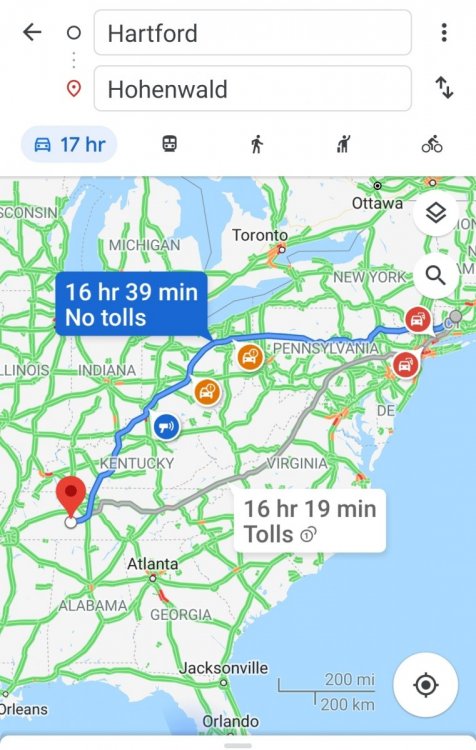

Moderators SeaDawg Posted August 22, 2020 Moderators Posted August 22, 2020 (edited) I'd probably compare your pickup situation to ours. We had my brother with us, and my 2005 Silverado truck only has two seats. We took the Volvo xc90 to pick up our Elite shorty. We were at 70 per cent or so capacity. And an underpowered t5. (We bought the ram a few months after the Oliver.) Difference is, going home, we were going downhill, pretty much, to Florida. You'll have to go uphill to Connecticut. . But, you can choose your route. Were it me, I'd go the toll free route, Tennessee, Kentucky, Indiana, and avoid West Virginia and those major hills, with your smaller truck. Then, you can decide if stopping every 150 to 200 miles for gas is OK with you, and having to plan around mountains is ok. We've done both routes with my 2005 Silverado. And, with the 2008 Ram. And, I've driven both with other trucks, and rvs. Take your time. Don't spend a ton on upgrades til you decide you want to keep the little truck. But, many times, the best tow is the one you already own, for picking up. Let's you know if you are happy, or unhappy, and what you want. If, when you get home, you'll do mostly local camping, you'll be golden. I wouldn't want to tow to Alaska with a small truck and small tank, personally. Or even into the Rockies. My thoughts, only. Good luck, and, enjoy your new Ollie. Sherry Edited August 22, 2020 by SeaDawg 2008 Ram 1500 4 × 4 2008 Oliver Elite, Hull #12 Florida and Western North Carolina, or wherever the truck goes.... 400 watts solar. DC compressor fridge. No inverter. 2 x 105 ah agm batteries . Life is good.

Landrover Posted August 23, 2020 Posted August 23, 2020 2 hours ago, SeaDawg said: Ps, neither route is without challenges, with a small truck. You will probably want to do the airbags, but that's relatively inexpensive. And the Anderson, for sure. Sherry Yes a good route you don’t want the more southern route through NY or Washington. A nightmare and expensive toll route. 1 Grant 2022 GMC Denali 2500 HD 2019 Elite 11😎
