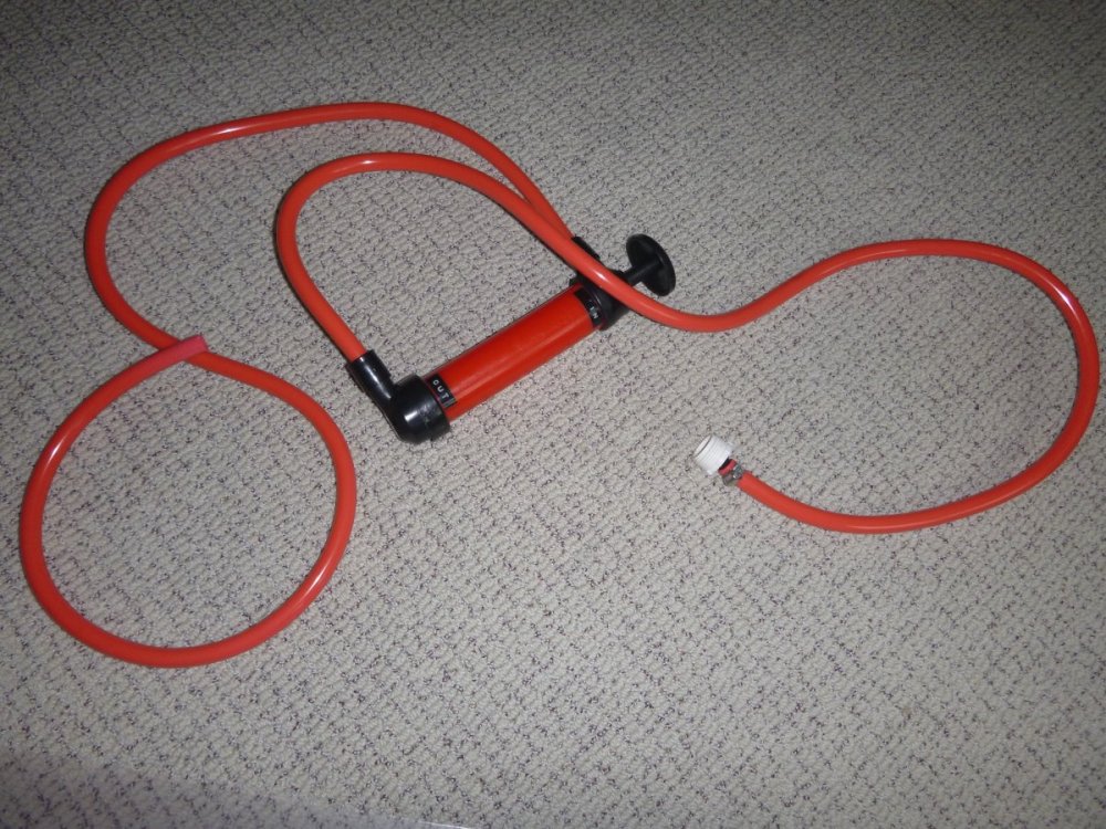

Moderators topgun2 Posted August 30, 2020 Moderators Posted August 30, 2020 Its getting to be that time of year when we are starting to think about winterizing the Ollie. Certainly it is easy to winterize using the port at the rear of the Ollie but an often overlooked past of the process is putting a bit of antifreeze in the other three ports - City Water, Fresh Water and Black tank flush. This is also easy if you use a hand pump - https://www.amazon.com/Horusdy-transferencia-combustible-multiuso-líquidos/dp/B075C3NNZF/ref=sr_1_7?crid=1TBR3DRPDJK7&dchild=1&keywords=liquid+transfer+pump+manual&qid=1598820277&sprefix=liquid+tran%2Caps%2C180&sr=8-7 But, these pumps come with both the intake and output hoses simply cut off at the ends. Buying a plastic fitting with one end barbed and the other end compatible with the ports on the Ollie really simplifies the entire process. Simply insert the barbed end of the fitting into the output hose on the pump, secure it with a clamp and you are ready to go. Screw the fitting onto the Ollie port, place the other end into the antifreeze, give the handle a couple of pumps and you are done with that port. Bill 2 2023 Ford F150 Lariat 3.5EB FX4 Max Towing, Max Payload, 2016 Oliver Elite II - Hull #117 "Twist" Near Asheville, NC

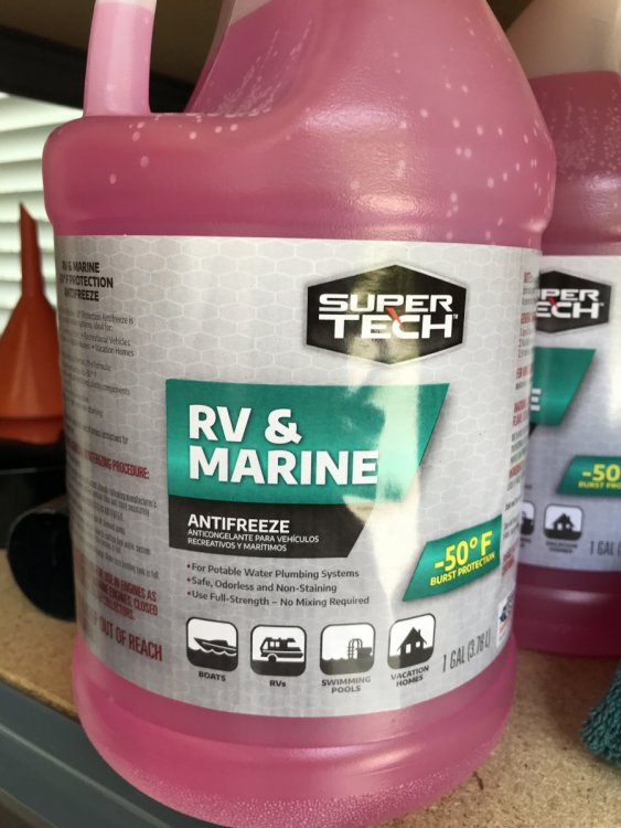

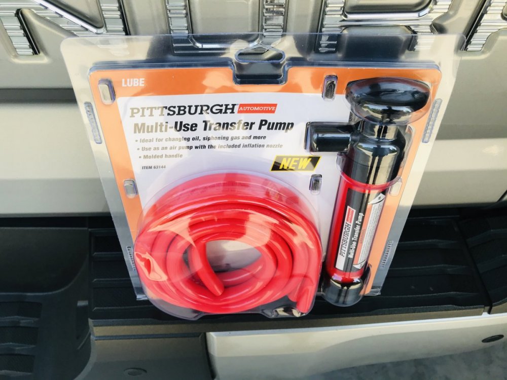

Patriot Posted August 30, 2020 Posted August 30, 2020 Great suggestion Bill, Another hand pump option from Harbor Freight - $5 with a 20% off coupon. And Super Tech RV safe anti freeze- $2.58 a gal at Wally World. 2 2020 OLEII - Hull #634 aka- “XPLOR” TV 2021 F350 6.7 liter Diesel Lariat Ultimate Tremor aka - “Beast of Burden” Truma Aventa 13.5 AC, Alcan 5 leaf pack, Alcan HD shackles & HD wet bolts, 5200lb never lube axles.XPEL 10 mil PPF front both front corners, 30 lb LP tanks, Sea Biscuit Front Cargo Storage box. ⚡️⚡️11/2025- Lithium upgrade to XPLOR - (2) Epoch 300ah Lithium batteries, Victron 3000W MultiPlus-II, Victron GX Touch 70, Victron Cerbo GX, Victron Smart Solar MPPT, Victron Smart Shunt, Victron Orion XS 1400 DC-DC charger, RV Soft Start. Zamp 90W suit case solar panel for 420W of solar.⚡️⚡️ North Carolina

Moderators topgun2 Posted September 19, 2020 Author Moderators Posted September 19, 2020 Susan - For that price you can buy a bunch of the Harbor Freight pumps and a couple of the more expensive threaded fittings I mention above. Bill 1 2023 Ford F150 Lariat 3.5EB FX4 Max Towing, Max Payload, 2016 Oliver Elite II - Hull #117 "Twist" Near Asheville, NC
