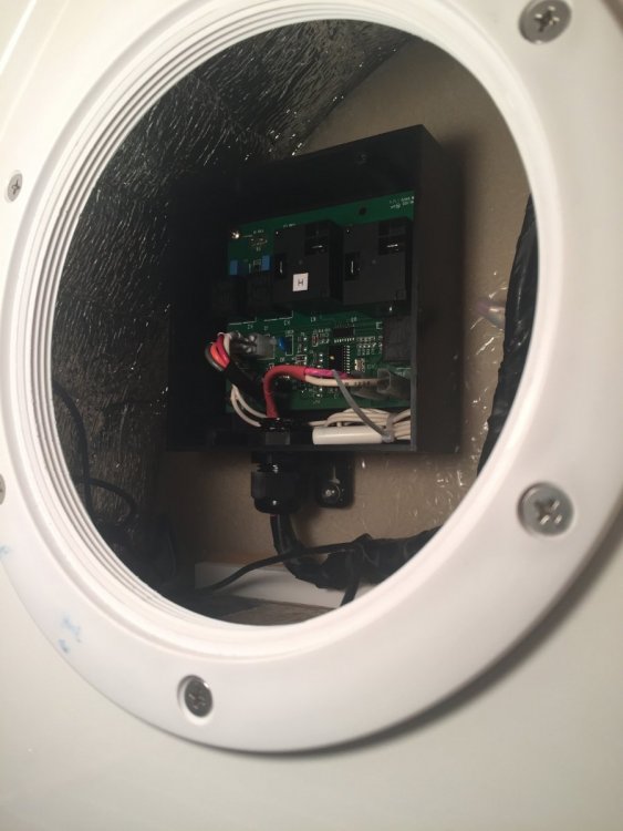

Minnesota Oli Posted May 27, 2021 Share Posted May 27, 2021 On 4/9/2021 at 3:37 PM, Minnesota Oli said: I will chime in because I went with Dicor lap sealant non leveling. I applied it to the under side of the outside mount frame and put it in the opening with four bolts in place. Then I put the inside mount frame in place and hand tightened the nuts with very little force. This assured me the all was lined up properly. I smooth out what squeezed out by dipping my finger in water and forming a bead around the frame. I let this sit for 24 hours before installing the ac. When I torqued the bolt to 9 ft lbs I looked up on top and saw a couple spots where my formed bead had some small bulges but I'm satisfied that I have a good seal. When time permits I'm planing to write up my version of this AC install. My version of Houghton AC install. Start out by cutting 120 volt power to AC and 12 volt power to furnace. Next remove the plenum of the Dometic Penguin II on the inside of the Oliver. This will expose a group of wires that are in a black sheath, these are the control side of the wiring for the AC. These go to a LCD relay board that controls Cool/Furnace/Heat Strip that is mounted up in the AC. You will also see a metal electrical 4" x 2" Handy Box that will have the 120 volt power supply for the AC. Both sets of wires can then be disconnected and the four bolts holding the AC on can be removed, this allows you to remove the AC from the roof of Oliver. The Houghton AC will not be using the Dometic thermostat that's mounted on the wall because it comes with a remote but your furnace still needs the wall thermostat which works with the LCD Relay Board. I wanted to preserve my old AC with the LCD relay board intact for resale, so I purchased a replacement board mounted it in a plastic box. I installed it in the area where my tank monitor is with the access through pantry. Where I disconnected the control side of the wiring harness from the AC I then connected wires long enough to be routed back to the new LCD relay board that is mounted next to the pantry. I then connected those wires to the relay board. One other item is the relay board has a freeze sensor that needs to be hook up or you will get a error message. That sensor is mounted in the cooling fins on the AC, so I had a temp sensor left over from a refrigerator repair I did a while back and that worked as a replacement. The Houghton comes with a roof mount frame, this gets a sealant applied to the under side of it and that is set in the opening in the roof, I used Dicor Lap Sealant. The roof has a slight radius built in to it to help shed water so the flat roof mount frame will tend to teeter in the opening. I applied the sealant to the under side of the outside mount frame and put it in the opening with four bolts in place. Then I put the inside mount frame in place and hand tightened the nuts with very little force. This assured me the all was lined up properly. I smooth out what squeezed out by dipping my finger in water and forming a bead around the frame. I let this sit for 24 hours before installing the ac. When I torqued the bolt to 9 ft lbs I looked up on top and saw a couple spots where my formed bead had some small bulges but I'm satisfied that I have a good seal. I made the 120 volt connection to the AC with waterproof connectors and discarded 4" x 2" Handy Box so I would have less obstructions in the air passageways. I also used aluminum foil tape to smooth the transition between the two mount frames. As a sidenote halfway through the install I thought of a different way of doing the wiring for the thermostat. If a person replaced the LCD thermostat with a older manual style you could do away with the LCD relay board. If you look at the first picture that shows a group of wires that are in a black sheath, these are the control side of the wiring for the AC. In that group of wires there are two blue wires one with a white stripe. The one with the white stripe is hot 12 volts DC and the solid blue is the wire that goes to the furnace relay board. So re-allocate the existing thermostat wires by doubling them up ,two of them hooked to the solid blue and the other two hook to the blue with the white stripe. Then at the wall hook the two thermostat wires that are hooked to blue with white stripe to the power in on the new manual thermostat and the other two to the power out. The reason I would double them up is because of they're small gauge. This would do away with having to pull wires and using the LCD relay board. Also save you having to toggle through the unusable modes (heat strip, cool) on the LCD thermostat to get to the furnace mode. I am very pleased with the sound levels of this AC, you can easily have a conversation between two people without any difficulty of hearing each other. Plus it also has heat mode and dry mode. I should have done this write up sooner when it was fresh in my mind. Oh well. Paul PS I also installed the Micro Air EasyStart. I wanted to ensure that my Honda 2200 would be able to start the AC from eco- mode. You can see from the pictures it was very tight space to mount the unit. The captured inrush amps before installation was 67.1 and 48.9 after install. 5 2 Link to comment Share on other sites More sharing options...

Ocala Guy Posted July 2, 2021 Share Posted July 2, 2021 Minnesota Oli I am in the process of changing from a Dometic A/C to the same unit you just installed. I see you also installed the easy start for your unit. Can you maybe provide a wiring diagram on your install? It looks like you may have made brackets to hang the easy start on? I see a junction box for the wires. Did you add that? I installed the easy start on my last a/c but it had a diagram to follow. I don’t want to screw up a new a/c so I would appreciate your expertise. Thanks. Thermostat issues for heat can be resolved using a Honeywell Pro TH 1100DV1000 thermostat. Intercept two wires that come from the furnace to the Dometic a/c control box and use two of the wires that go to the current Dometic digital unit and attach them to the Honeywell unit. The Honeywell uses double A battery that you change once a year. The thermostat just makes and breaks the connection when you call for heat and the Honeywell unit is not very expensive. 1 3 Link to comment Share on other sites More sharing options...
Minnesota Oli Posted July 2, 2021 Share Posted July 2, 2021 Ocala Guy If you go to Micro Air Easy start website, they have resources on how to install their product plus specific schematic for the Houghton AC. Print them off for reference when installing. Under the hood of the Houghton space is limited, you can't see from the pictures but there are two electrical boxes, one on each side of the insulated portion of the AC. Looking at the pictures, the enclosure that has the lead wire from the Micro Air soft start going to it contains the capacitor you will need to connect to. You will also have to run wire to the other enclosure to connect the black wire from Easy Start to the switched-L-1 connects coming from the main control board or main contactor that connects to the compressor common terminal wire. I chose to make a shorter wire run directly to compressor just in front of the over load protection devise. For mounting the Micro Air I used Velcro but added two straps made from banding to help support it since it was hook to Styrofoam. Paul 2 1 Link to comment Share on other sites More sharing options...
