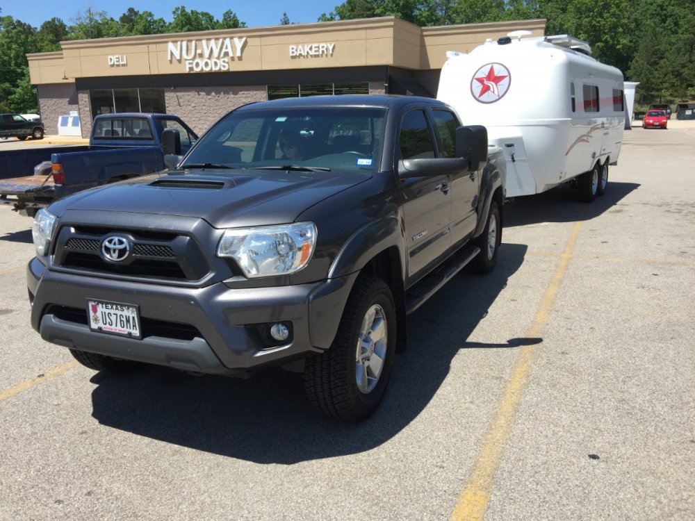

Moderators Mike and Carol Posted October 9, 2020 Moderators Share Posted October 9, 2020 Do a search for Tacoma’s. We towed our Elite II with the previous generation Tacoma. We were traveling fairly light and had the TRD Supercharger. We upgraded to a half ton because the gas tank was small and the drop in gas mileage meant we had to get gas way too frequently. We also wanted to carry more stuff for extended time on the road and the Tacoma was limited on payload. Texas Hill Country | 2016 Elite II #135 | 2020 Ram 2500 6.7L Link to comment Share on other sites More sharing options...
