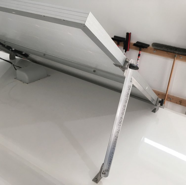

John E Davies Posted October 17, 2020 Posted October 17, 2020 (edited) Does anyone in snow country tilt their solar array toward the sun? This will keep most of the snow and ice off. The lower panel may get obscured by snow buildup, but the top one should remain fully clear and operating normally at full output. It takes just a few minutes and $10 worth of aluminum to make strong support arms. I recommend lowering them back to the normal position when a strong wind storm is coming..... and no, I have not actually tried this. “Mouse” lives inside. John Davies Spokane WA Edited October 17, 2020 by John E Davies SOLD 07/23 "Mouse": 2017 Legacy Elite II Two Beds, Hull Number 218, See my HOW TO threads: Tow Vehicle: 2013 Land Cruiser 200, 32” LT tires, airbags, Safari snorkel, Maggiolina Grand Tour 360 Carbon RTT.

Mainiac Posted October 17, 2020 Posted October 17, 2020 3 hours ago, John E Davies said: Does anyone in snow country tilt their solar array toward the sun? This will keep most of the snow and ice off. The lower panel may get obscured by snow buildup, but the top one should remain fully clear and operating normally at full output. It takes just a few minutes and $10 worth of aluminum to make strong support arms. It just so happens that when we park our unit it faces almost perfectly North and South. So with the panels being flat they catch the morning sun, the noontime sun as it passes over head, and the afternoon sun....all 7 hours or so. We probably also have more unexpected wind than sun, so being flat works, for us. Now an automatic tracker for the panels might be nice, but I have yet to exceed my power needs. 1
