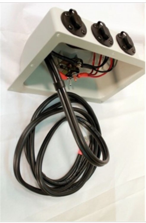

JD, I saw a statement today indicating that MC4 connectors should never be used inside a vehicle.  They did not elaborate on their point of view, but it made me think about your desire to eliminate the Zamp roof cap SAE connections.  I think you could replace the SAE port with a stainless fender washer and gasket and mount a bulkhead MC4 connector to it.  Just thinking out loud!
This thread really motivates me to add solar to my 2019 LE2. Mossemi has already giving me plenty of advice and recommended a good book on the basics. My trailer came with the panel wiring already in the walls. One end of the wire is bundled under the street side bunk and it is also visible passing through through the area behind the stereo and then continues upward to the roof somewhere between the hulls.
My biggest unknown is exactly where is the top end of the panel cable located on the roof between the inner and outer hulls. I don’t have an opportunity to get a close look at another Oliver with solar already installed.
Can anyone shed light on how to locate the top end of the wire and where to drill the hole for the port.
You will need to use a sound generator/toner to locate the wire.  It will be approximately 17" to 18" forward of the Maxxair fan and off set to the street side a few inches.
I can provide you with more detail and direction on the complete install.  If you would like to discuss further, please PM me with your contact information.
