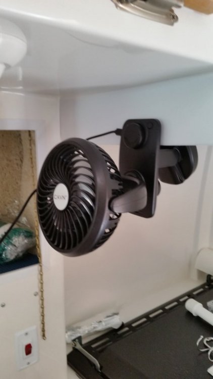

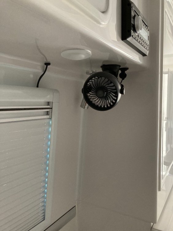

AndrewK Posted November 30, 2020 Share Posted November 30, 2020 (edited) David, We purchased two small Lemoistar USB powered suction cup fans that we have attached next to the USB/12V plugs, under the upper cabinets. They are very quite and have worked very well for us. They are not the best quality but I tried much more expensive options from Caframo and found the $10 fan on Amazon was the best for our purpose. They are not remote controlled but they use such little power, they can be left on low most of the time. Andrew Edited November 30, 2020 by AndrewK 1 Andrew 2019 Legacy Elite II 2018 BMW x5 35d Link to comment Share on other sites More sharing options...

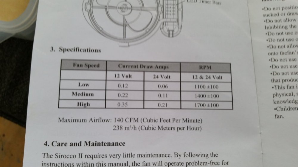

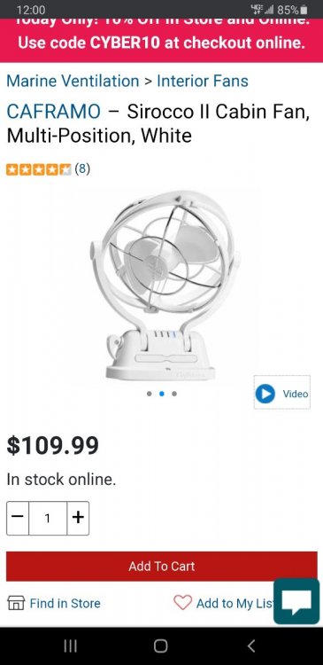

Moderators SeaDawg Posted November 30, 2020 Moderators Share Posted November 30, 2020 I seem to remember that John Davies installed a caframo fan. I'll see if I can find the post for you. I'd probably recommend a pair of Caframo Sirocco II fans if I were in your situation. The Sirocco model has been around for decades, highly rated by users, and tested and recommended by Practical Sailor. The Sirocco fan does not have a remote, but it has a timer with three settings, and moves a lot of air for .38 amps on high. It can fold up and out of the way when not in use, and offes 360 degrees of directional airflow adjustment. Mounting hardware included. https://www.practical-sailor.com/boat-maintenance/product-update-facnor-fx-furler-caframo-scirocco-ii-and-more 2 2008 Ram 1500 4 × 4 2008 Oliver Elite, Hull #12 Florida and Western North Carolina, or wherever the truck goes.... 400 watts solar. DC compressor fridge. No inverter. 2 x 105 ah agm batteries . Life is good. Link to comment Share on other sites More sharing options...
John E Davies Posted November 30, 2020 Share Posted November 30, 2020 (edited) My single Caframo located in the rear curbside corner works extremely well and it sips power (0.35 amps on High). Normally it is pointed down a few degrees and rotated in a 45 degree angle toward the street bed, where my wife sleeps. We both sleep head to the front, so we get the air on our faces. Even on Low or Medium speed she gets plenty of air, I get enough leakage to stay comfortable. If I am camping alone I point it towards my side. I highly recommend this fan, you could always install two and both have full control, though as noted above they are not remote control. Yes they are pricey, but I look at expensive upgrades as “making it easier to resell the trailer” though you never ever get back your investment in the upgrade part and labor cost. If the labor is your own, it is easier to deal with. https://olivertraveltrailers.com/forums/topic/3305-how-to-caframo-sirocco-ii-12-volt-marine-cabin-fan/ These really are quite nice, and I think Oliver should offer a pair of them as factory options. John Davies Spokane WA Edited November 30, 2020 by John E Davies 2 2 SOLD 07/23 "Mouse": 2017 Legacy Elite II Two Beds, Hull Number 218, See my HOW TO threads: Tow Vehicle: 2013 Land Cruiser 200, 32” LT tires, airbags, Safari snorkel, Maggiolina Grand Tour 360 Carbon RTT. Link to comment Share on other sites More sharing options...

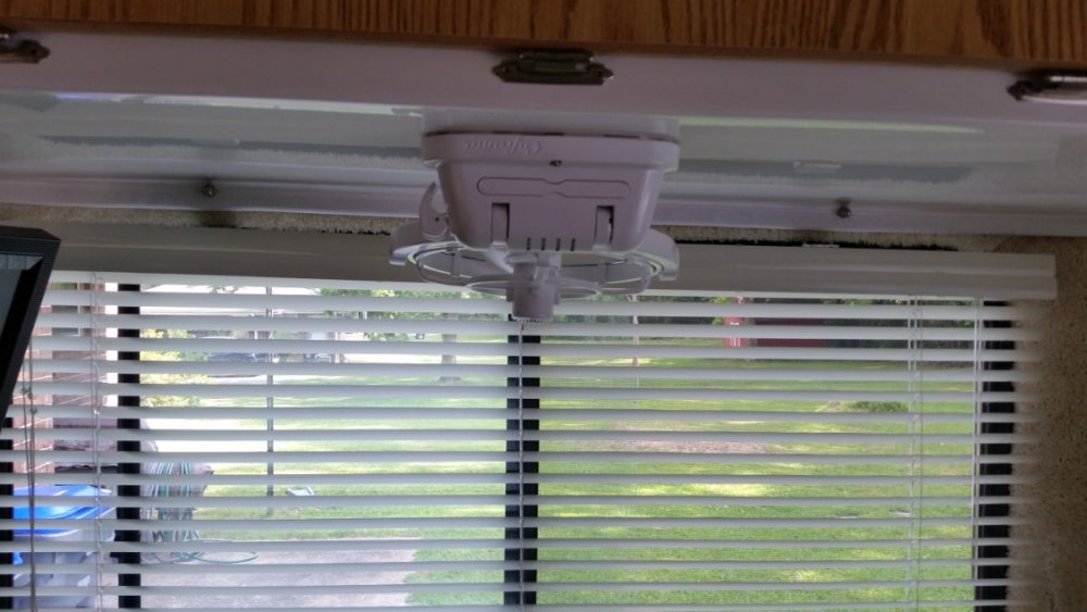

Ronbrink Posted December 14, 2020 Share Posted December 14, 2020 (edited) I agree, the Sirocco ll fans are tops! I did not want a permanent mount, so I used heavy duty Velcro to secure the fans (His and Hers) in optimum locations to maximize their use and be more obscure. One over each bed at the cabin rear and another curbside at mid-cabin (see pic) to better serve the galley and dinette areas, as needed. If you look closely, the white Velcro to secure the rear curbside fan is hardly noticeable. The fans are stowed in the attic when not in use or underway. I did alter the wiring to facilitate use of the 12v female lighter sockets of proximity. The rear street side fan cable loops through the cord hole servicing the TV to the socket in the attic, and for now the rear curbside is routed through the attic doorway until I make a hole to route it in similar fashion as the street side. I utilize the under counter socket above the cooktop for mid-cabin fan use. I installed DC 2.1x5.5mm female socket jacks and connected the fans’ stock power wire internally in each. I then altered two DC 2.1x5.5mm power plug extension cables by replacing the female end with a male lighter socket plug connector. This set up now allows for ‘plug and play’ versatility if I want to use the fans in my TV or an outdoor setting. Edited December 14, 2020 by Ronbrink 4 2020 OLEll, Twin, 579 2012 Silverado 1500 4x4 No installed solar, Renogy 40A DC-DC charger, 460Ah LFP battery bank/Victron SmartShunt, Hughes Autoformer, dual Lagun tables Link to comment Share on other sites More sharing options...
