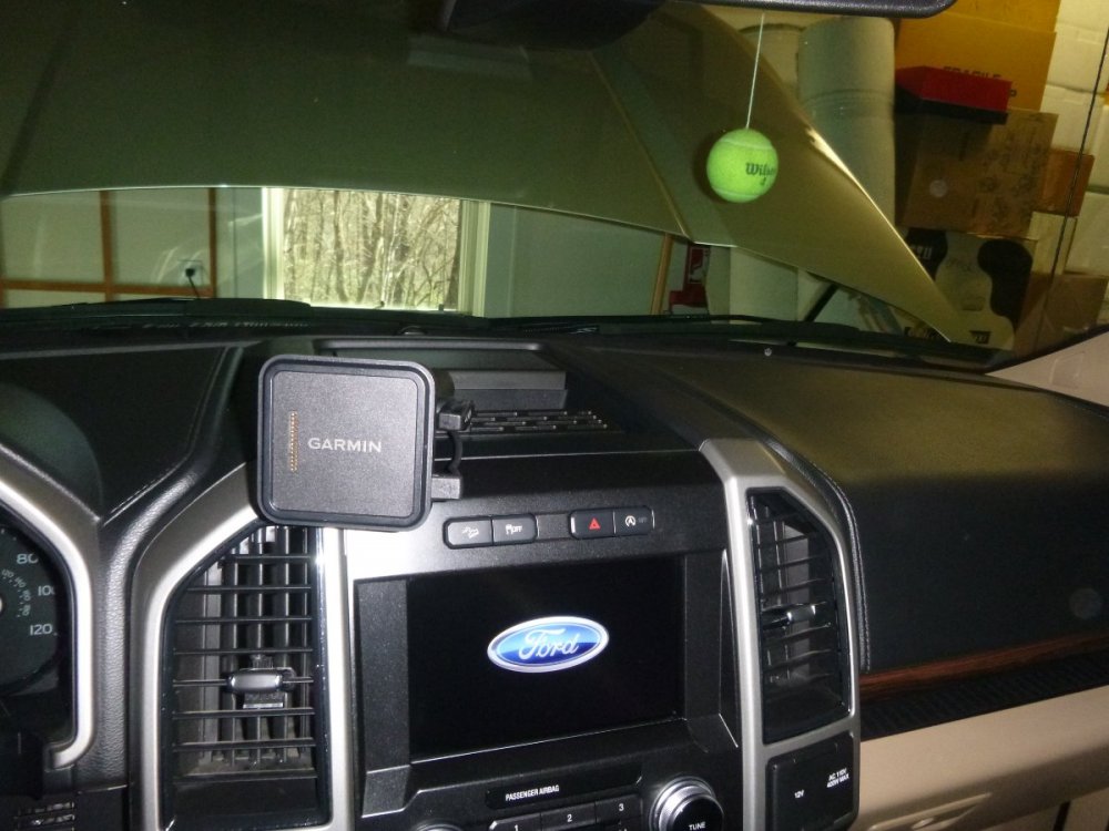

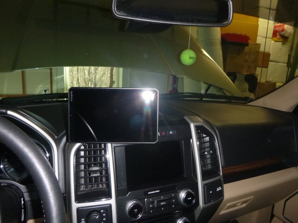

Yes, I also stumbled across another mount that fits in the "slot" between the air vents and nav/control screen.  However, it was basically designed for only one device at a time and the install was considerably more involved.  As the picture you posted shows, it will not be difficult to get the Garmin to sit about half way above and below the front of the dash.  This will still give access to the controls above the nav/control screen while also not blocking that much of the view out of the windshield - kind of picture the Garmin "ball which is centered on the back of the unit right where the RAM mount is in the picture.
p.s.  when I purchased the truck in 2017 I immediately had window tint (street legal of course) put on the two side windows and a strip added to the windshield to aid in blocking some of the light and reflection from that large glass.  It is much better than the 2011 model that I had and the front side windows now more closely match the very dark tint of those read windows.

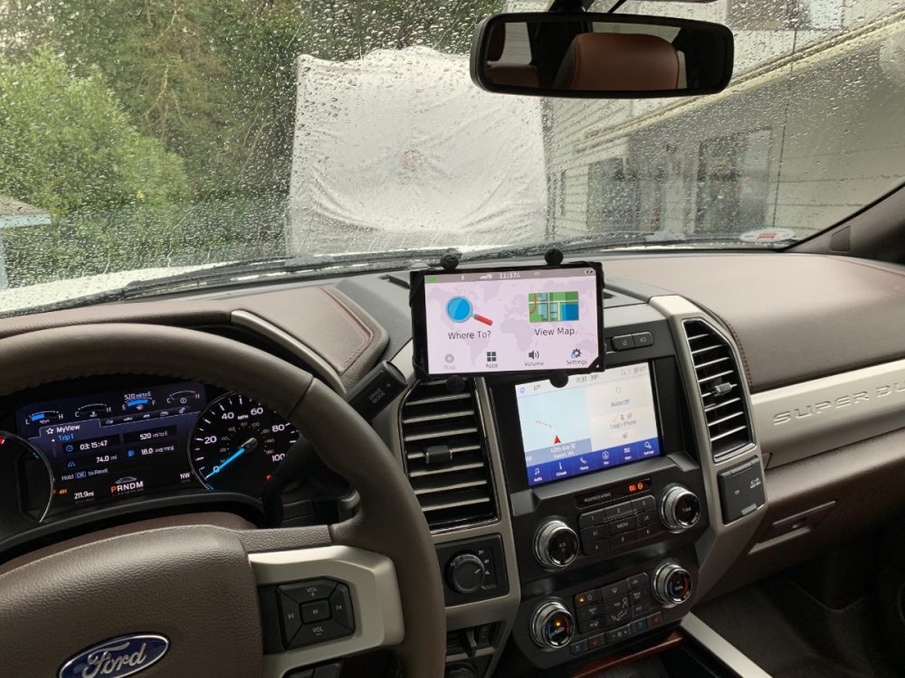

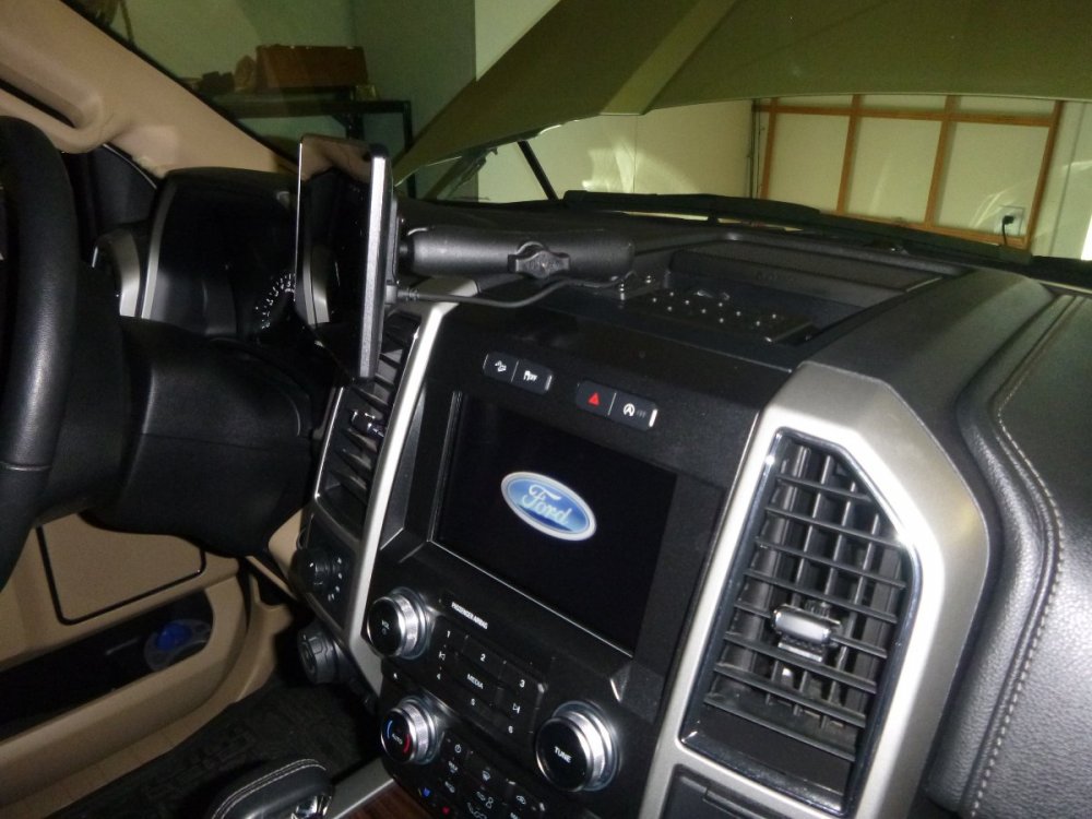

Now that I have the Garmin 890 installed along with the Builtright rack for the dash tray on the Ford (150 or 250), here are a couple of pics.  Hardwiring the 12 volt/2 slot USB that used 3M double sided tape to attach to the underside of the Builtright rack was a bit un-nerving but not really difficult - let me know if you want details.
With the adjustable RAM mount I can move the GPS to a more comfortable position as compared to my old GPS which actually had to sit up on the dash a bit too far away to make changes on the fly.  And, even given the weight of the 890, the RAM mounts hold the screen securely and without vibration.
The Garmin 890 is really very nice - it should be for its "sale" price of $400.  But, the inclusion of data for campgrounds, dump stations, propane outlets, truck stops, Walmarts, Cracker Barrels, etc., really make this unit much more useful as compared to my old Garmin.
The traffic and on the fly fuel price functions of the 890 are obtained via a Garmin app connected to the 890 via bluetooth.  I've not had a chance (yet) to test these features.

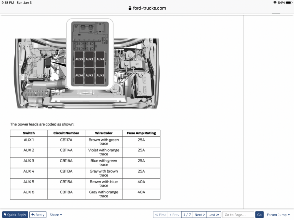

In conversations with Patriot, he has told me that his new Ford Tremor has powered switches at the top of the windshield - bottom of the headliner.  If an easy way of feeding the power wire exists to allow going through the firewall where the fuse box is located for these switches, wiring into these would provide a slick result with the ability to switch on/off the power to the rack.  I did consider "fishing" the power wire over to the fuse panel that is located on the outside of the passenger footwell.  Once there I would have found a circuit like the one for the sun roof that is switched via the ignition.  But, obviously, I was simply too lazy and since the Garmin doesn't consume very much power (particularly when the screen is off) I'm not worried about draining my battery if I forget to unplug the Garmin when I stop for the night.
My 890 arrived yesterday and I am still thinking through this install. As TG mentioned I do have the optional upfitter switches (pic) one of which will likely be my 890 power source. The builtright mounting bracket is on its way from the supplier. And I already had a new ram mount in my shop that I had never opened from my previous 2 wheeled moto years. My only concern with the ram mount arm length from the mounting ram ball mounting point on the Builtright.
Which begs the question? Is there any noticeable screen bounce or screen vibration when driving down secondary roads using the longer ram arm mount?
In a recent conversation with TG, I believe he mentioned he saw no noticeable screen bounce or vibs on the smoother super slab on a recent trip.  Over thinking, Yes.. guilty.😎
Over head upfitter switches-
Edited by Patriot
