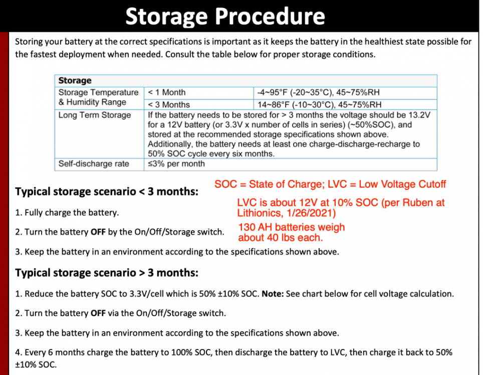

Oliver is now beginning to use three 130 AH batteries (390 AH total) as part of the lithium package.  Listed below are the storage requirements from the Lithionics website (https://lithionicsbattery.com/wp-content/uploads/2019/02/Lithionics-Battery-Storage-Procedure.pdf -- my additions are in red text).  LifeBlue batteries likely have similar storage requirements.  These are storage requirements; the lithionics batteries have a charging range of 32°F to 113°F, and a discharge temperature range of -4°F to 113°F. In other words, when the batteries are in use (e.g., when traveling) they can handle a broader temperature range than when in storage.

2123287700_ScreenShot2021-01-26at11_30_23AM.thumb.png.42c213555d5b05895a8135642d9ac65b.pngquirements

Oliver is now installing three 390 AH Lithionics Group 31 batteries in the LE2 (for a total of 390 AH).  Listed below are the storage requirements from the Lithionics website (https://lithionicsbattery.com/wp-content/uploads/2019/02/Lithionics-Battery-Storage-Procedure.pdf -- my additions are in red text).  LifeBlue batteries likely have similar storage requirements.  These are storage requirements; the lithionics batteries have a charging range of 32°F to 113°F, and a discharge temperature range of -4°F to 113°F. In other words, when the batteries are in use (e.g., when traveling) they can handle a broader temperature range than when in storage.  I confirmed this with a Lithionics representative.
