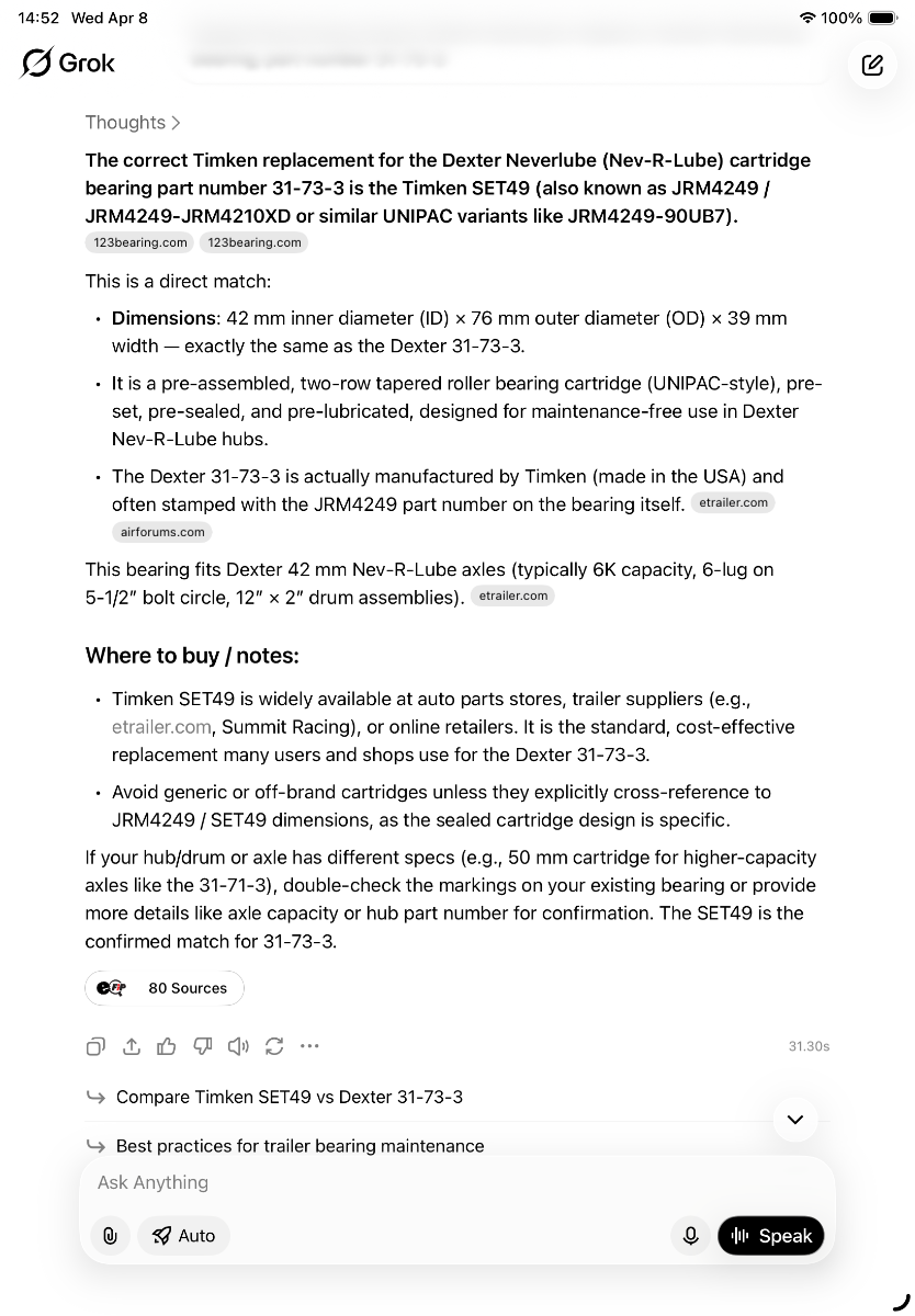

theOrca Posted April 8 Posted April 8 (edited) For those who have never used "Grok," I have provided a sample below. The thing I find so wonderful about Grok is the ability to ask a common language question about a hard to understand subject and get an answer you can use. If something confuses you, you simply type a followup on the same form saying something like: "Please explain XYZ more, I am not getting it. Grok then continues. The below screen shot is what Grok gave me when I asked it to give me the exact match of Timken bearing to the Dexter Neverlube bearing (serial number from my D52 build sheet. Have fun. Edited April 8 by theOrca 2 theOrca, 2020 Legacy Elite II, Twin, Hull 615 Tow Vehicle - 2016 Ram 1500, Hemi, 8 Speed with 1500# rear springs and Goodyear bags.
theOrca Posted April 8 Posted April 8 (edited) 4 hours ago, John Dorrer said: No issue on ours For the Neverlube - one axle end equals one bearing... See the Timken info above. Edited April 8 by theOrca theOrca, 2020 Legacy Elite II, Twin, Hull 615 Tow Vehicle - 2016 Ram 1500, Hemi, 8 Speed with 1500# rear springs and Goodyear bags.
jd1923 Posted April 9 Posted April 9 (edited) 16 hours ago, theOrca said: The below screen shot is what Grok... Yeah, cool technology, but we already know the OEM bearing is the Timken Set49. Also, it's safer to only use manufacturer's spec vs. any website content. https://www.summitracing.com/parts/tmk-set49 17 hours ago, mountainoliver said: The bearings are easily accessible at most any auto parts store as they were used on the 2010 PT Cruiser front wheels. Genuine Timken parts are NOT often "easily accessible" and make sure you're buying from an authorized reseller. For example, say you broke down and were lucky enough to be close to a local Napa. They would sell you a China-made alternative that would take 1-2 days to arrive at the store location, while you're broke down somewhere. Then you have to get it installed. Not many PT Cruisers on the road anymore and in general AP stores only stock parts for new-model cars < 10 years old. I found this entering the 2010 PT Cruiser on Napa Online: https://www.napaonline.com/en/p/PGBPFW115 Ken and I worked through this when I tested the bearing install procedure (linked in my prior post on page 5). He has replacement bearings, related parts and tools already purchased and he travels with them. I got lucky getting damaged axle parts, so I carry two full bearing hub/drum assemblies in the TV toolbox (I also carry new Timken front hubs for the Dodge Ram). In my case, if a bearing goes bad, I can be back on the road in 1-2 hours! 😎 However buying full assemblies is exorbitant! I truly suggest if this is a concern of your, read the post I made showing bearing removal and replacement. At a minimum, do yourself a favor a buy 2-4 Timken Set49 bearings. Then you'll have the parts you need so that any trailer shop can install them for you. To be very safe, you may want to have extra circlips, nuts and washers. And if you want to DIY, my post details the required toolset. Edited April 9 by jd1923 3 Chris & John in Prescott, AZ | 2016 EII #113 | '01 Ram 2500 Cummins!
