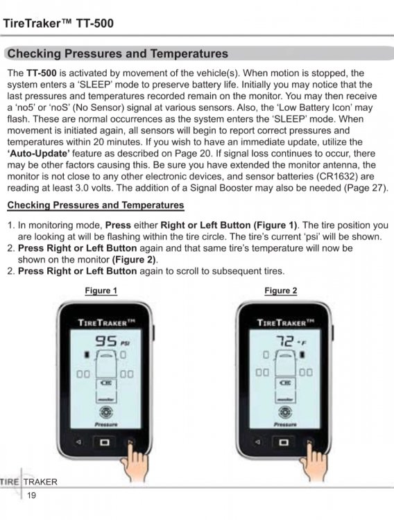

Frank C Posted March 9, 2021 Posted March 9, 2021 (edited) I have the Tire Traker 500 also. It’s worked very well, and I haven’t needed the amplifier. I do have a question though for those who buy extra sensors and mount them on the spare tire of the Ollie or the spare of the tow vehicle. The sensors go into sleep mode after a time interval when the tires aren’t rotating, and only send new readings after waking up when the trailer starts moving and the tires start rotating (takes a few minutes on mine to get updated readings when just starting out on the road). Does the sensor on the spare tire actually wake up and send a new reading? The spare tire is only getting random road vibrations. Is that enough to wake up the sensor on the spare tire to send a new reading every so often? Or is the receiver unit sending a “wake up” signal to the sensors when the receiver is turned on? Edited March 9, 2021 by FrankC
John E Davies Posted March 9, 2021 Posted March 9, 2021 (edited) 47 minutes ago, FrankC said: Does the sensor on the spare tire actually wake up and send a new reading? The spare tire is only getting random road vibrations. Is that enough to wake up the sensor on the spare tire to send a new reading every so often? Or is the receiver unit sending a “wake up” signal to the sensors when the receiver is turned on? The spare tire sender wakes up by itself after driving a few minutes and it stays working like the other four. You can also wake one up by flicking it with a finger (imagine flicking a booger, sorry for the perfect analogy🙄). First thing in the morning while doing my walk around inspection before leaving the site, I wake the display and then flick the senders to get “today’s” pressures, not the ones from when they last went to sleep (when they were warm from driving). This is in case one happened to pick up a nail and was quietly deflating over night. (You would not know until after driving a few minutes otherwise.) I never use a tire gauge unless one of those morning readings seems odd. They do not indicate super accurate numbers, but they are very consistent. John Davies Spokane WA Edited March 9, 2021 by John E Davies 1 SOLD 07/23 "Mouse": 2017 Legacy Elite II Two Beds, Hull Number 218, See my HOW TO threads: Tow Vehicle: 2013 Land Cruiser 200, 32” LT tires, airbags, Safari snorkel, Maggiolina Grand Tour 360 Carbon RTT.
dewdev Posted March 9, 2021 Posted March 9, 2021 (edited) FrankC According to TireTraker, the sensors on the spare tires will sense the road vibration when moving and wake up. As TireTraker recommends, in the morning you can do a "Auto- Update" which will provide data on all the sensors. Richard Edited March 9, 2021 by dewdev 1 2018 Oliver Elite II, Twin Bed, Hull #354, new Lithonics batteries and Xantrex Freedom XC 3000 Pro Inverter in 2025 2024 RAM 1500, 4 x 4; Gas. 5.7L V8 Hemi MDS VVT Torque; 3.21 rear axle ratio w/TIMBREN spring rear suspension addition Maine
