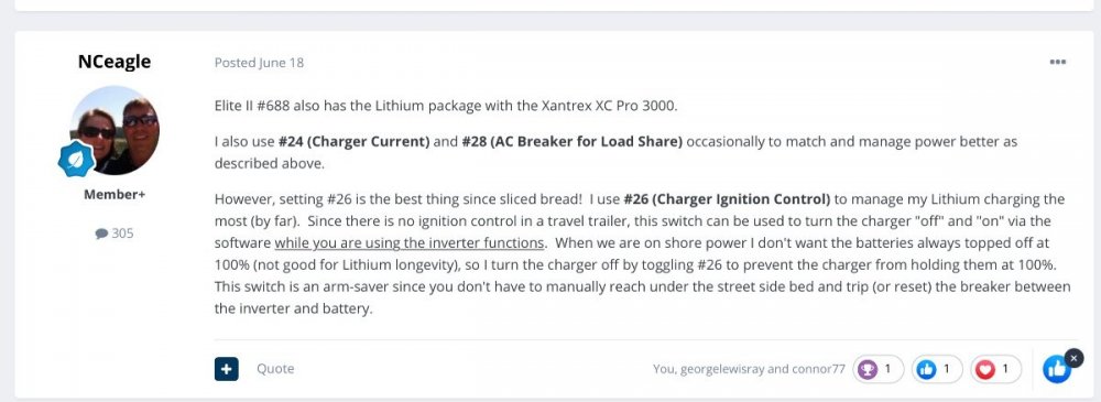

Do you have the Bluetooth app for the inverter? If so, by turning the “Charger Ignition Control” switch on (#26), you can disconnect the charger from the batteries… it’ll take care of the inverter noise as it stops it from constantly trying to charge the batteries. There was a thread a while back in which NCEagle brought this strategy to light. I’ve been doing it ever since and it works great.
I did have the bluetooth app installed, before we had the inverter replaced.  Haven't tried pairing the new one yet.  I assume this setting can also be changed via the remote panel.  What does Oliver say about this strategy?
This sounds good -- I would love to use 110V power (for refrigerator, auxiliary heater, AC etc) when plugged into shore power without charging the batteries (for 2 reasons: to avoid unnecessarily charging the batteries and to avoid the fan noise while charging).  I installed the Xantrex FCX bluetooth app (iPhone version), but the "charger ignition control" setting was already in the off position.  The only other choice is "auto-on."  The app states that when set to "auto-on" the charger operates only in tandem with the vehicle's ignition circuit.  In this case, I assume that "vehicle" means tow vehicle, but there is no stock way of connecting the vehicle's ignition circuit an Oliver trailer with the Lithionics batteries.  So this charger ignition control" setting seems to be a moot option.  What am I missing? ... The app does not list switch numbers (e.g., #26), so perhaps there's a different app, or another way of disconnecting the charging function?

OK, so I switched the charger ignition control setting to "auto-on,"  and then plugged in to shore power.   The remote panel shows that the battery is not connected; the annoying inverter fan ran for a few minutes and then turned off, and appears to have remained off (at least for the few minutes that I was checking).  The 110V outlets are active, as is the AC option on the fridge.  So, success ... but as clear and intuitive as mud.  It would sure be nice to have a switch on the control panel for simply disconnecting the charger.
It might have been NCEagle that came up with this (doing a search for "charger ignition control"), but it is not clear to me how he identified this as the way to turn off the charger, and how he was making the changes without the app (or perhaps he was using the app, although I don't see references in the app to switch #26).
I also wonder how this switch might work if there is a DC to DC charger hooked up between the tow vehicle and trailer.  I assume that having the charger ignition control be in the "auto-on" position means that the tow vehicle can charge the batteries when connected, but connecting to shore power would not charge them?  Hmmm.

As I mentioned the other day..  NCeagle figured this out… this was part of the thread  from this past June…. It would be worth reviewing for anyone annoyed by their inverter fan noise or who, like me, wants to have a simple way of not charging their lithium batteries every time they are plugged into shore power….There is more info in that thread..
it works in Hull #685… maybe it’ll work in yours too..

Yes, I am the culprit who accidently discovered the alternative use for switch #26.  I discovered it when I read another thread about a new owner (can't remember who) was having trouble with his Xantrex charger not working shortly after delivery.  Working with OTT Service, the problem ended up being that switch #26 was set to "auto on" rather than "off" and it was preventing the charger from charging the batteries since it was looking for an ignition signal (and would never get one from the Ollie obviously).  I was honestly less than 24 hours from cutting a hole under the pantry to get easier access to that cutoff switch before the lightbulb went off that I could use that same software switch that caused the problem for the other owner.  🙂
A DC to DC charger won't change anything if it's an "independent" charger that doesn't go through or depend on the Xantrex in any way.  There may be a slick way of hooking the TV ignition or DC to DC charger up so that it leverages the Xantrex - and then switch #26 could actually be used as intended.

Well, I'm grateful to you for having figured this out.  While not as elegant as a simple on-off charging switch on the remote panel, it solves one of my greatest annoyances with the trailer: how to run the fridge or other appliances on 110V without continually charging the batteries or listening to that inverter fan cycle on every 15 minutes.  Now if I can just do something to quiet the inverter when we do want it to charge the batteries....

Thanks for the info.  Can we change the #26 setting in the programming menu through the Xantrex remote panel?  What is the setting needed to prevent charging and thus causing the fan to cycle on and off.
