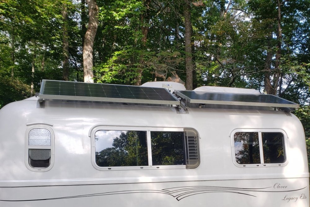

It would sure be nice to have everything visually integrated into one 5 or 7 inch GX screen.  I wonder if Oliver moved some of the antennas to the back (this might degrade reception) if they could stuff 600ish watts of solar on the front. The array would be 15-20 inches longer. This would be great for running back to the AC’d trailer in the heat of the day to let the kids rest.
@Overland has 640 watts on his roof. Oliver did this install back when they did more customization. I don't know if they had to move any of the rooftop equipment , but I'm sure he'll know.
Others have added the narrow 80 watt zamp panels to the system themselves, and upped their fixed wattage.
We doubled our wattage on our trailer by swapping out our 2 x 100 watt panels for slightly larger  200 watt panels in our sidemount system.
So, it is possible,  even with the limited rooftop real estate, to increase solar production. Your trailer may look like a landing strip from above, and you'll probably get some shading from the ac and vents at various times of the day, but it will up the production.

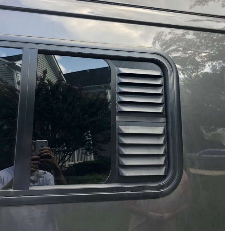

The single most valuable thing on SeaDawg's Ollie just might be those window vents! 😊
They are no longer made!
Indeed. We were very careful to remove the vents ourselves, and keep them at home, when we had the dual pane windows removed and repaired this year.
I have no idea why maxxair doesn't make them anymore. They're so nice in the rain. I can keep two sliders open about 1/4, and still circulate air.
I think @csevel kept hers when she sold her Casita, and I certainly would, too!
Once in a great while, new/old stock used to pop up on eBay. Haven't seen them in a long time.
If anyone is looking for vents.. There's a guy on the Fiberglassrv forum who has 3d printed a vent in his own design.  If you private message me, I can dig that email/ info up and share.  They work slightly different as they slide into the track and are not permanently affixed like the Maxxair but they come in three colors.. black, white and smoke.
I certainly knew the vents were the first thing I was removing before  I sold my Casita!  But ~ I will say that eventually mine will need replaced with this alternative, as the Maxx do get brittle.  I have a couple hairline cracks already!

I don't have any cracks yet, but I wouldn't love rainy life without mine!

@Overland do you happen to have any links to past threads regarding your solar setup. I’m guessing 4 of the 160 watt zamp panels?  I’m currently thinking six 100w panels mounted three wide.  This might give me more latitude with voltage options although I’m still researching that. Another option is three 190-200w mounted sideways.  I’m hoping the four factory mount points will support a custom aluminum framework that the panels can be mounted to.

It’s nice to read through the progression from idea to final product. Do you happen to have any pictures of how they mounted the three forward panels?  I have a feeling I’d be lucky to have them just install the mounts. Looks like custom work is not available anymore.

Service can do that job for you after delivery. The inside aluminum backing plates are already there on all hulls, the tech would just have to precisely locate and drill the holes. However, IMHO the four mounts would be marginal at best to support such a large array when traveling on bumpy roads and with gusty winds.
I agree especially with the front overhanging another 20 inches. It sounds like they have mounted three sideways zamp panels in the past and the array I’m looking at will be the same size and weight.  I need to really sweat talk Jason (et al) … the unit might spend more time in the service department than on the factory assembly line.
