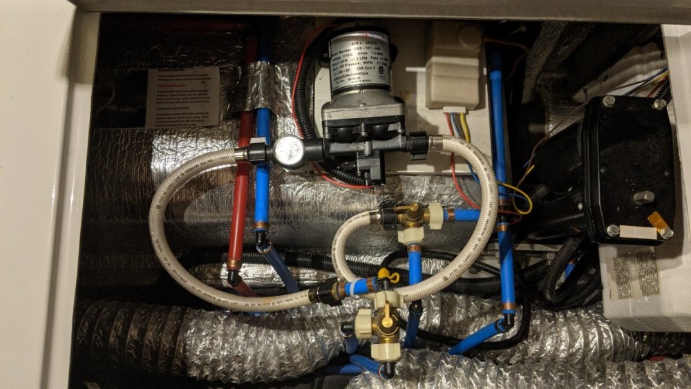

Moderators Wayfinder Posted September 11, 2021 Moderators Posted September 11, 2021 My freshwater tank is full, water pump is on, but I'm not getting any water coming through the system. Do you see anything wrong with the valve configuration for the 2016 Elite 2? I have been able to pump in the winterization configuration when I cleaned out everything with vinegar water. Chris 2016 Legacy Elite II o-o Hull #110 o-o "Rock'in 110" o-o Twin Bed (sometimes converted) o-o 5-leaf Alcan Springs (installed Feb 2026) 2020 RAM 1500 Limited 5.7L Augusta, Georgia
Moderators mossemi Posted September 11, 2021 Moderators Posted September 11, 2021 54 minutes ago, Wayfinder said: My freshwater tank is full, water pump is on, but I'm not getting any water coming through the system. Do you see anything wrong with the valve configuration for the 2016 Elite 2? I have been able to pump in the winterization configuration when I cleaned out everything with vinegar water. I edited your photo to add port designations for clarification. I can’t see all of the piping in the picture, but I assume that port A goes to the filter/suction side of the pump. And port B is closed by the valve, so port C should be from the fresh water tank. I can not be sure that port C is in fact from the fresh water tank or where port B goes or comes from. Can you verify the piping for ports B and C under the heating duct? It may be the the valve is in the incorrect position. Mossey Mike and Krunch Lutz, FL 2017 LEII #193 “the dog house”
Moderators Wayfinder Posted September 11, 2021 Author Moderators Posted September 11, 2021 I cannot be sure myself. This is the first time I'm attempting to pump from fresh tank. This pic is from the factory, I'm sure. Chris 2016 Legacy Elite II o-o Hull #110 o-o "Rock'in 110" o-o Twin Bed (sometimes converted) o-o 5-leaf Alcan Springs (installed Feb 2026) 2020 RAM 1500 Limited 5.7L Augusta, Georgia
Moderators Wayfinder Posted September 11, 2021 Author Moderators Posted September 11, 2021 Both houses going to the pump are empty and the bowl is empty too. Chris 2016 Legacy Elite II o-o Hull #110 o-o "Rock'in 110" o-o Twin Bed (sometimes converted) o-o 5-leaf Alcan Springs (installed Feb 2026) 2020 RAM 1500 Limited 5.7L Augusta, Georgia

Moderators mossemi Posted September 12, 2021 Moderators Posted September 12, 2021 (edited) I would try JD's suggestion before anything else. If you do not understand what he means about filling the supply line, please ask for clarification. Now I have another question. Does the pump run when you turn it on and open a faucet? I reread your original post and you did say the pump was on and I assume you could hear the pump running and you did use the rear port to draw in the vinegar solution to clean the system. Mosssey Edited September 12, 2021 by mossemi Strike through Mike and Krunch Lutz, FL 2017 LEII #193 “the dog house”
Moderators topgun2 Posted September 12, 2021 Moderators Posted September 12, 2021 I've got a 2016 also and it appears to me that your valves ARE in the correct positions. Given this, the first thing I would do in addition to JD's advice would be to make sure that all connections are tight and that I didn't have a leak. Bill 2023 Ford F150 Lariat 3.5EB FX4 Max Towing, Max Payload, 2016 Oliver Elite II - Hull #117 "Twist" Near Asheville, NC

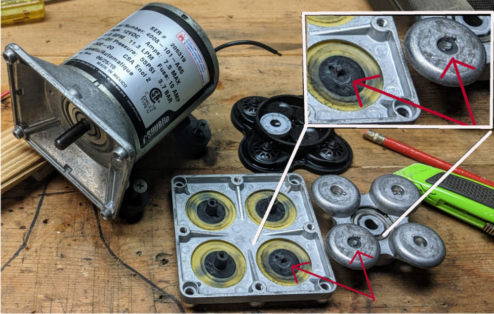

Moderators Wayfinder Posted September 23, 2021 Author Moderators Posted September 23, 2021 Well, I found the source of of the water pump noise. I think it's this part: https://www.amazon.com/SHURFLO-94-800-02-Water-Drive-Assembly/dp/B00UYWVB0C/ref=sr_1_18?dchild=1&keywords=shurflo+4008+parts&qid=1632405066&sr=8-18 2 1 Chris 2016 Legacy Elite II o-o Hull #110 o-o "Rock'in 110" o-o Twin Bed (sometimes converted) o-o 5-leaf Alcan Springs (installed Feb 2026) 2020 RAM 1500 Limited 5.7L Augusta, Georgia
Moderators topgun2 Posted September 23, 2021 Moderators Posted September 23, 2021 Ouch! Glad you found the issue. 2023 Ford F150 Lariat 3.5EB FX4 Max Towing, Max Payload, 2016 Oliver Elite II - Hull #117 "Twist" Near Asheville, NC

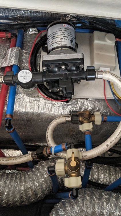

Rivernerd Posted August 31, 2025 Posted August 31, 2025 (edited) The fresh water pump in my 2022 Elite II, Hull #1091, would not pump water from a full fresh water tank after sitting through the winter. Several attempts, no water, just a whining sound, Before I tried John Davies "prime the pump" suggestion above, I removed the filter from the inlet side of the pump. It was full of brown slime! A thorough wash of the filter housing and mesh filter enabled the pump to then work as designed, pumping water from the fresh tank to the sinks and toilet. Lesson learned: check, and clean, the pump filter annually after de-winterizing. Edited September 3, 2025 by Rivernerd 3 Hull #1291 Central Idaho 2022 Elite II Tow Vehicle: 2019 Tundra Double Cab 4x4, 5.7L with tow package
Moderators topgun2 Posted August 31, 2025 Moderators Posted August 31, 2025 4 minutes ago, Rivernerd said: It was full of brown slime! Also this is a "nice" reminder as to at least one of the reasons we sanitize the fresh water tank. Bill 3 2023 Ford F150 Lariat 3.5EB FX4 Max Towing, Max Payload, 2016 Oliver Elite II - Hull #117 "Twist" Near Asheville, NC
