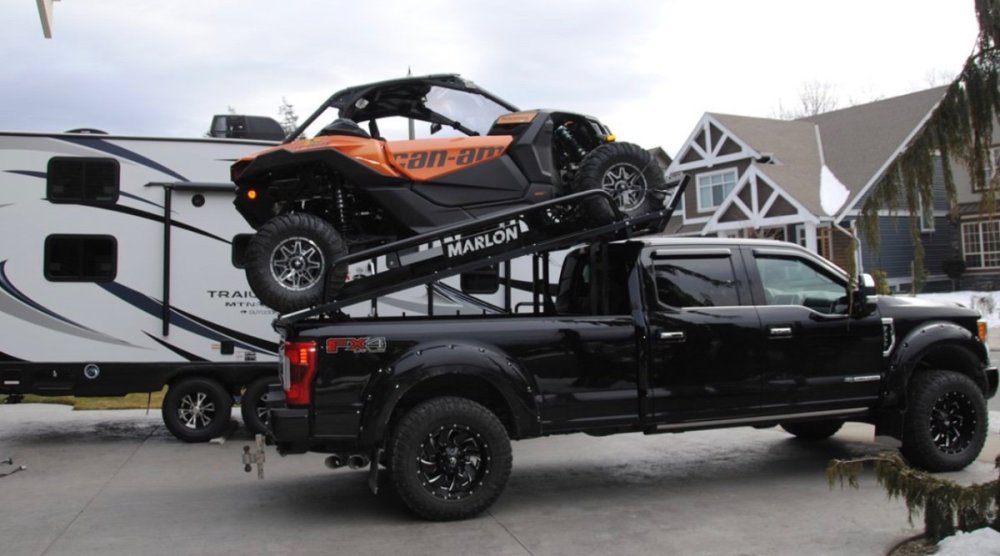

ChrisMI Posted December 15, 2021 Posted December 15, 2021 I’ve looked into this a little bit. I’m not sure if some states like Michigan require a 5th wheel behind the truck to pull doubles. The Oliver wouldn’t make a very good trailer for this IMO. Too hard and expensive to make the modifications to support the weight. If you have a heavy duty pickup the Marlon rack might be an option… 1

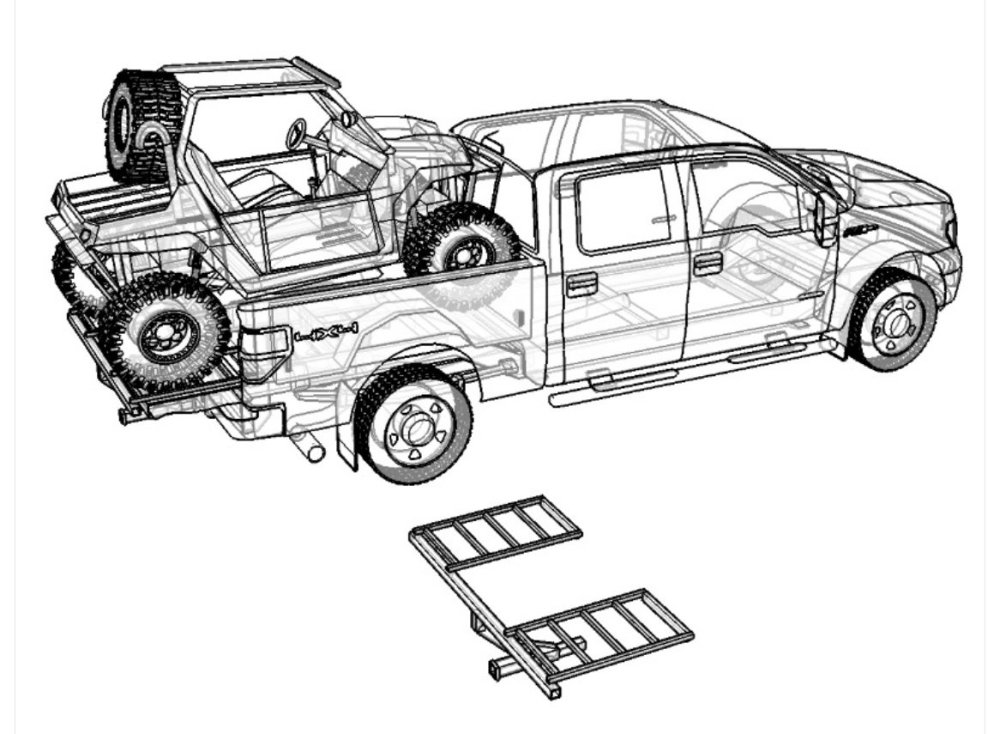

ChrisMI Posted December 19, 2021 Posted December 19, 2021 Another option to keep the COG lower in the truck is to use the hitch to provide rear support and park in the bed (assuming the sxs et al is less than 50” wide). I really like this support by hehitch, but I’m not sure if they’re still in business. Should be pretty easy to fab up…
Landrover Posted December 19, 2021 Posted December 19, 2021 10 hours ago, ChrisMI said: Another option to keep the COG lower in the truck is to use the hitch to provide rear support and park in the bed (assuming the sxs et al is less than 50” wide). I really like this support by hehitch, but I’m not sure if they’re still in business. Should be pretty easy to fab up… These are all great options for carrying atv and utv’s although the weight factor and having to put a very long extension on the back hitch for towing a trailer, it may work at first. I’m sure you’ll find your hitch will have worn out in a very short time. Making a bad situation when on the road. If this is what you want, I would consider looking at a ATC ( aluminum trailer Company) toy hauler all aluminum custom made size’s and good build quality like the Oliver, Grant 2022 GMC Denali 2500 HD 2019 Elite 11😎
ChrisMI Posted December 19, 2021 Posted December 19, 2021 It’s all about having options. Normal setup might include kayaks, sup’s, bikes, and supplies. However, one winter I might want to haul down a small wave runner to Big Pine Key. A different time it might be a SxS to Utah for a month. Putting anything in the bed is obviously for 3/4 ton trucks and up. Most of these have a 2k tongue rating vs a 500lb on a half ton. Weight added to the hitch might only be 300 ish lbs and the extension length would be determined by the tailgate clearance. The setup will probably rust out decades before it's worn out as I live in Michigan. I buy for 90 percent of my mission, the rest I modify or rent.
