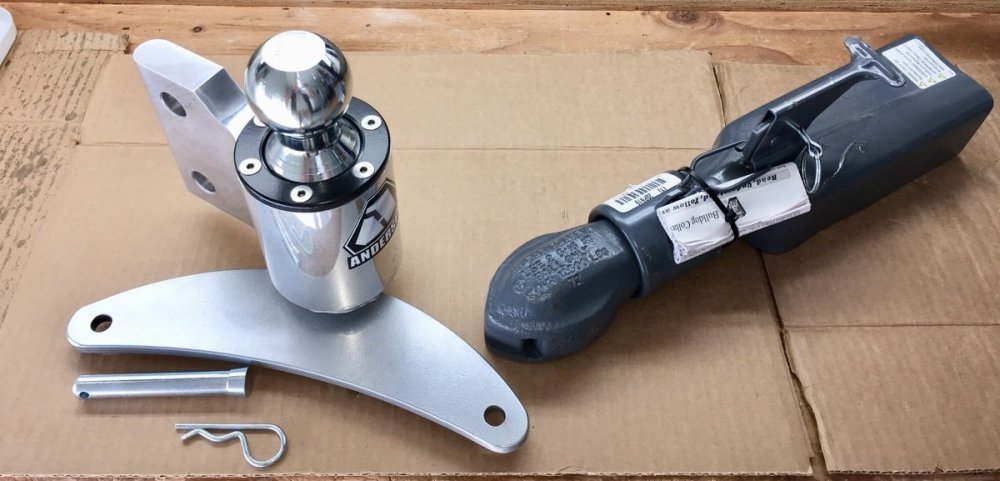

BoondockingAirstream Posted February 10, 2022 Author Posted February 10, 2022 I will rephrase my question. I WANT to USE my current Equalizer shank and 2 5/16 inch BALL to tow our Oliver. I will make what shank adjustments necessary to do that. What do I need to purchase to attach TO THE Oliver so I can? Has someone done this? I need to know what to purchase, removing the Anderson 2", and bolt on a 2 5/16 inch receiver ball to the front of the Oliver. So... I do not want to use the Anderson 2 inch coupler. I want to know where to get so the coupler on the Oliver to 2 5/16 inch receiver. I have everything needed for my Airstream and want to use it on the Oliver, but need to remove the 2" system and bolt on a 2 5/16" coupler assembly. Where can I find a source to purchase? 1
John E Davies Posted February 10, 2022 Posted February 10, 2022 https://www.bulldogproducts.net/products/trailer-couplers/straight-couplers There are two choices, depending on what type of lock you want. Etrailer.com is probably the best source. I used the P/N 028462, which is similar to the one Oliver installs. Did you look at the HOW TO link I posted above? I don't have a clue how you will mount the Equalizer brackets, you will have to cut away some of the doghouse to access the outer frame members. That will be unsightly and will definitely affect resale value in a negative way. I don't know how much a new one would cost, if the future buyer doesn't like your holes, but I know it would be a whole lot more expensive than a brand new Andersen hitch. Getting the doghouse off requires opening up the bath vanity hatch, to gain access to the nuts inside, that hold the back of it to the hull. John Davies Spokane WA 1 SOLD 07/23 "Mouse": 2017 Legacy Elite II Two Beds, Hull Number 218, See my HOW TO threads: Tow Vehicle: 2013 Land Cruiser 200, 32” LT tires, airbags, Safari snorkel, Maggiolina Grand Tour 360 Carbon RTT.
ChrisMI Posted February 10, 2022 Posted February 10, 2022 Anderson - WD hitch that works well with the Oliver. Bulldog - Coupler that is currently installed on the trailer. You can upgrade both components to work with 2 5/16. You will end up with a more desirable result if you go with just a ball hitch or use the anderson system you received with the trailer. 1
BoondockingAirstream Posted February 10, 2022 Author Posted February 10, 2022 John Davies and ChrisMI... The photographs are great and it appears that I can use an Anderson Bull Dog 2 5/16 system, which I did not know existed. I would just remove the current 2 inch system, purchase the 2 5/16 inch System? From John's photos... do I have to Drill the Holes that the bolts on the front of the Oliver secure the latch assembly? Or does an Oliver company parts have the holes predrilled and hardware to mount? I am beginning at point zero and the learning curve right now is... taking straight off, thanks to those giving me my options. I should, then, be confident that I can purchase the 2 5/16 Ball assembly AND the bracket with the locking mechanism... DOES NOT NEED ANY HOLES DRILLED AND WILL HAVE THE PROPER DIAMETER BOLT AND NUTS? John and I think the same when it comes to hardware. I knew the Equalizer weight distribution system / unit would never fit an Oliver. I showed the Ball and Shank as an example for size differences. So I do have: - The option to use a 2 1/2 Inch Shank to fit the F350 and Anderson hardware. Or have to use the 2 inch Anderson Shank only and no 2 1/2 inch and add the sleeve? - Have an Anderson 2 5/16 inch Ball and assembly and Ball Latch attached to the Oliver Frame and the 2 1/2 Inch Shank purchased as a Set? (This is a bit awkward for me after 16 years using the cup and ball system and MOST Oliver use Tow Vehicles that the 2 inch shank and 2 inch ball is never thought as the only option.) I will be OllieStreamed... fast. I began looking the Oliver over this afternoon and already found one common problem that Airstream and Olivers share. I will post that once the 'dust settles'. I am so impressed with the fit of exterior components and the interior of the Oliver II. Bear with me on my 'learning curve'. I appreciate everyone's time and help... it will be easier to understand when I physically do this change... and then... like John Davies... know each detail very well. I hope.... 🙂

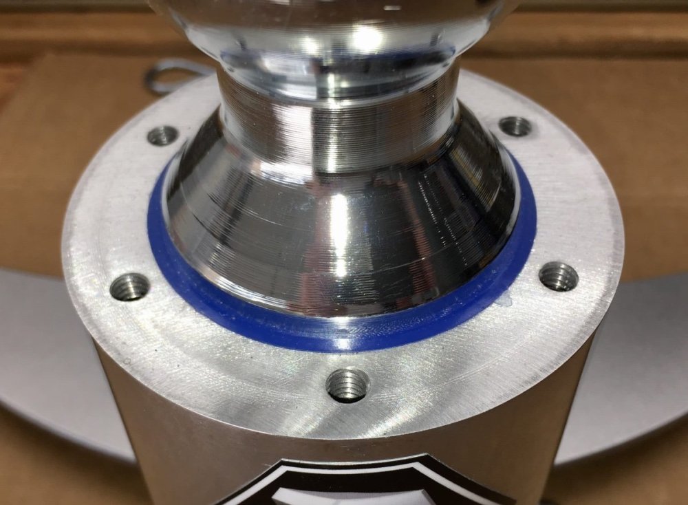

John E Davies Posted February 10, 2022 Posted February 10, 2022 READ https://olivertraveltrailers.com/forums/topic/3483-how-to-upgrade-the-bulldog-coupler-and-andersen-hitch-to-2-516/ If you have one of the several OLD Andersen designs, you may be able to trade it in for the new design pictured above for about $100, you would have to contact their customer service, and you need to say “It gets wet and is crazy loud, it sounds like the Spawn of Satan when I turn, it wakes up everybody in the campground and the dogs start barking!” Or something similar 😬Regardless, do not rebuild your old one if it is that bad design, the new design with the retaining ring and moisture seal is way better, because water and grit won’t rust the tapered shaft and tear up the friction cone. https://olivertraveltrailers.com/forums/topic/2418-fyi-andersen-wd-hitch-ball-locking-up-or-load-noise/ https://andersenhitches.com/pages/contact PS, I still think this is a waste of money and your time, though you could get your Andersen hitch updated and then sell it for $300, then buy the fixed ball mount. That will work perfectly with your HD truck, but if the rear end bounces on choppy pavement, it just means that your truck shocks are worn out. PPS, for boondocking on those rough dirt roads you would be lots better off without the Andersen, it binds up and has very VERY limited articulation when the chains are tight. You can just snug them a little, but a dead weight ball mount, or better yet an off-road coupler setup, doesn’t have those built in design flaws. Maybe overland can post pics of his…. John Davies Spokane WA 2 SOLD 07/23 "Mouse": 2017 Legacy Elite II Two Beds, Hull Number 218, See my HOW TO threads: Tow Vehicle: 2013 Land Cruiser 200, 32” LT tires, airbags, Safari snorkel, Maggiolina Grand Tour 360 Carbon RTT.

BoondockingAirstream Posted February 11, 2022 Author Posted February 11, 2022 I had looked at a Bulldog 028462 Trailer Coupler for 2 5/16 in Ball, Tongue Mount Width 3 inch... for $109.24, 12,500# (tow Two Olivers at the same time). Big Balls and Couplers are stronger... in my opinion, even if it is overkill, it harms nothing. ? It is shown UNDIRLLED. Any commments why, not?
John E Davies Posted February 11, 2022 Posted February 11, 2022 5 minutes ago, BoondockingAirstream said: Was it necessary to replace the used Anderson Ball Coupler so not to damage the new 2 inch ball? There is no such thing as an Andersen coupler. The BULLDOG coupler is very hard forged steel. The Andersen ball is intentionally made from a softer steel; according to Andersen this is so it will wear out, rather than the coupler. I personally see no logic in that. So I think that: Your coupler is not in fact damaged, probably it is very rusty from not having been greased by the previous owner, and that corrosion might be cleaned up enough to be serviceable by using a 2” ball and valve grinding compound. …. OR It is permanently damaged, perhaps poorly forged, and will have to be replaced. Only you or a mechanic can answer this question. I will point out once again, these hitches by their very design wear the ball because the chains thrust forward on the rear surface of the ball. The Bulldog has very little contact area because of the swinging side piece. If you want to reduce future damage, replace the parts with a 2 5/16” pair, so that there is more surface area. I think that this should be standard during production, the cost of the parts is no different. Just abandon the Andersen completely, get a fixed dead weight hitch and stop worrying about it. John Davies Spokane WA 2 SOLD 07/23 "Mouse": 2017 Legacy Elite II Two Beds, Hull Number 218, See my HOW TO threads: Tow Vehicle: 2013 Land Cruiser 200, 32” LT tires, airbags, Safari snorkel, Maggiolina Grand Tour 360 Carbon RTT.
John E Davies Posted February 11, 2022 Posted February 11, 2022 1 hour ago, BoondockingAirstream said: I had looked at a Bulldog 028462 Trailer Coupler for 2 5/16 in Ball, Tongue Mount Width 3 inch... for $109.24, 12,500# (tow Two Olivers at the same time). Big Balls and Couplers are stronger... in my opinion, even if it is overkill, it harms nothing. ? It is shown UNDIRLLED. Any commments why, not? Yes bigger is stronger. Undrilled because 99% of trailers have steel tongues and the couplers are welded on. You cannot weld steel to aluminum. I am off this thread now, I can’t contribute anything else. John Davies Spokane WA SOLD 07/23 "Mouse": 2017 Legacy Elite II Two Beds, Hull Number 218, See my HOW TO threads: Tow Vehicle: 2013 Land Cruiser 200, 32” LT tires, airbags, Safari snorkel, Maggiolina Grand Tour 360 Carbon RTT.
