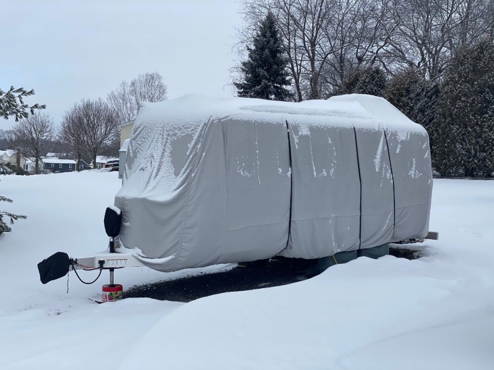

Hi John,  I understand the Calmark cover is excellent but also more expensive.  Thought I would share that I purchased the Classic Accessories SkyShield cover  https://www.amazon.com/gp/product/B01KHX27HS/ref=ox_sc_saved_title_6?smid=ATVPDKIKX0DER&th=1 last October and have been very happy with it so far.  The fit is not custom but the 15-18ft size is a pretty good fit once the straps are snug.  Time will tell if it holds up to the sun and weather but so far so good at about a third of the cost for a Calmark.
I've copied here a post that I wrote on the facebook group about how I get the cover on the trailer by myself with a 5 foot step-ladder...
 Lay it out flat on a clean driveway. Now fold it back from each end toward the center (roll and fold about every 2 ft. Once you have both “rolls” against each other at the middle, take several webbing straps and secure them around both “rolls” toward each end to hold them together. Now use a sturdy A-frame ladder at the middle of the trailer and carefully pull up the cover and heave the end over the trailer between the solar panels and the air conditioner unit. Move the ladder around to the other side and carefully pull the cover until it is roughly centered over the trailer. Remove the webbing straps and now unroll the cover each way toward the front and back (alternating with the ladder on each side). I’m 6’ tall so I’m able to do it myself with the ladder but may be tougher for someone not as tall. When you take it off again repeat the same steps in reverse order and store it in the rolls and it’s ready to go on next time.
RKSl3Q_8U9JCvfeq3ldmOdHzgYonTlj53NSdM0NnONqm7euHvAI8ZhiQeUT91egmBYNf8tqGbZmK_t3DhQRWKEInufVfAowd-dcZGZ070shxMW7Rlh61DXTqSoR1dXRX2Najp3fn2YNvl_Q98ECzyzIQ7T9Ck9bxJOUONhJRDwN_I42cKUGABT3dCUrqgnxG574O4ZW0Zencbrpg9F2Ap2QSZvFd1saC2IU9cwMUqD6GtGu6iSfkGnwwGlUeu7urqMt2eyKZY3cVA0WA5Xj1uzkoiuH7blMbUwIFxyj83Tsk3NWP3eH0kp2LpTkxYeFeNwY344rP9xu5mRm8rqQLru_001zVeGqvy1pfSCjcOuW2ip3daKaLwFLi-WDhopQBwYfLhyXsp6u9ozzyQjLl9WvFQNCDjNKSHZ_swSvaWXYSoKjb-hLdQ8PxiCMMBHd_t7CkOwOloZ17Vr7a_Pz7St_Cp-ERBJp-BodMD0JTkcY25drZ9AItt9YqKKKmeQufC_uES053cwkT774jPZ2vNG_ujhFh8iGx824drjCNxuiYZpHZkNq8Pn_-vyOnY-JNKUF2YaoI9XSWIUWlhog68cgdGWPvHna4t8dPc0gMPL1LFqW-G5nN5OwvkIknN8GxwPo7KTwGQVUmQ0fA6GLNPchER-fVW887fday7a38Wp_Xlz7YE9_tFgmJfirTv610hQMNj8jEN0OMovzLJ63Ffa_8JA=w1388-h1848-no?authuser=0H-IxG3ly5-OxLwHUsBEImi7V4RSNH4wOfa9OrMCG0yuLhOD6EE5_y-smCGYjBsiveikACx1bgwzsebqMy2H4gZ8Nz4NMmi6ginl_KULYJ2vSs7vzWBw23L7OvWVCmt02GVFg16fK9dX7qd7tIqTTrPyQ4CE4TC51ARoA2FRYwXADHN0V3wg0HAKic8s5WCqCYLS7jP0mCyc3FVplj6lUkXwR5O0SNy_T0wwOsrKYUYc9J-IeWjwAVNN9sVuAiHcNglzwjIBXM-wLDvASOalgbAGnl0ya_N2Zy5C-F7Re5amBx30m6X8ZtdruHcbhubpp1wFMDanmwQhV6MsdpEgYiL31PgX6ebXarQDQjis5GO04qLN6-CPLySDwtSRBTV1wgkPhP44dvgHHdxr3mPLulm9mfMzJyYI8vBIjo5q3p8nIfnOEmB7Vn5zdt0gUCCwIJEfWgQ-o4zros5RMTGKqsz6oaURlbuuVqMT993LA9BLNqp3TFAdtHBsIqrJ-SvTsUwXWMWbgc1WgJyRD3av4c5I9w51sixlccuCS4tumWUpb4neYJKVtVRZNYj7lCcwt2AdVzZUCXRnTzmWuSy5WPiZRxOjdB7BmwbJarPpFjrEYejz7hQ50DTbUohT001OTXmA_zLt8Zi1dkqbWUbZisPv8zhMtAYtIx_F84etu5nAxfglyHPnBxS-TqrvpKfjk3k-cSDlItZhvWBGVEHFCzRMnIw=w2465-h1848-no?authuser=0-qPmavt7udXqlpQdmreDGq61OaudFTAy3BsCce6vISKKLVP8m3aOKm3eHaxK5e-XjlnYG68HMMVJkxMIdTUr3jxjRwpQzJlYOAyMot7gh_oLrRtCbFZpvHwITlvha5pSqP7xAcfd4aPevmD6zszDWGjmV-kh4WBzMuVNdr2-nV2_1gmKX0os_08FC-ifulmgg2Fn7NnBeukMpwmuhLqzYCsMQcwDfi24XKuXOJ3fylArjXBX1uwYka1pRFQkjVU1GxSzDAxFWEjxVdLTqFk6DEpWrCcVllXwEX7tKzn4bFiAmU9jpo4Jfus0PoMDaA5Fs4b86Rhk4AkElPftX5XxvGwBYKgpoG6CbXEB_tQ4rNP5RFH9C7IyDd-VO4kDIc9wQv7QMMds4XsyAdkkrpy-hxLPCcueCYsF9wsC8o-3lAwgIJsuge6Em7kd9iGrjLQr58aj7d0be-rVmEwCMh7wGLxJiaZ4dZr8-vK4jc7H7EpZ5GYi6gcJQvIAEi5GLeJniRht1Yg7sB-1KUgQmw5YFshyKUYvR7ID6B2cRzCBPESR70YAblcSngFf9vm3Yq7RqJehMkIA38jT1eyQi0l5MASJD8lnWpkpxwafS7_H5pgh-CH7DtpWevQL7AWLLu9710tD0-ji-txNmTd1h0uL9hD9x6kmwpPyRdFRDulfpu858byU4bFDW_N22VsxIgybqyXw5jFWC1qGLql2bfjmGDousA=w2465-h1848-no?authuser=0

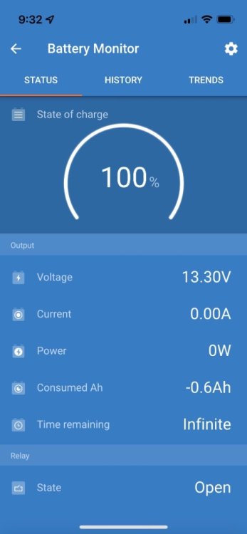

Different battery manufacturers have different storage requirements. If they are disconnected from ALL loads they won’t discharge significantly and they do NOT need a constant trickle charge like a lead acid battery. That is so very primitive…..😬
My Battle Borns get charged to 100% and then disconnected (I installed a master cutoff switch).
https://battlebornbatteries.com/faq-how-to-winterize-your-batteries/
I use my VictronConnect app to check them every now and then, this is the latest screen capture. The batteries have been offline since December.

Reading the article quickly it seems all lithium batteries would rather be stored off charger / disconnect from a load.  Also they mention a mid level charge being left in the battery to protect them from extreme temperatures. Any particular reason you leave them at 100%?  Recommendation from BB?
Yes, “charge to 100% and disconnect”.: read that page…. https://battlebornbatteries.com/faq-how-to-winterize-your-batteries/
Cell equalization (balancing the voltages) in a BB happens as the battery reaches full charge, It is performed by the onboard battery management system (BMS). I do not know details about the other brands. If you never charged a BB past say 95%, it would not equalize the cells. So charging fully is good, but you should NOT keep it cooking at 100% for long periods, for example, plugged into shore power through an entire winter... That is stressful and is needlessly hard on the cells.
