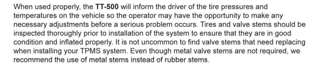

Frank C Posted April 13, 2022 Author Share Posted April 13, 2022 22 minutes ago, topgun2 said: One of the reasons I changed to metal stems. Bill Yeah, that’s the recommended solution posted on the other forums, or going with the internal sensors inside the tire. Either way, a significant bit of cost and downtime to upgrade all 4 wheels. Very mixed feelings at the moment about continuing to use the sensors with the rubber valve stems and risking catastrophic rapid leak(s) if one or more of the valve stems fail, or removing the sensors and going without the TPMS system for now and risking an unmonitored tire leak. TireTraker manual does say metal stems are “recommended” but not required. 3 Link to comment Share on other sites More sharing options...
Frank C Posted April 14, 2022 Author Share Posted April 14, 2022 For anyone with another brand of TPMS other than TireTraker, do the operating instructions have the same “recommendation” for metal valve stems? 1 Link to comment Share on other sites More sharing options...
dhaig Posted April 14, 2022 Share Posted April 14, 2022 I recently installed the TireMinder i10 TPMS system. The instruction manual says the following of page 28: Can Rubber Valve Stems Be Used with The TireMinder Transmitters? Yes, TireMinder Transmitters may be used on high quality, high pressure rubber valve sterns. However, we highly recommend brass or stainless steel valve sterns. Due to the fact that rubber valve sterns deteriorate fairly quickly, e.g. they should be replaced when replacing your tires, an external TPMS sensor can exacerbate the deteriorating by adding weight to the valve stern. Additional rubber valve stems issues are based on age, length and physical location (i.e. exposure to road salt, high heat, sun, etc). If using rubber valve sterns, it is recommended that you check the condition of you rubber valve sterns on a regular basis. Failing to do so will result in a tire failure. 1 2 North Texas | 2022 LEII, Hull #990, delivered 2/17/22 | 2014 BMW X5 35d Link to comment Share on other sites More sharing options...
